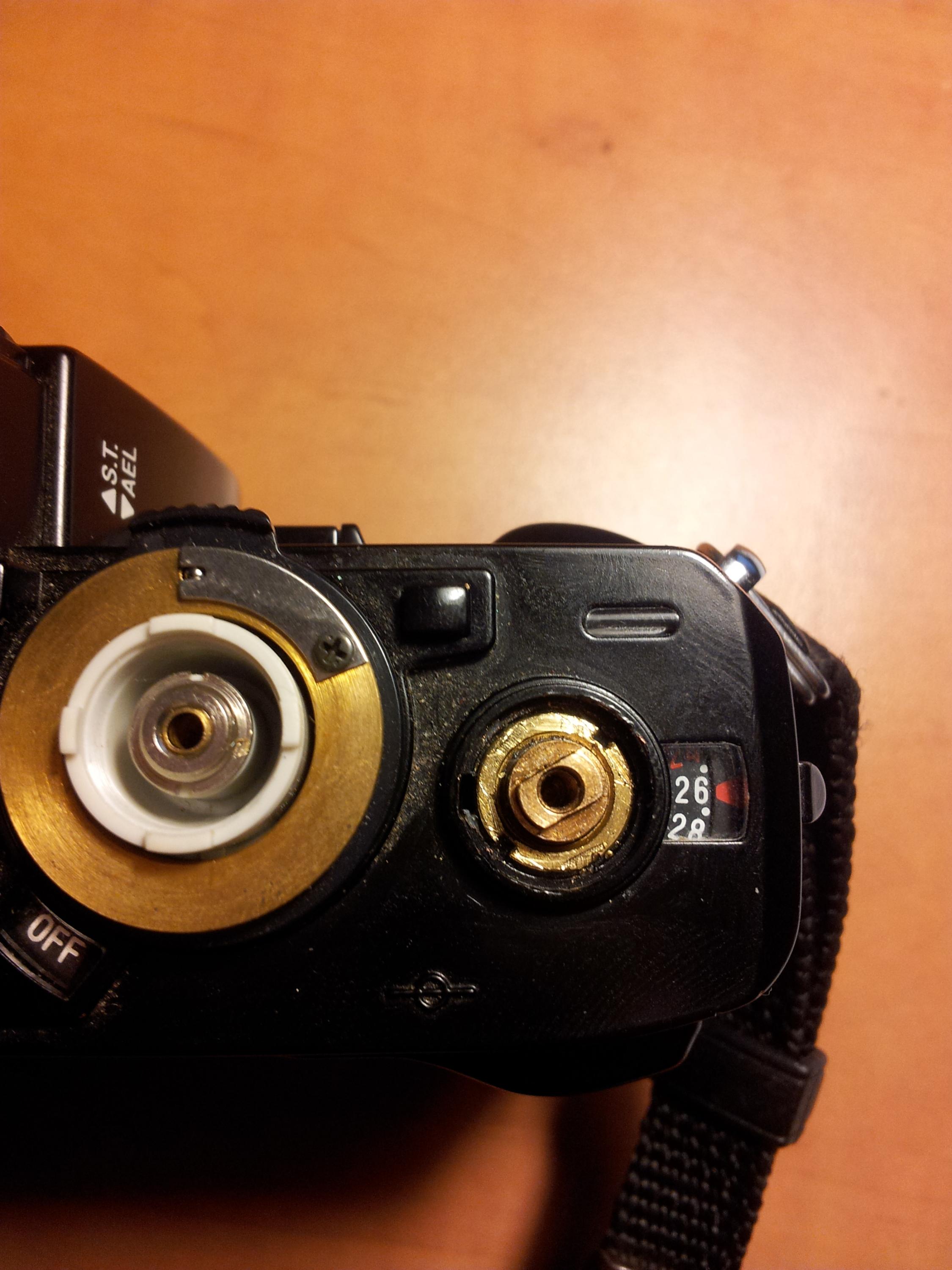

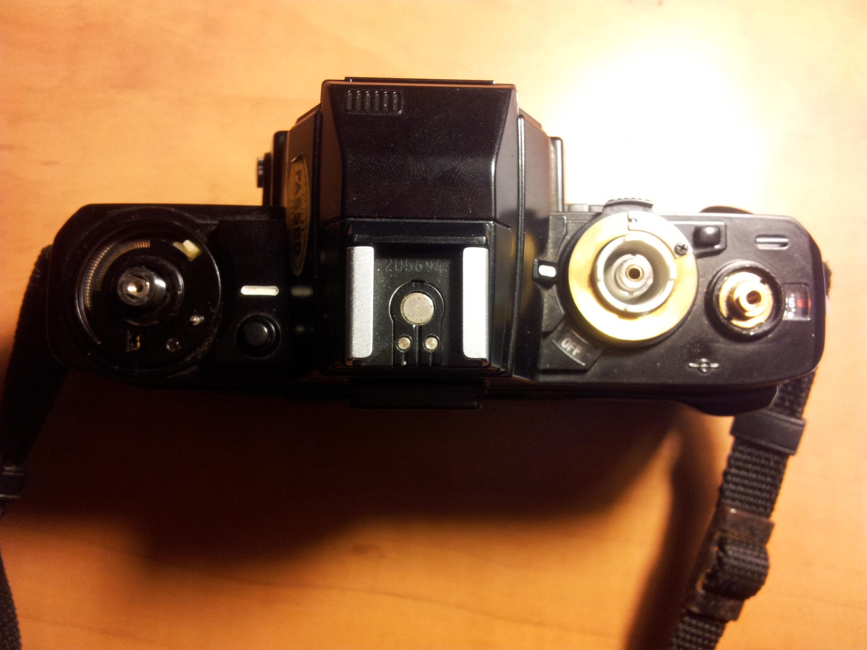

I have a Minolta x-700, I love how simple and portable the camera is. When I'm out and about I often forget about it because of its weight (or lack of weight). I knew about the potential capacitor problem with the camera in question, but I thought I would be an exception - my camera performed as new. Needless to say, I recently started having problems with the camera not firing properly and it seems to be the cursed capacitor problem. I am not afraid of soldering new capacitors in place, I've ordered them already - however, I ran into a little problem while dissembling the camera. To get the top cover off, where one of the capacitors is, you have to take off one of these bolts...
There are a few plastic bolts like this one elsewhere on the camera that I was able to remove simply by placing a flat head screw driver in one of the notches and pushing to the side, however I am not having any luck with this brass one. I am starting to scratch the brass and I don't want to damage the camera.
Any advice on how to remove this? I am thinking of putting a drop of wd-40 on there..
Here is where I am stuck

I use a spanner wrench . If you don't have one I used a motor dremel to cut the tips of needle nose pliers to fit. You may be able to find small needle nose pliers with fine enough jaws that will work. Micro Tools used to carry the spanner wrenches. Remember there are two capacitors that should be replaced. One at the top and one at the bottom of the camera.
I advise strongly against the use of WD-40. Usual symptom of bad caps is when you press the release button, the LEDS go out and nothing else happens.

WD 40= Water Dispersant #40, has a penetrating fluid that evaporates fairly quickly and a light weight oil. When all components dry out in 30 to 60 days a sticky residue is left behind with build up from repeated applications. 3in1 oil is another product that dries out and leaves a sticky residue behind. Neither are good for photographic equipment.
A spanner, as previously stated, is the best tool for the nut. An adjustable lens spanner may get narrow enough and have jaws thin enough to fit the slot or they can be filed to fit the slot. Two jewelers screwdrivers that fit the slots in each slot with a 3rd horizontal between them using the horizontal one as the turning handle may work depending on how tight the nut is. Two pieces of steel cut/filed to fit the slots in the nut with a wrench or screwdriver horizontal as a turning handle hold the steel in the slots and turn. been there, done that several times.
