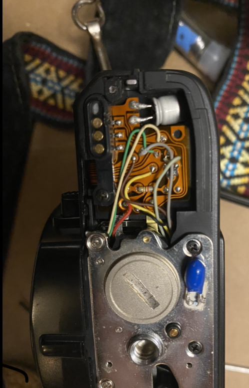

Hello. I turned back on a Minolta x-570 after a few decades and it was working just fine. I was testing it out and the shutter did get stuck closed one time after firing (looking through the camera was black). But I just opened the back and pushed the shutter back into place and it worked again. After about 20 shots later the cameras shutter locked closed again, only this time I had film in the back and couldn’t open it. So I decided to roll back all the film and push the shutter back into place, but whenever I tried taking a picture it would lock the shutter closed again. I looked online and saw that I could just replace the capacitor on the bottom. So I replaced the capacitor and tested the camera again but still no luck. I know on the x-700 there is some capacitors on the top, but I don’t know if the x-570 has the same capacitors. If anyone could provide me with ideas of what to do that would be great.
Symptoms: shutter stays closed after each shutter release; the LEDs in the view finder turn off after clicking the shutter release button; the film advance lever gets stuck when shutter is closed.
Kodo
Dec 29, 2021
4
United States
This is what the replacement capacitor looks like. I am sure the polarity is correct.
Shutters are supposed to close after firing. That's why they're called shutters.
If the view through the camera on an SLR is black after exposure, that's due to the mirror not returning after exposure, not the shutter being "stuck closed."
neilt3
Nov 23, 2014
1,019
United Kingd
But I just opened the back and pushed the shutter back into place and it worked again. After about 20 shots later the cameras shutter locked closed again, only this time I had film in the back and couldn’t open it. .
Just a suggestion , but don't poke shutters with your finger .
Doesn't do them any good .
Also I feel like sending it out will end up costing more than just buying a new one.
Where will you buy a new one ?
They stopped making them about 25 years ago !
Even if you buy a NIB one , it's still 25 to 35 years old .
Lack of use won't save the capacitor in it , it's a common fault in the X500/570 and X700 cameras .
Spend the money and have it serviced proper and you will get back a camera that's as good as new , and will give you many years of reliable service .
Replace it with another used one and that might pack in in a few weeks , cheaper in the long run to just get it fixed proper .
Never poke a finger at a shutter, especially focal plane shutters because doing so can irreparable destroy a shutter.
neilt3
Nov 23, 2014
1,019
United Kingd
I'm surprised no one had picked up on that in the OP .
Normally when the capacitor goes it prevents the shutter firing at all . Not just allowing the first shutter curtain to fire but not the second.
It most probably just needed a good service due to old dried up lubricants , but poking it with a finger could have caused more damage .
