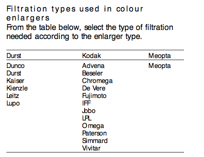

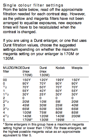

Chip, Here is the Information that best applies to your needs. It's from the PDF I posted a link to...
CONTRAST CONTROL
Page 3 of 4
USE OF COLOUR HEADS
By adjusting the yellow and magenta filtration on colour heads, it is possible to obtain a wide contrast range with MULTIGRADE papers.
However, the maximum contrast will be slightly lower as the filters used in colour heads are optimised for use with colour paper and not with
variable contrast paper. The suggested filtration in the following tables can only be a guide, because individual enlargers vary. The actual filtration for a
particular enlarger must be determined by trial.
Filtration types used in colour enlargers
