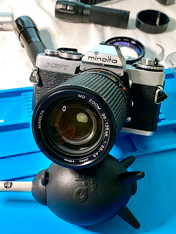

This Minolta zoom is a recurring patient.
Its rear lens had already become cloudy and the aperture transmission often got stuck when the tube was pulled out.
Here is my report on the service from December 2023 describing how I cleaned the lens:

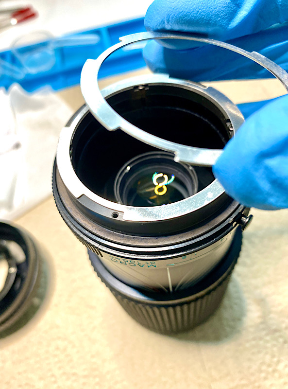

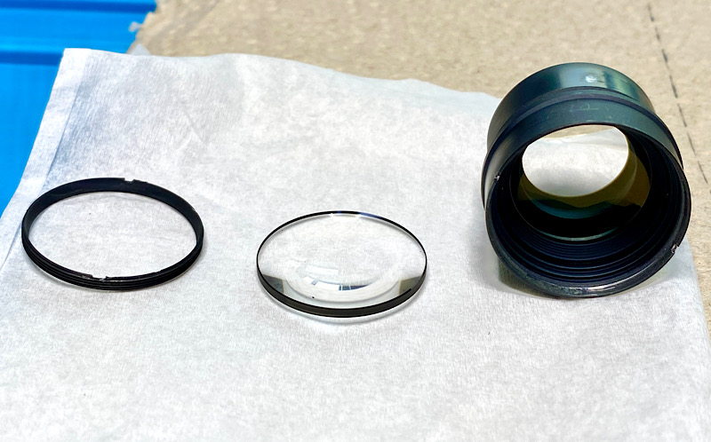

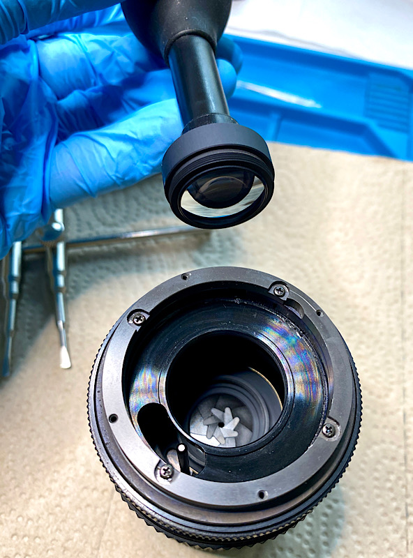

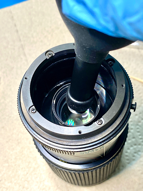

Removing the bayonet ring and dismantling the optical unit which contains the rear lens.

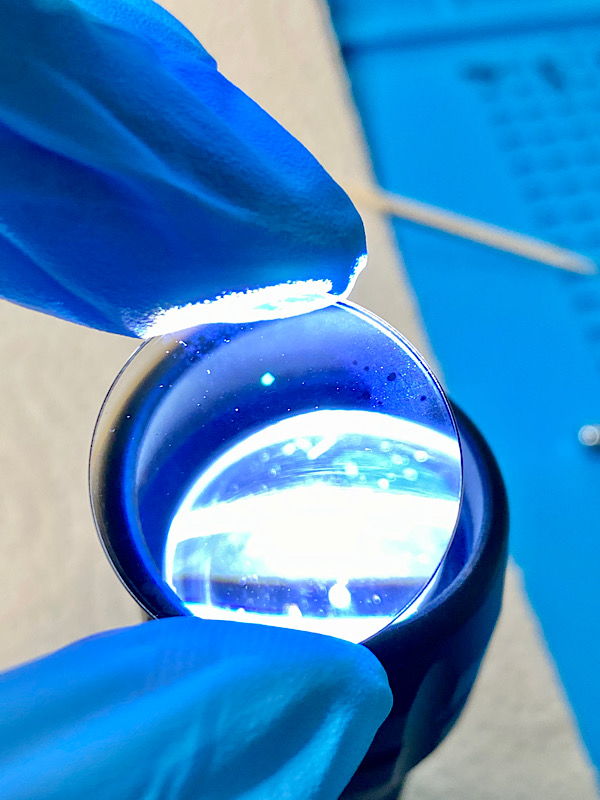

Heavy fog has formed again on the inside of the rear lens. I suspect it is caused by the lubrication of the helicoids turning into oil.

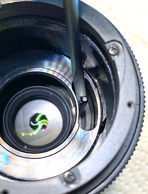

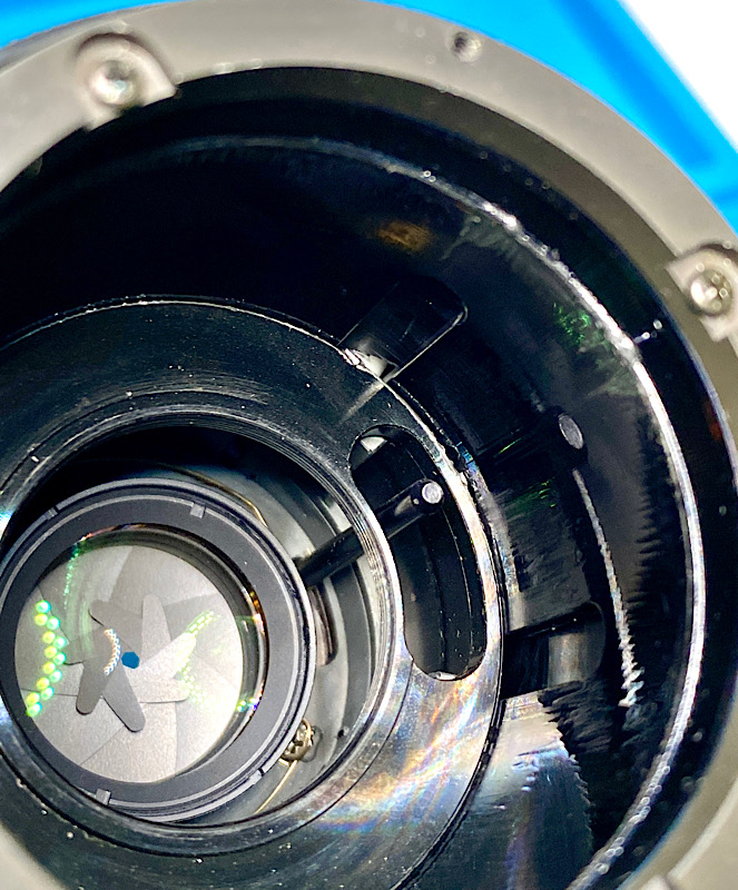

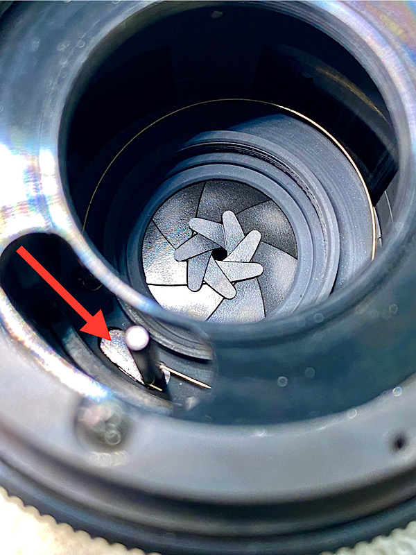

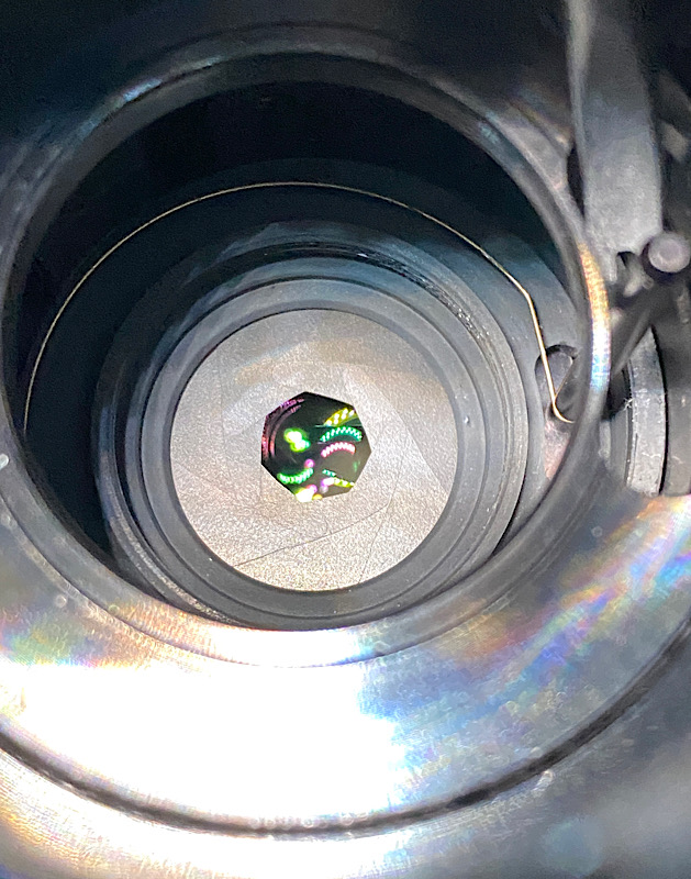

The lever that moves the aperture blades in the aperture register. It jerks and does not move smoothly. Although the aperture blades are dry, I suspect that it is a problem with oil contamination.

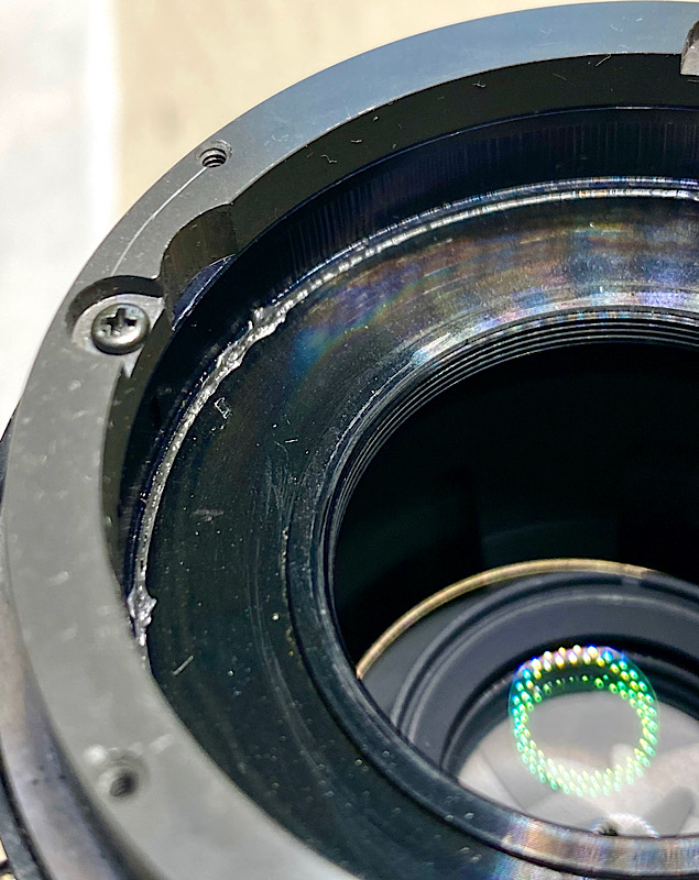

Oil and old grease can be seen everywhere in the tube where it doesn't belong.

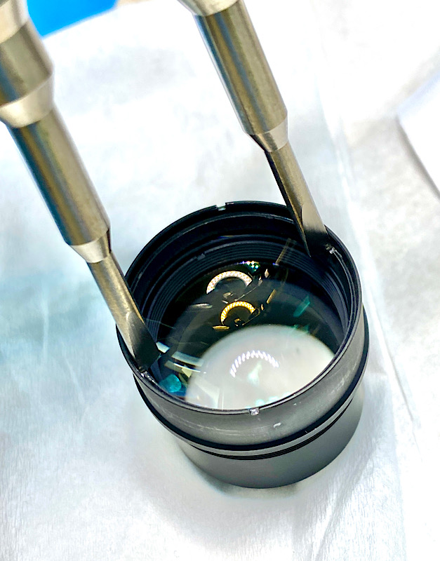

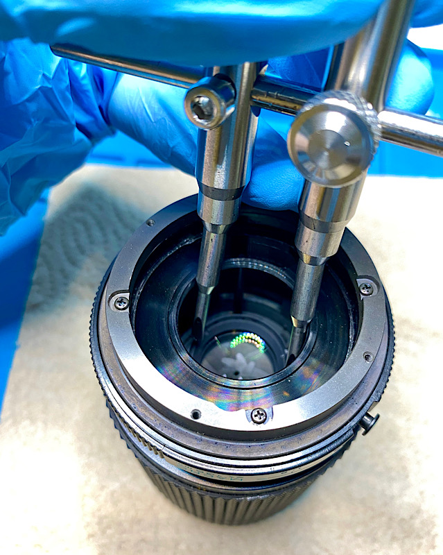

Remove the rear second optical unit above the aperture.
First loosen it with the spanner wrench and then unscrew it securely with the plastic Spudger from iFixit.

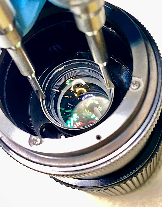

Using the lens suction tool, I lift the optical unit out of the tube.

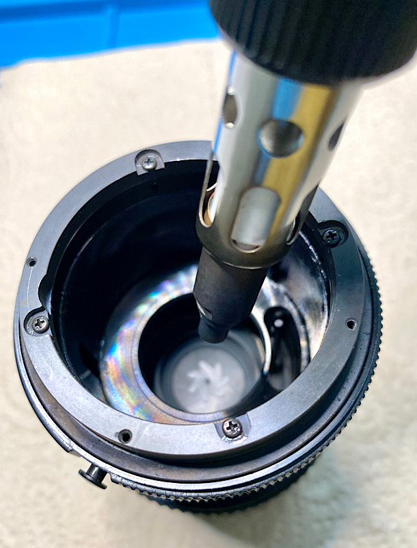

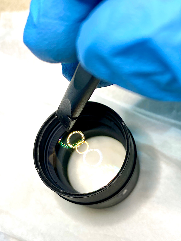

Here I put a few drops of Zippo lighter fluid, which spread instantly over the aperture blades.
After moving the aperture over the lever for some time and dabbing off the Zippo, I carefully dried the aperture blades with the Dremel Versatip butane gas burner.
I opened the aperture at intervals to use the Versatip to remove the Zippo condensate caused by the heat from the lens underneath.
Then I cleaned the lens.

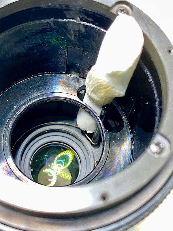

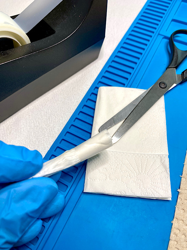

To keep the aperture open against spring pressure, I made a gag out of a piece of rolled-up paper tissue, which I secured with adhesive tape.

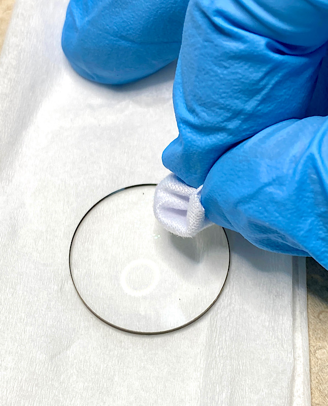

Preparing small pieces from a Zeiss optics cleaning cloth.
I use a glass rod to apply some isopropyl alcohol to a piece of cloth. This allows me to measure the amount.

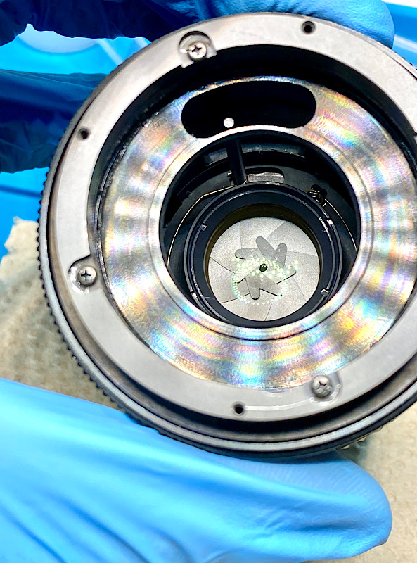

The lens is now clean and the aperture closes without any problems.

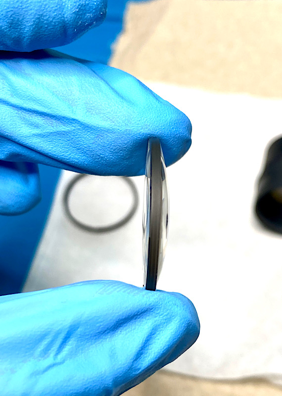

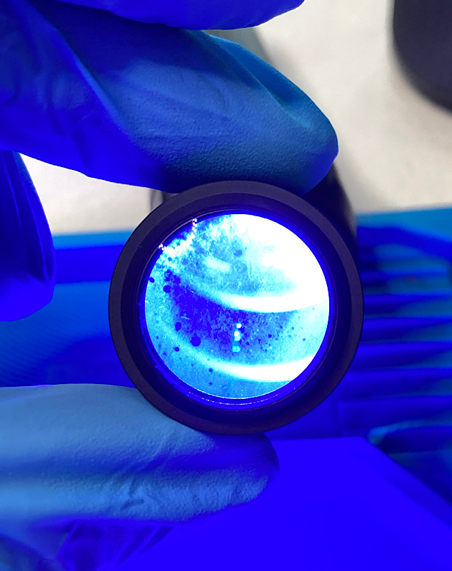

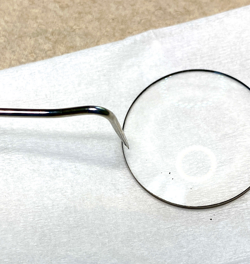

Removing the rear lens.
The convex side on which the fog sits points towards the front lens.

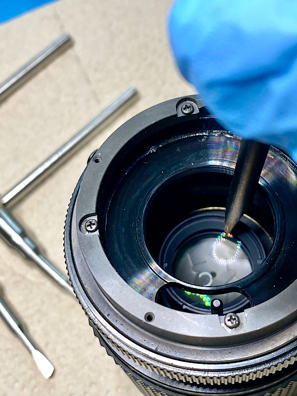

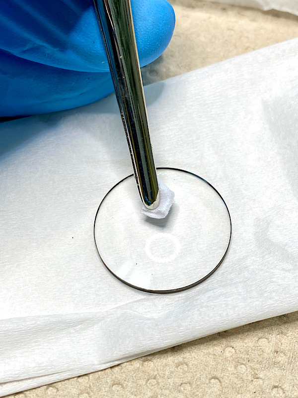

Ever since I scratched one of the (soft!) front lenses of a Minolta telephoto lens while cleaning it, I use the pointed probe to check whether the surface is scratch-resistant.
Cleaning again with isopropyl alcohol.
There remains a slight cloudiness at the edge, which probably comes from lens separation. There is nothing that can be done about this.

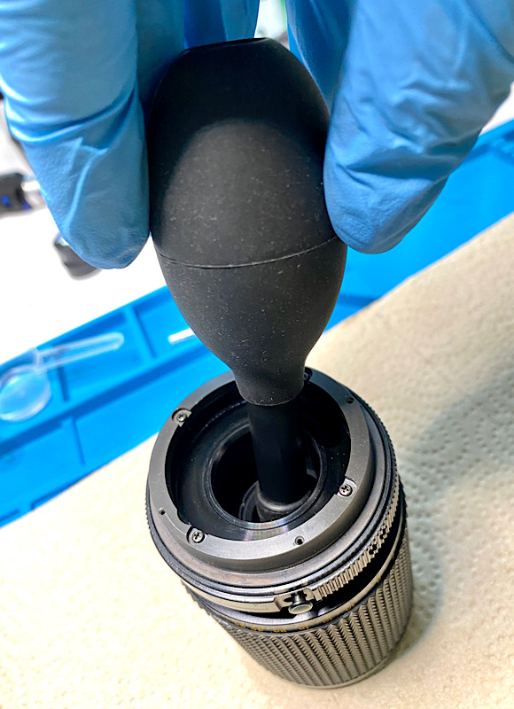

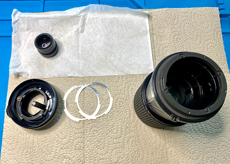

Assembling and installing the rear optical unit with the cleaned lens.
With the lens suction tool, the optical unit can not only be inserted but also screwed in.
Two spacer rings have their place under the lens bayonet.
The zoom is ready for use again. But I will probably have to service it again after a while because the oil remains in the tube.
