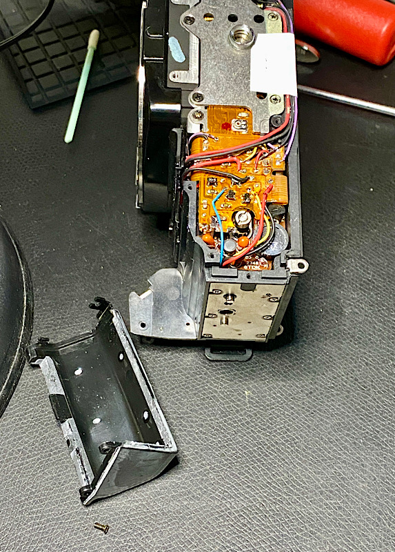

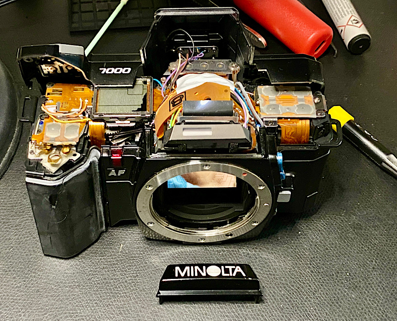

The candidate.

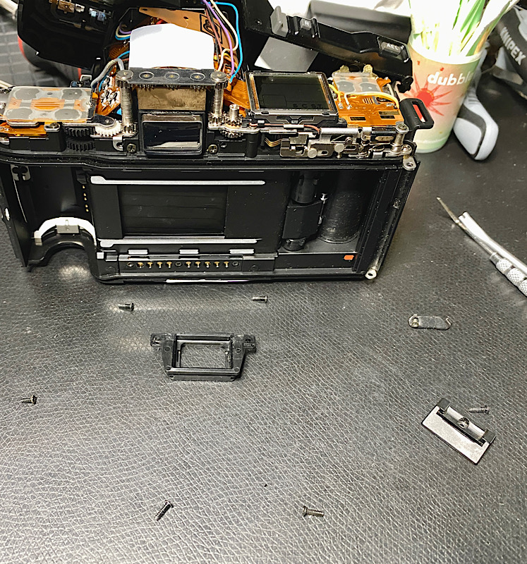

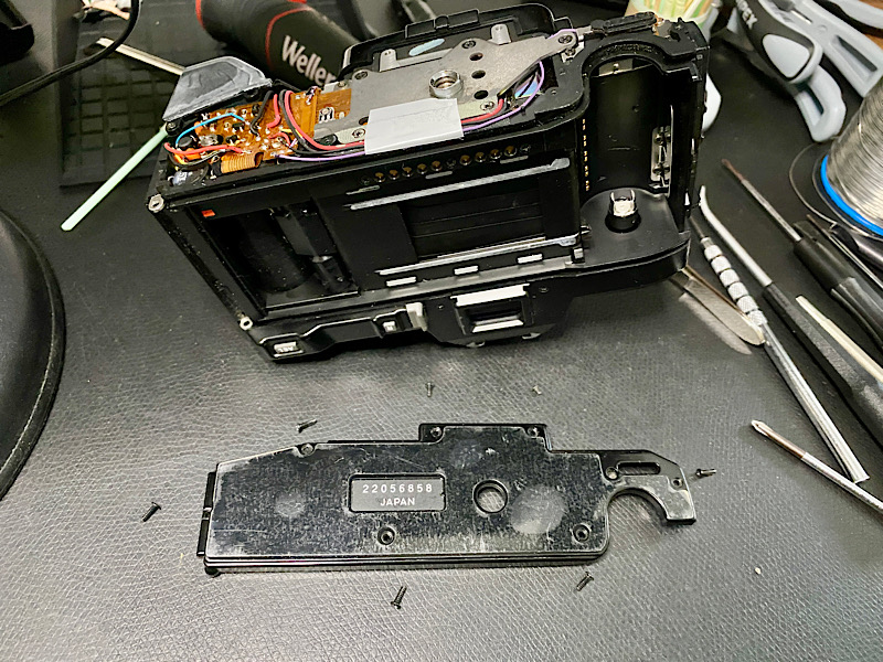

Remove bottom cover, 7 screws.
The screws are different lengths, this picture is not a reference (see start of this posting, „Notes“, point 3), so please pay attention when loosening them.

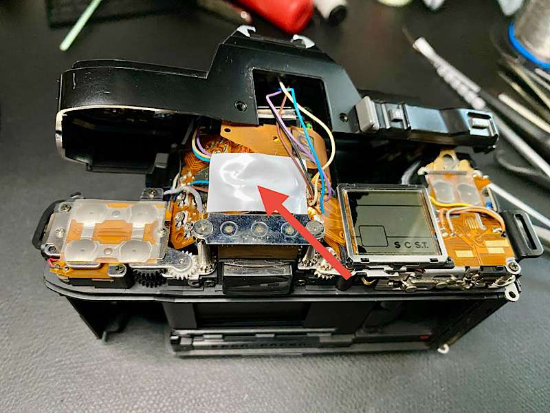

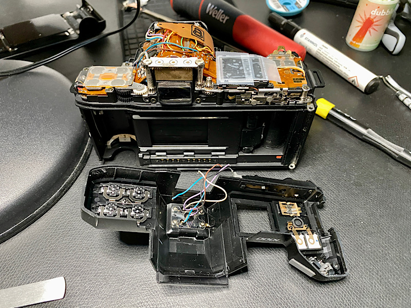

Top cover, 7 screws.
Handle inside, latch with screw.

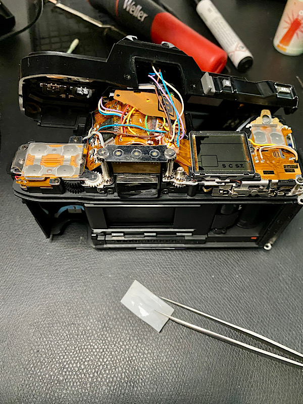

5 cables to the hot shoe connect the top cover with the housing, desolder (brown, black, white, blue, purple).
Before desoldering, cover the LCD with tape to protect it.

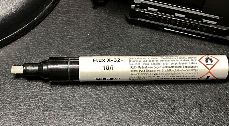

With flux, desoldering is quick and the solder joints retain their shape.
Done

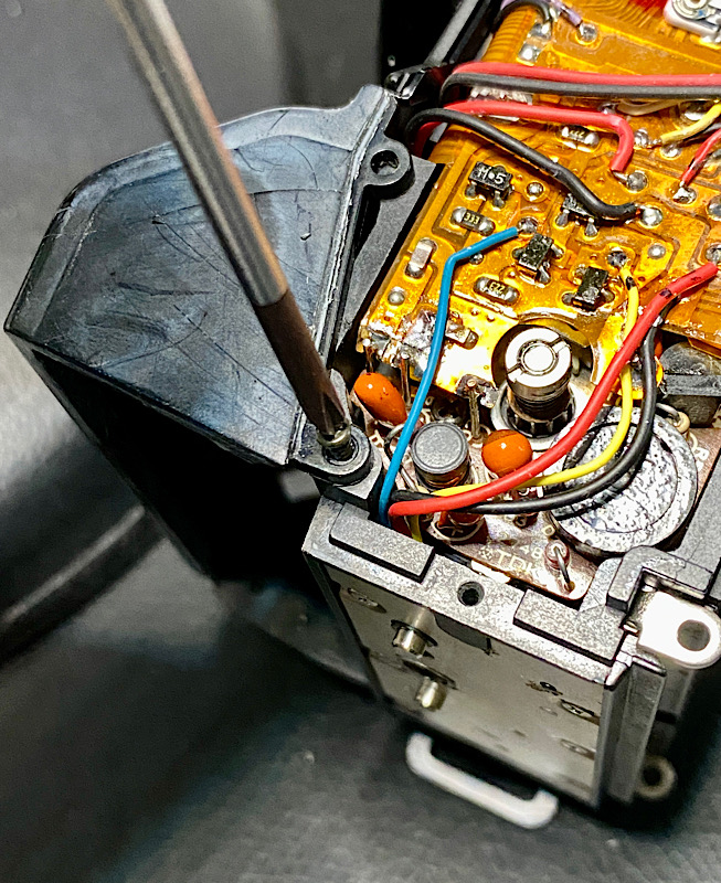

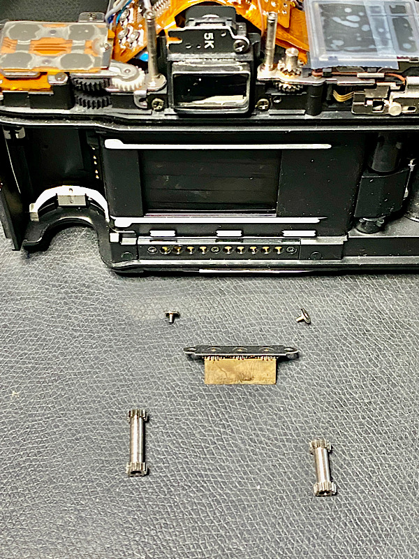

Removing the handle, 1 screw.

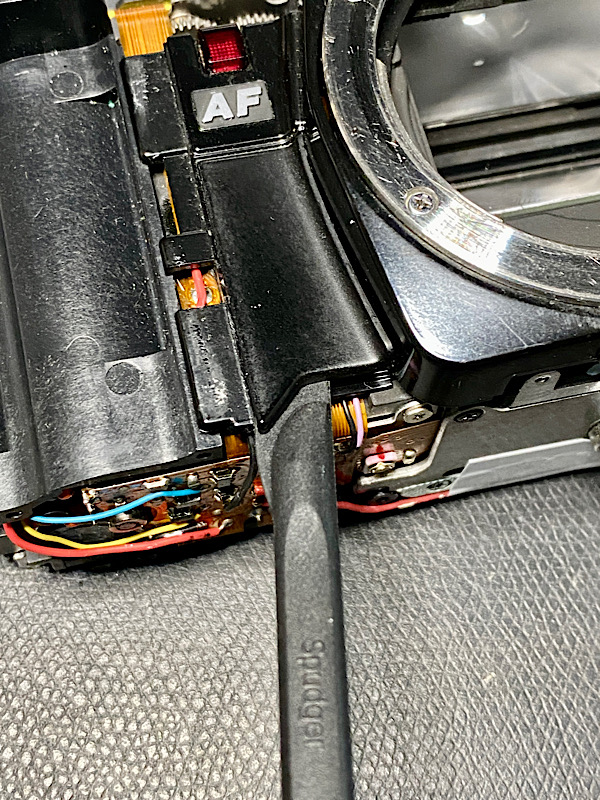

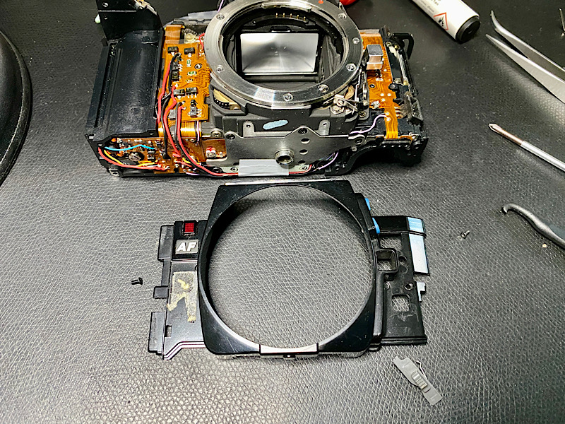

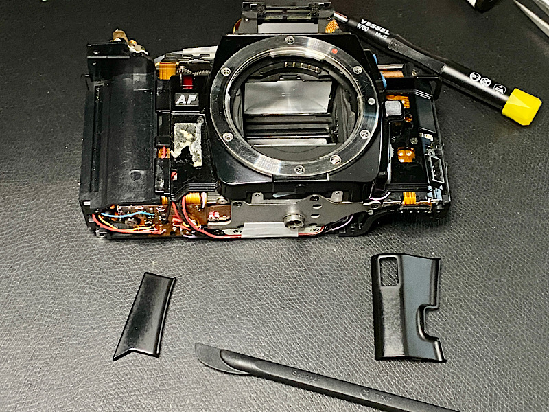

The two covers on the front panel are attached with double-sided adhesive tape and can be carefully pried off.
When you remove the front panel, the selector switch is set to AF.

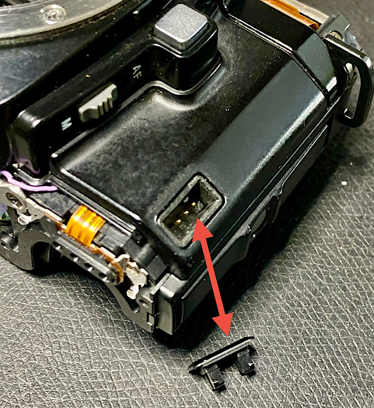

Front panel, 2 screws.
This is how the selector switch is installed.

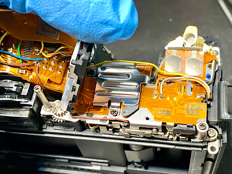

LCD holder, 2 screws.

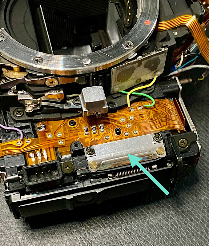

Connector with rubber pad, 3 screws.
The connector fixes these two flexible circuit board parts, which are aligned with pins.

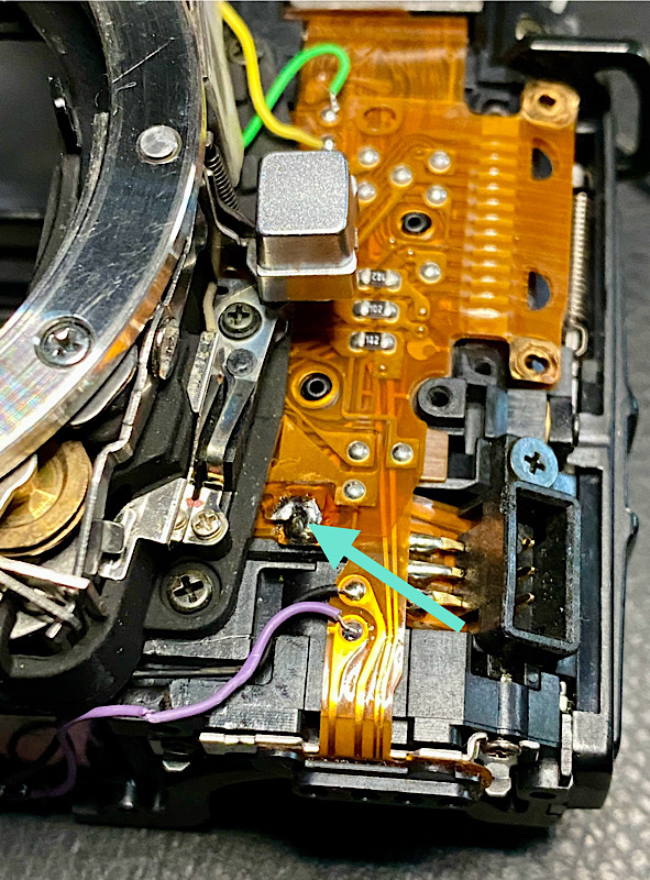

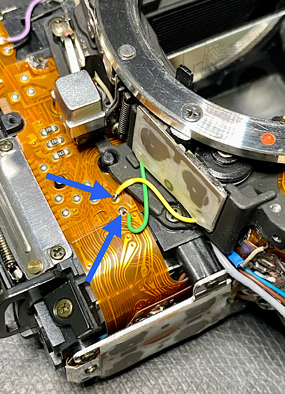

Desolder 2 cables (yellow, green).

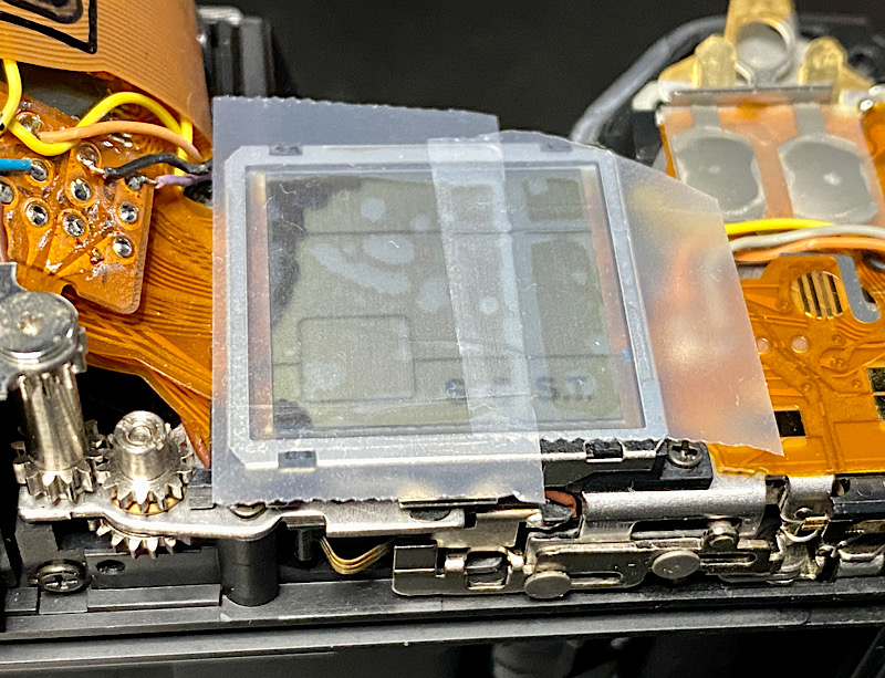

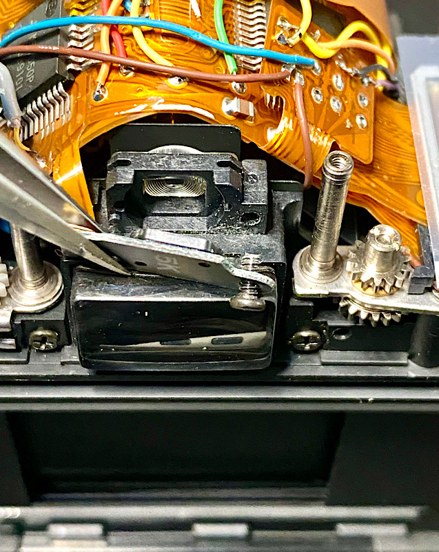

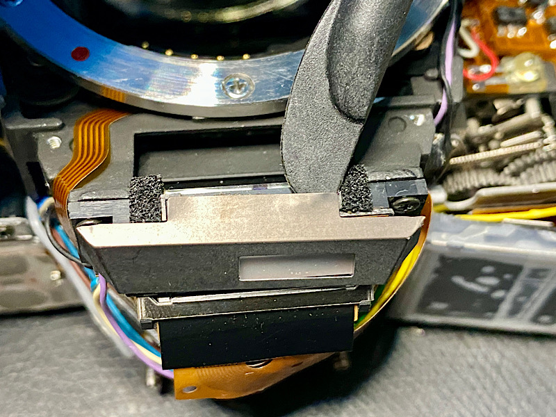

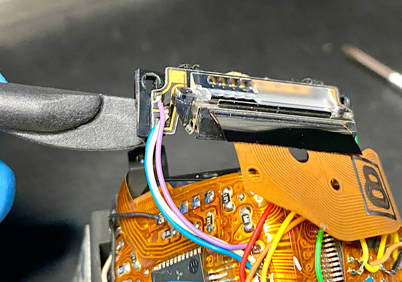

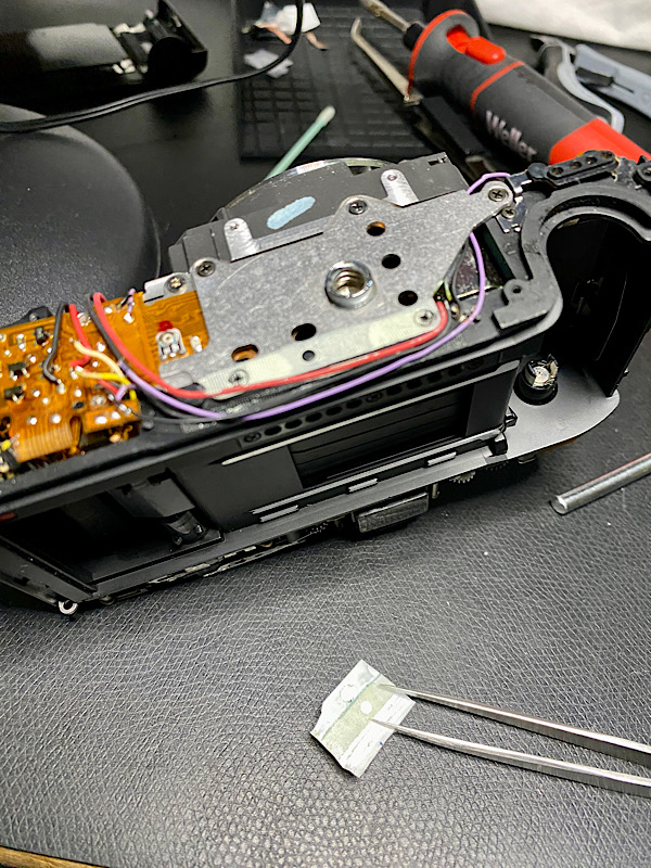

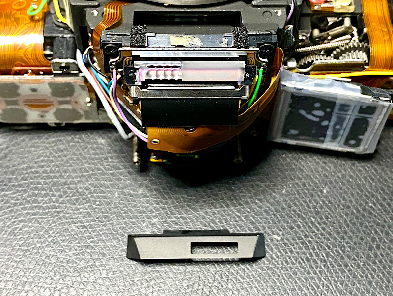

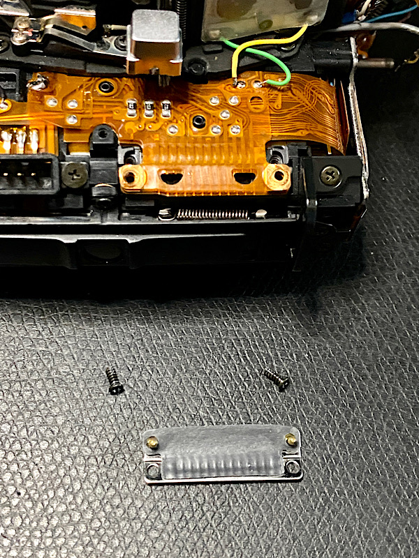

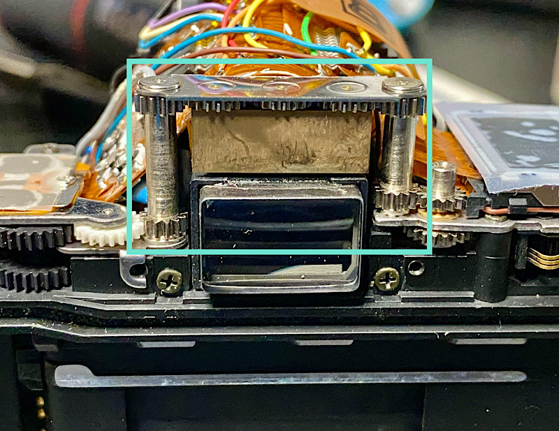

The cover plate above the LCD unit of the viewfinder is fixed with double-sided adhesive tape and can be levered off. Be careful, it bends easily.
Andreas Thaler
Andreas Thaler
Nov 19, 2017
4,863
Vienna/Austria

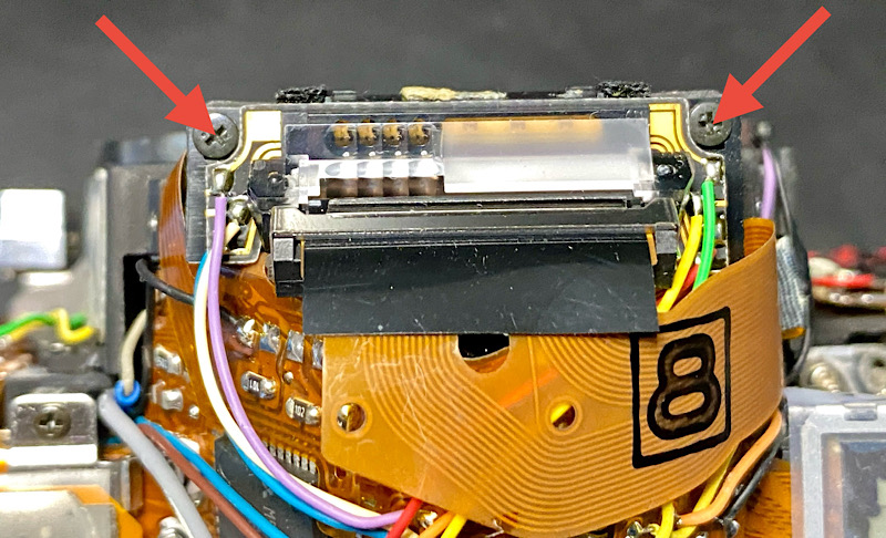

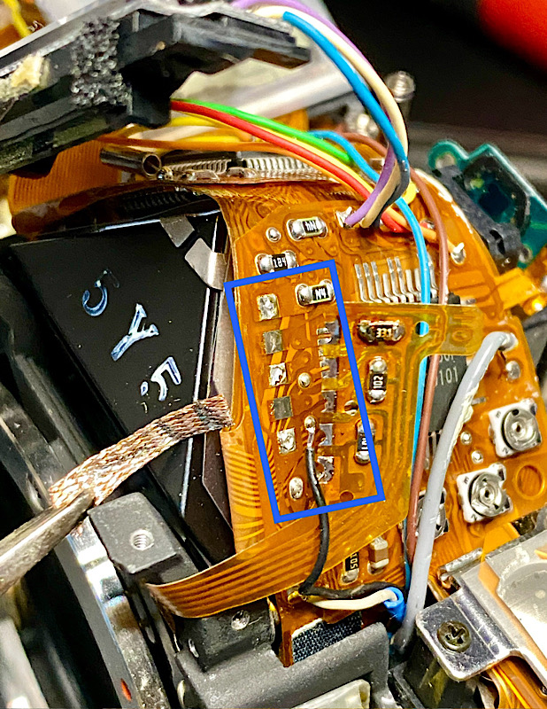

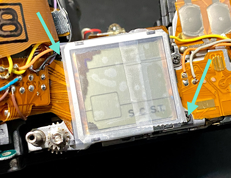

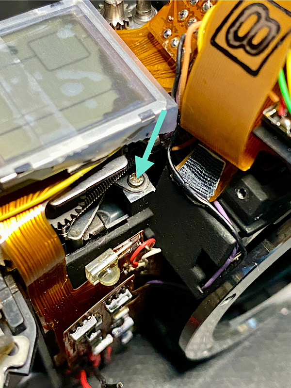

LCD unit of the viewfinder, 2 screws.

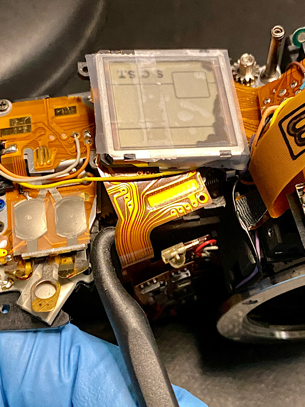

For the next step, I moved the LCD a little to the side and fixed it with adhesive strips to make room for the desoldering work.

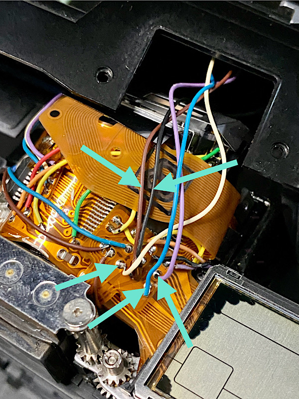

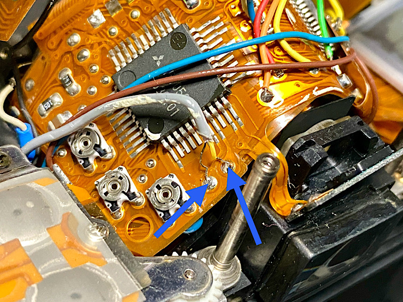

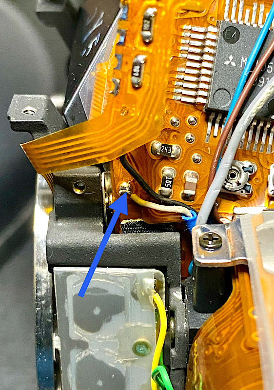

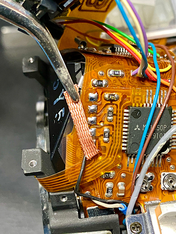

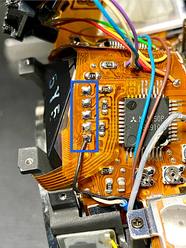

Two flexible circuit board parts are soldered here including 1 cable (black).

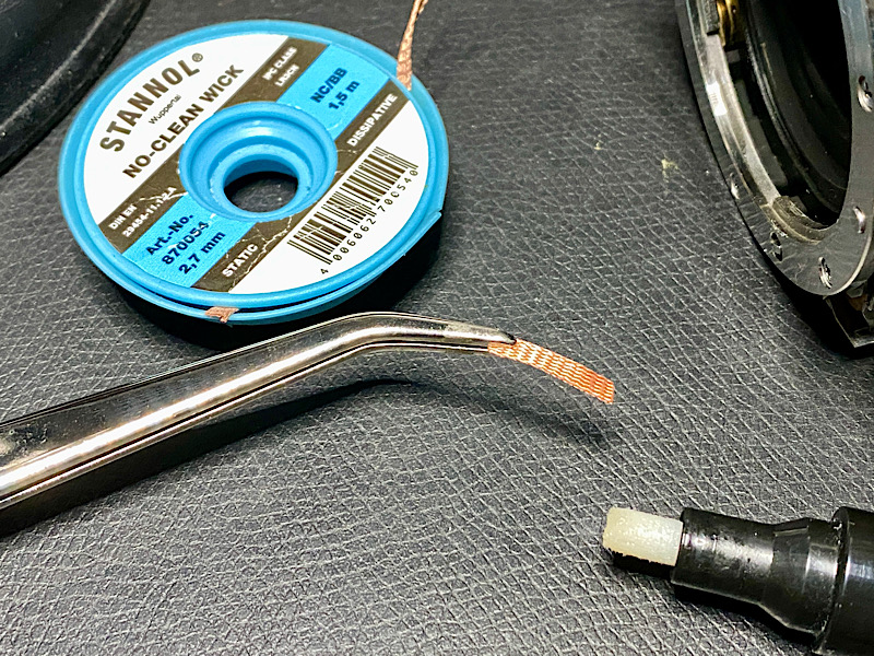

Desoldering with desoldering braid. Apply flux on the braid and the soldering points.
Done, the two board parts and the black cable are separated.

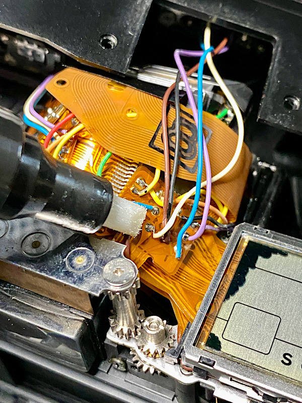

Desolder 1 cable (light grey; the blue piece of shrink tubing I used for another project and is not an original Minolta one).
Desolder 1 cable with two wires (grey).

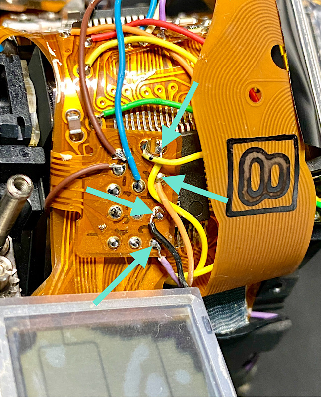

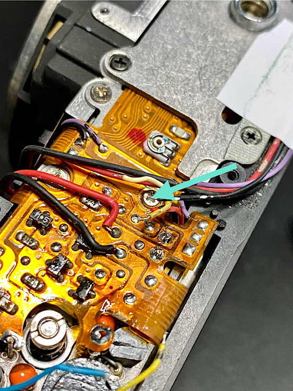

Desolder 4 cables (yellow, orange, black, purple).
Attention, there is a second yellow cable that remains soldered.

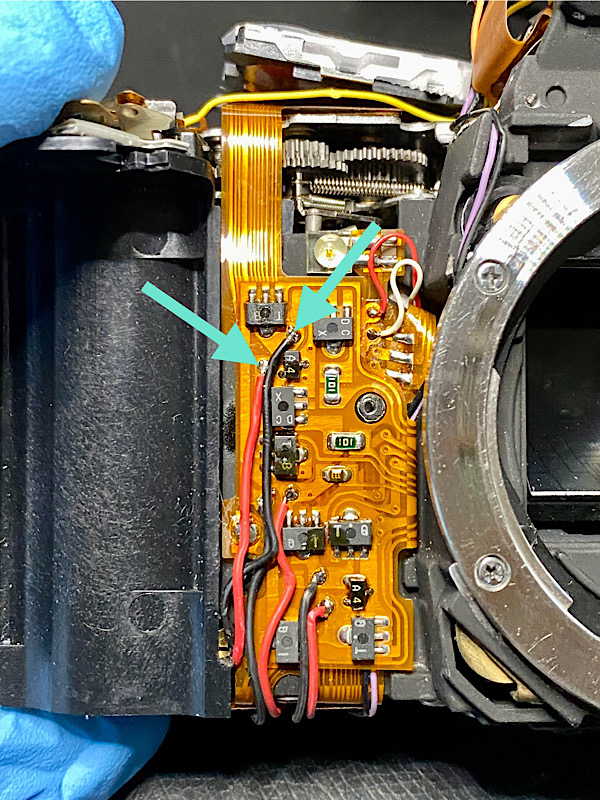

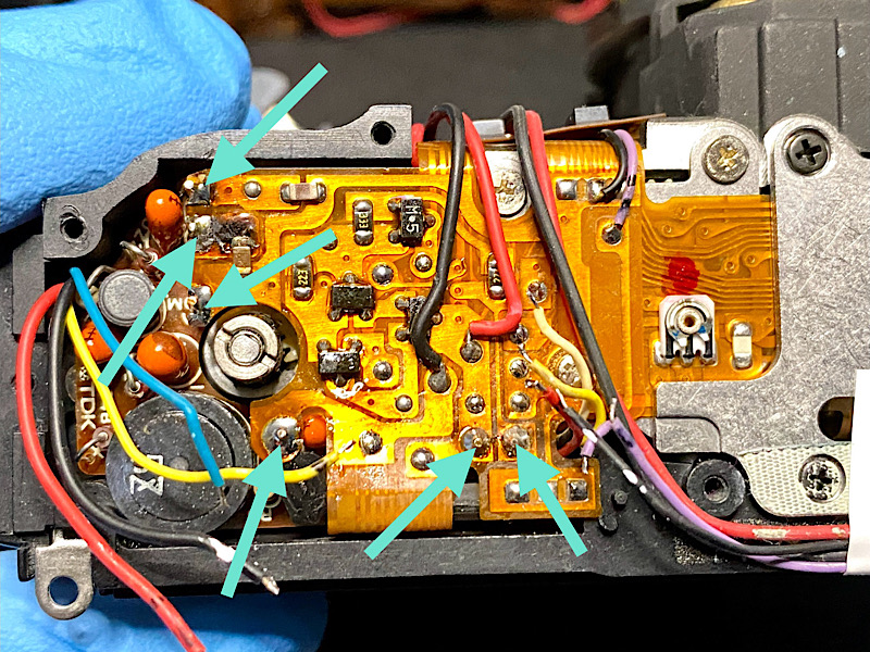

Desolder 2 cables (red, black).

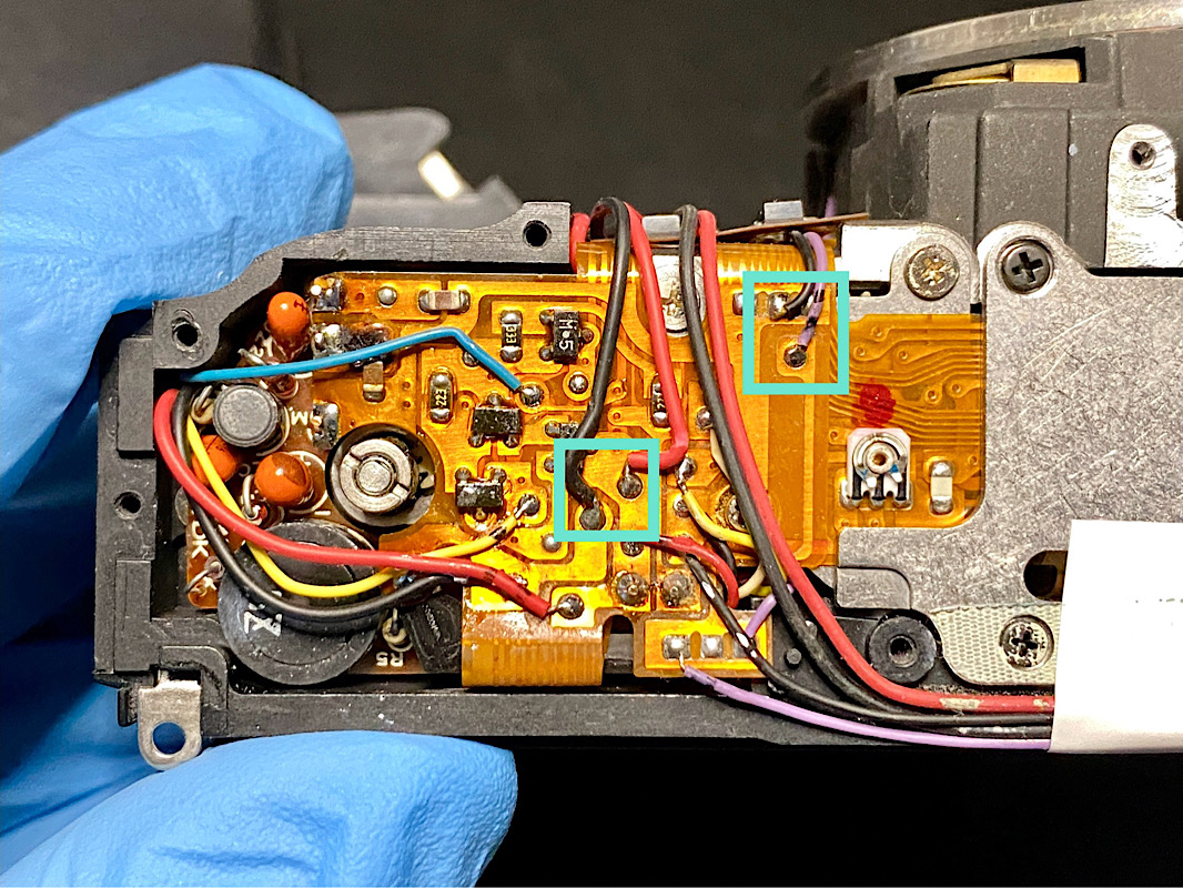

Desolder all cables except those in the 2 markings and except both the thick black and red one accross.

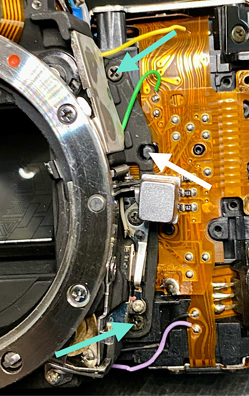

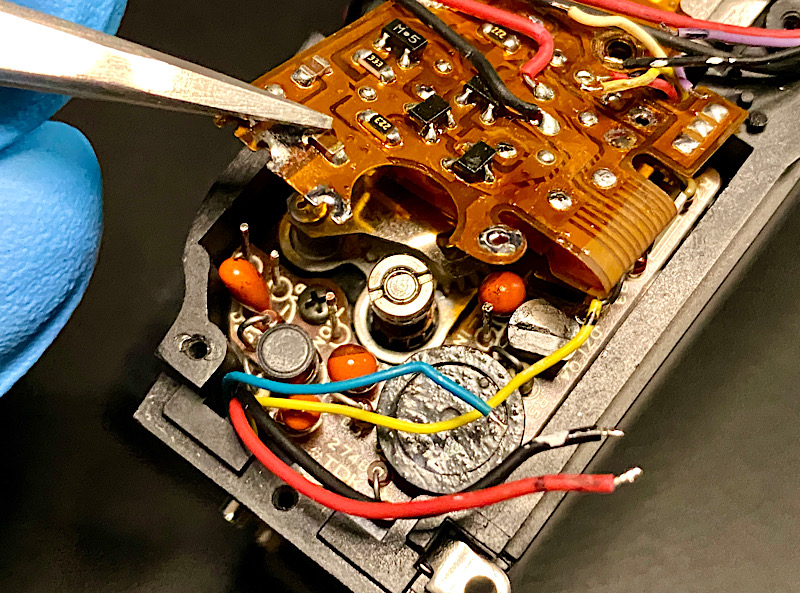

Desoldering the 6 holding points for circuit board part on the case.
Andreas Thaler
Andreas Thaler
Nov 19, 2017
4,863
Vienna/Austria

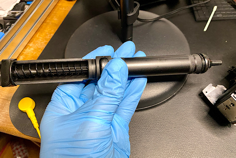

For this I use a desoldering suction pump.
Loosen 1 screw.
The circuit board is now separated from the housing.

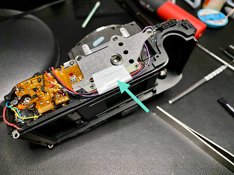

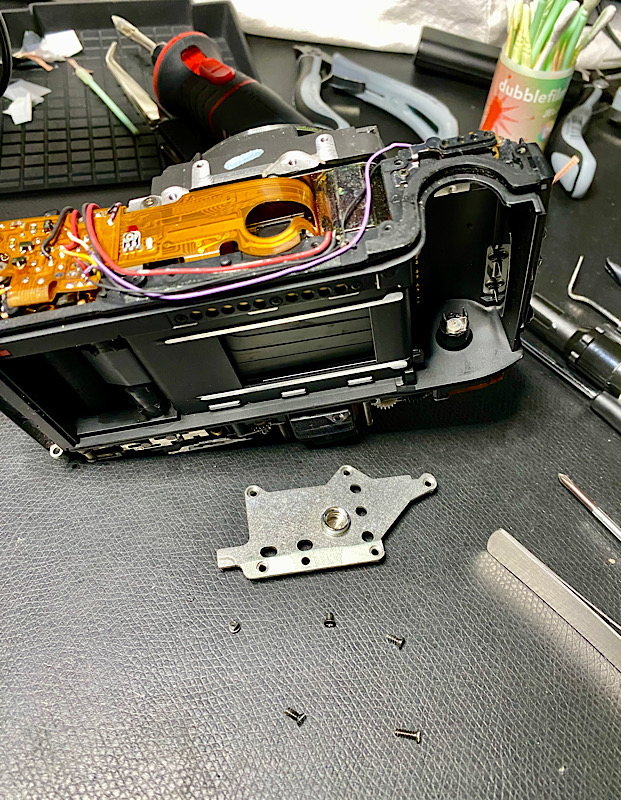

Tripod plate, 5 screws.
Connector, 2 screws.

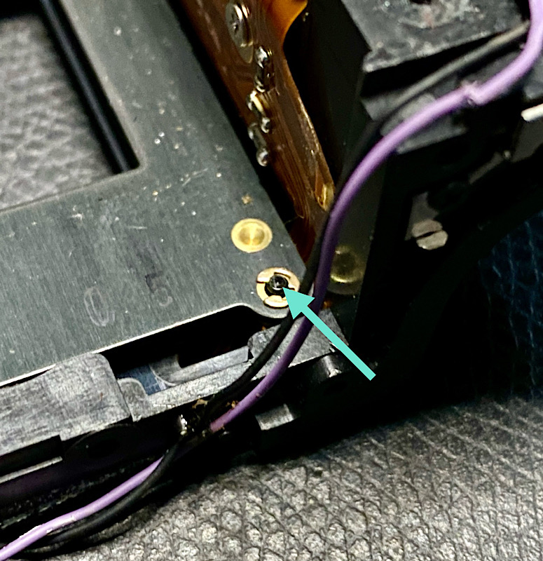

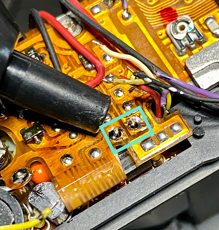

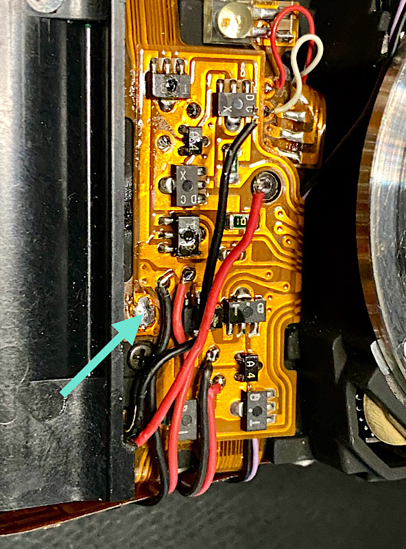

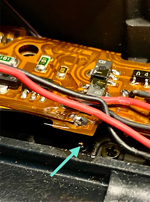

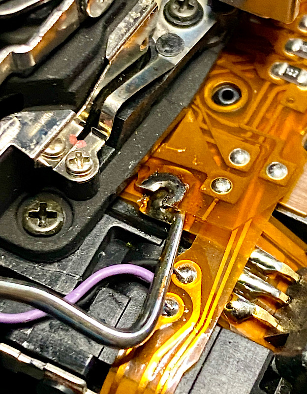

Desoldering this fixing point that holds the board to the housing.
Desoldering this fixing point that holds to parts of the flexible board.
Only the upper board needs to be desoldered, the lower one stays where it is

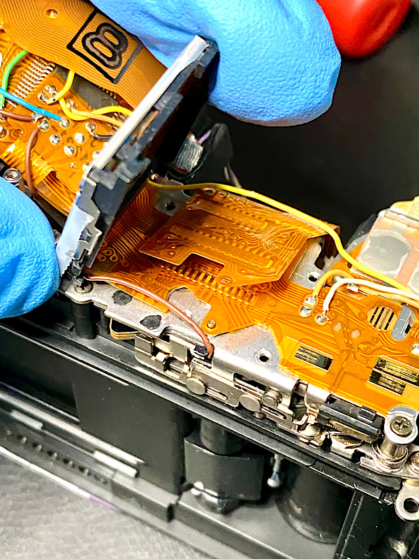

Loosen two screws.

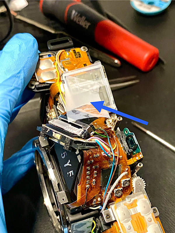

Carefully pull this part of the flexible board out from under the LCD.

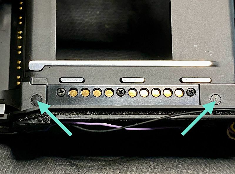

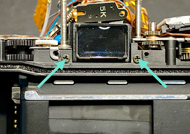

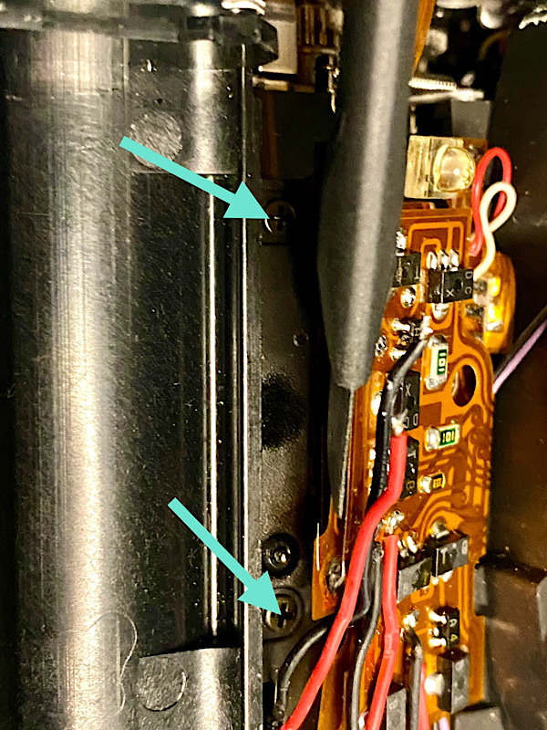

2 fastening screws for the mirror box on the left …
… and 2 fastening screws on the right.

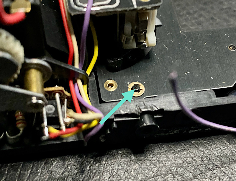

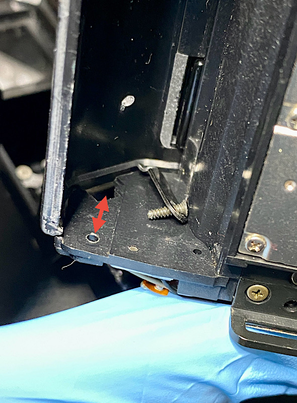

The white arrow points to a plastic fixing pin that breaks easily, so be careful when pulling out the mirror box.

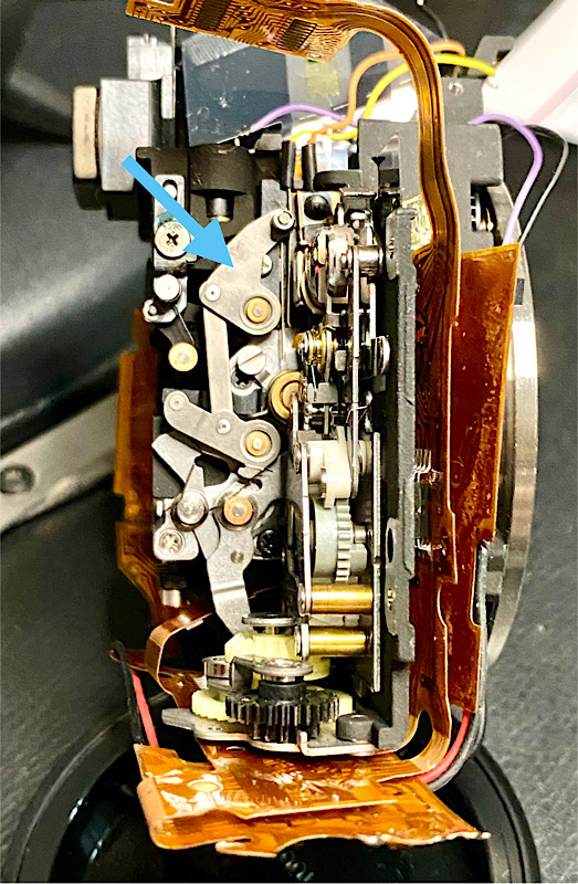

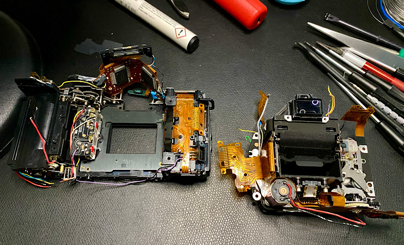

Now the mirror box can be separated from the rear part of the housing. Be careful of cables that may still need to be led out.
Once all connection points have been completely loosened, the mirror box can be pulled out without resistance.
Congratulations, that was some work! 🙃

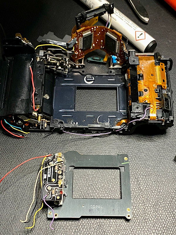

Removing the shutter unit from the rear part of the housing
-> See start of this posting, „Notes“, point 5.

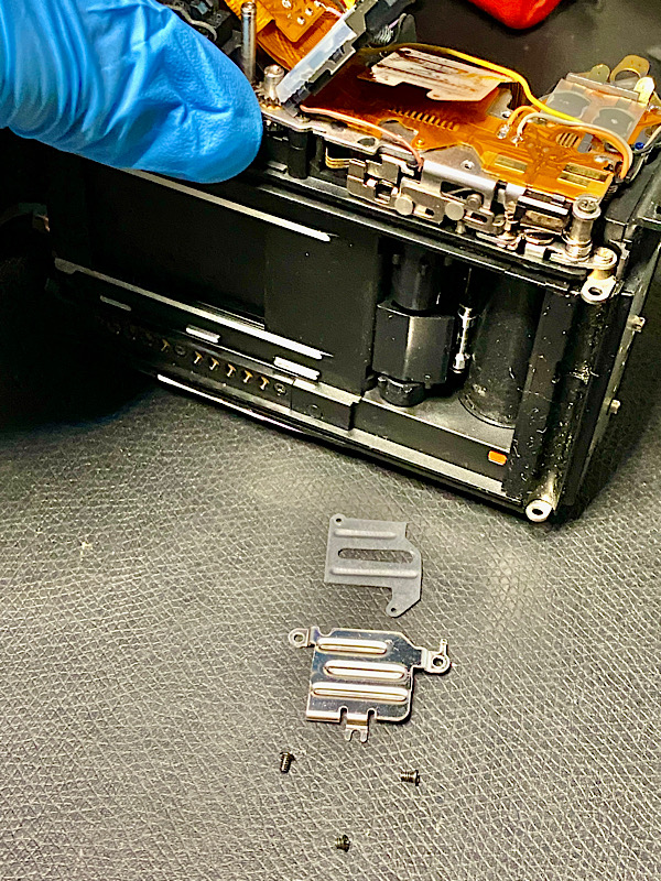

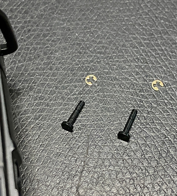

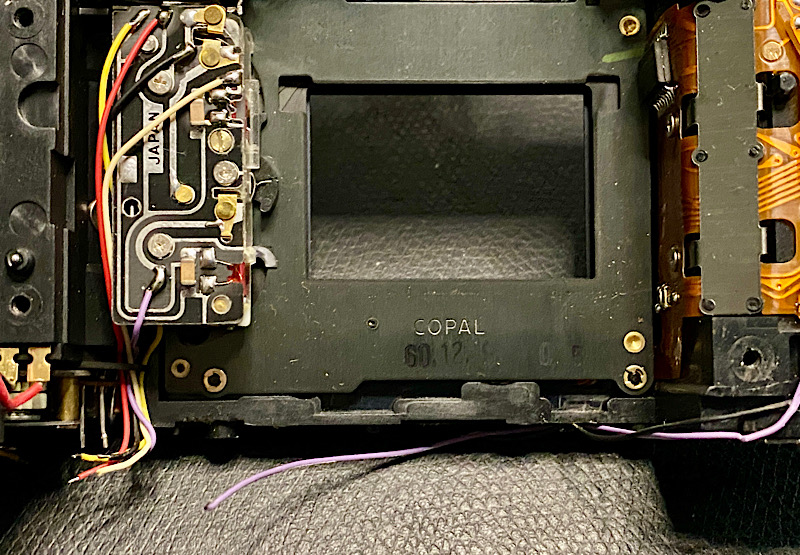

The shutter is fixed to the rear housing part at two points.
Bottom left and …
… bottom right.
Here are the pins on the back of the rear part of the housing that are used to attach the shutter unit.
Be careful that the two circlips do not fly away when removing them.

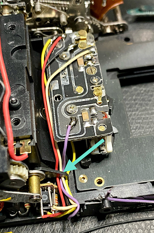

All shutter control connections converge here.
The cables remain on the shutter control, are unthreaded and now the shutter unit can be carefully pulled out downwards.

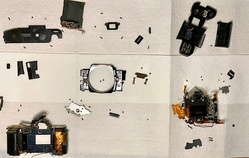

All removed parts at a glance.

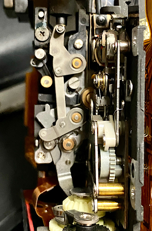

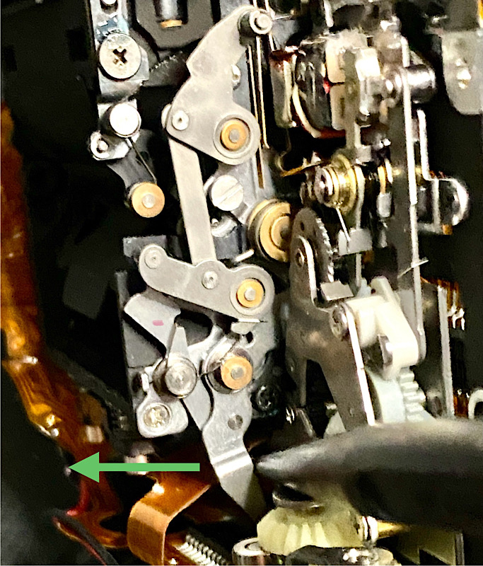

Before assembling the mirror box and housing, the charge lever must be positioned on the mirror box.
From this position …
… by moving the lever in the direction of the arrow …
… to this position.

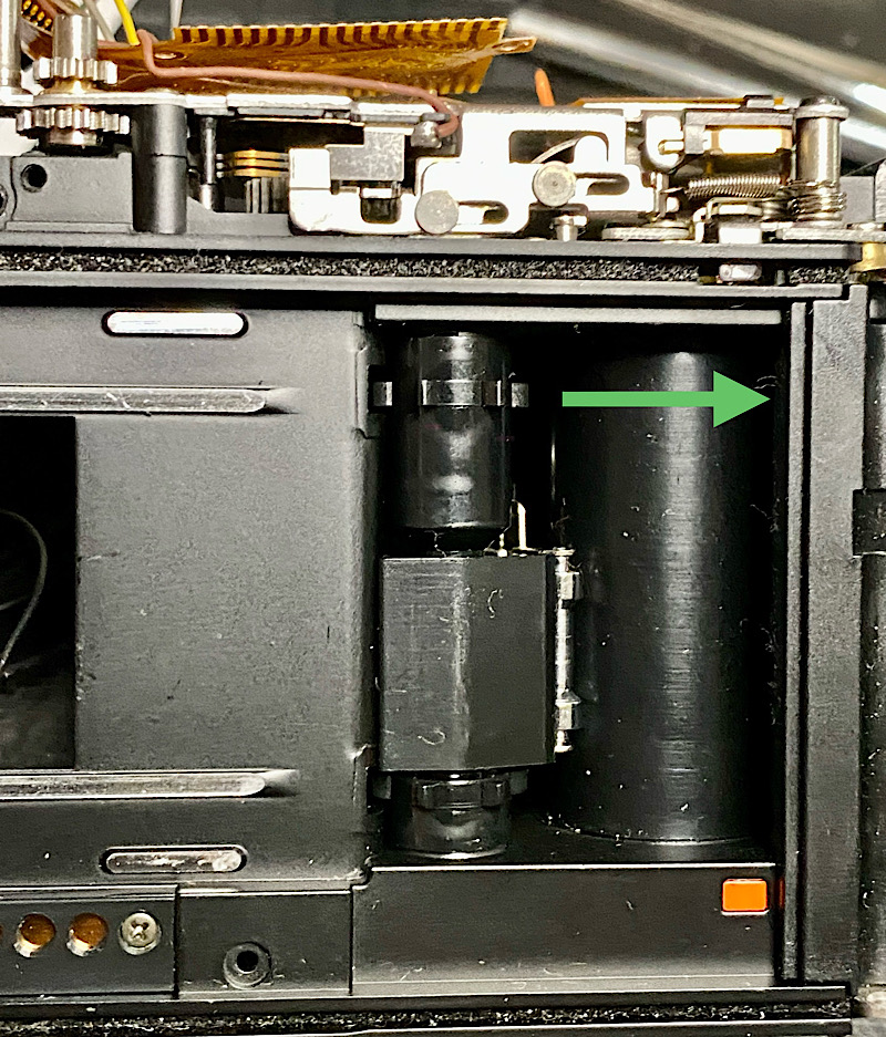

On body side complete winding of sprocket and take-up drum. Lock take-up drum, turning it in winding direction.
-> See page 108 (PDF) in the service manual.
