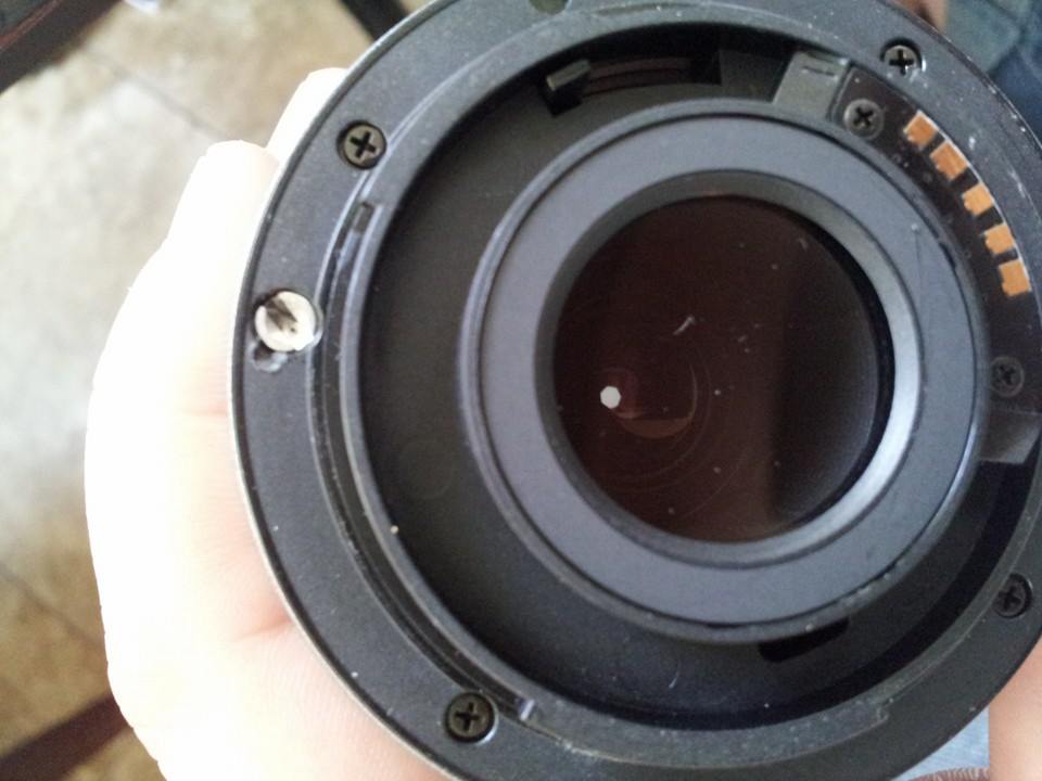

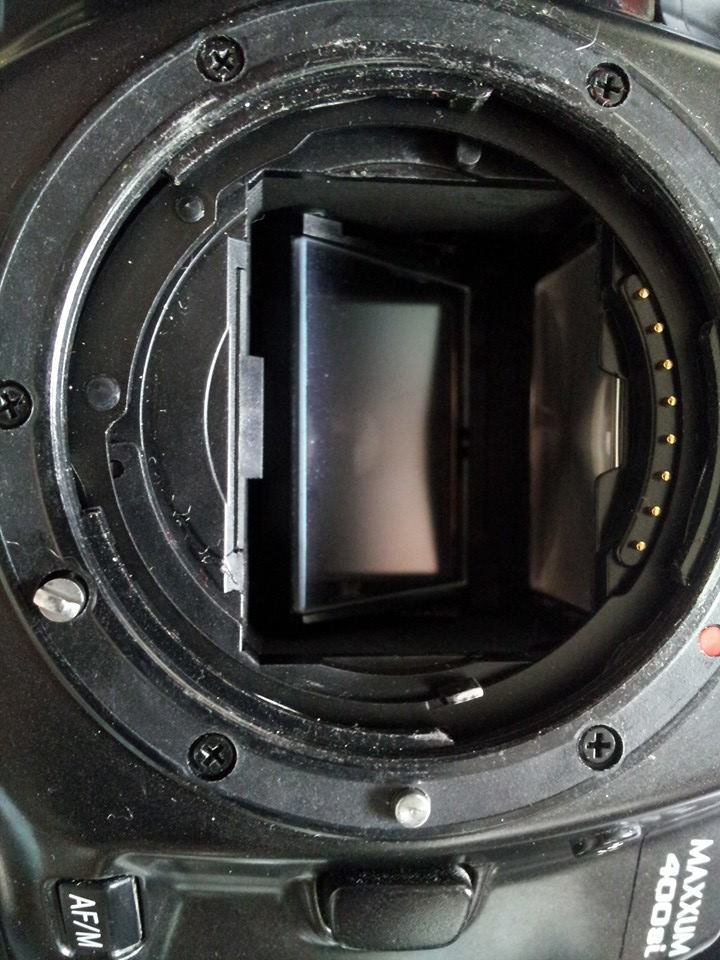

I've read all through the manual. I found out the issue has to do with one of the lens locking mechanisms.
dM1si4x.jpg The mechanism on the left does not descend fully into the body of the camera when the lens release button is pushed, so it catches and the lens is then only able to be removed with force (and sometimes even then I'm unable).
3sckkfo.jpgThe metal on the left is what the aforementioned locking mechanism clicks in to. The problem arises when the lock doesn't descend into the camera and so the metal remains caught and due to the force used to remove the lens, a dent was formed in the plastic (as you can see right below the metal).
I don't know what to do about this....I managed to push the mechanism into the body of the camera and place a piece of tape over it so it could net ascend into place and get caught, but unless that part of the lens is locked correctly, the camera will not shoot. I am not opposed to taking the camera apart, but I wouldn't know where to begin.
That mechanism is the screw for the auto-focusing. Have you tried putting the camera into manual focusing before putting the lens back? You'll see the screw will go down. Just press the button that you can see on the first photo.
BTW, all Minoltas after the Dynax 7000i (I'm using the international names, the Maxxum was only used for the US market) have a mechanism when you shutdown the camera, the lens will retract to the infinity position automatically.

Ahhhh....that makes sense! I have not tried to put it into manual before removing the lens, but I will definitely try that when I get home! Ahhhh, If that is the solution I am going to be incredibly happy haha. I'll update tonight and let you know!

Well...that actually works, but now the problem is the manual focus button does not stick like it should, so unless I'm holding it down, it won't go into manual focus mode. SO. I think I will. But instead of this body I'll make an "upgrade" to a better Minolta SLR body. I'd like to eventually get the sony DSLR body that works with the minolta lenses, but....I really want to learn film haha.
