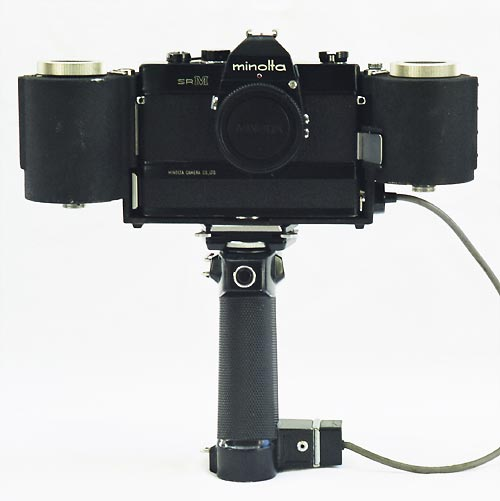

Does anybody remember those accessories for Minolta cameras that were a replacement of standard camera back that could hold bulk loaded film I think it was like 100 shots capacity. I tried to remember for which models it was available but I couldn't. I would really like to find one and to be able to shoot whole day without changing film.
Something like this
Minolta made a 35mm with integrated motor drive and bulk film back the SR M, as I recall it was unmetered as Minolta felt that the meter would not keep up the motor's frame per second. They made a back for the top of the line XK. I have the 100 foot back for the 9000, not sure if Minolta made a back for the 9.
