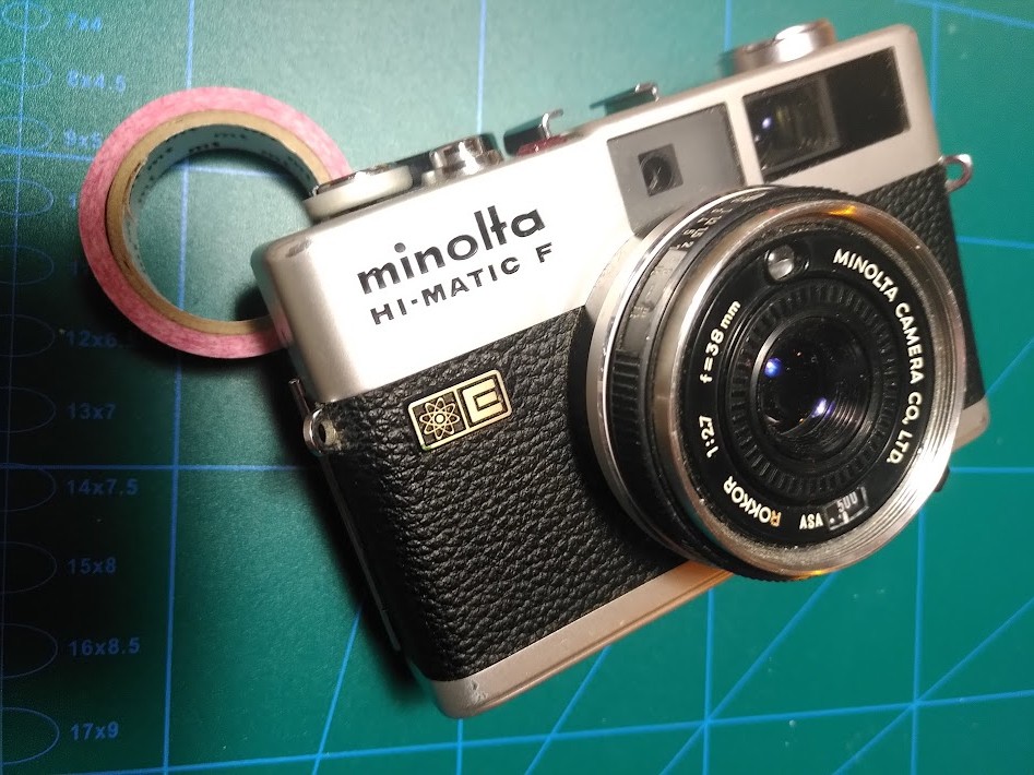

I got my hands on a Minolta Hi-Matic F that seemed to be in nice condition but I can't get it to work as is and I haven't found someone with the same specific problems.
I thought I'd check if anyone recognized the faults and could steer me in the right direction to what needs fixing.
Works:
Shutter button - goes down and sounds like it triggers something.
Advance lever - travels well, activates the film winding and unlocks the shutter button
Battery tester - two LR44 batteries seems to work when pressing the button and it lights up well
Doesn't work:
Shutter - doesn't move at all. Either with or without batteries
Low light warning - doesn't active at half press. I read in the manual that the batt. test lamp should light up as well on low light, but it does not.
Besides that the focusing, rangefinder and setting adjustments seems to work fine. The frame counter has only gone up since I got the camera. Though I have not tried with film yet.
My own thoughts so far..
I thought it was just the shutter that might be stuck with gunk but the low light warning makes me worry about an electrical fault.
Anyone recognize these symptoms on this model?

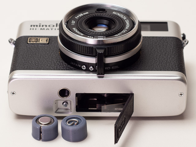

2x 1.5 volt LR44 batteries work well. I 3D-printed simple adapters.
