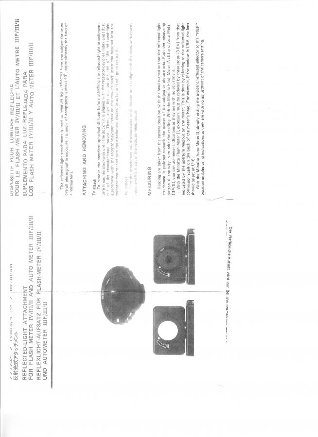

Papageno
I have the same attachment, but I use the AutoMeter IIIF. I have no problem.
See the attached jpg scan I've attached, it appears to be the correct one and according to the instruction sheet, no exposure compensation is required.
Hope this helps
Ira
Chan Tran
May 10, 2006
6,806
Sachse, TX
You have to look at the underside of the attachment to see the different. From version III and up (flashmeter III and Autometer III/IIIf) you need a ring in the groove to work correctly.
Ira Rush
Aug 19, 2006
177
Proud to be
There's another side, who knew!
Looking at mine now, I see the ring, no wonder I don't have a problem.
Guess mine is not the same after all. Stand corrected.
