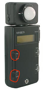

HI. I have a mechanical question - as opposed to a deep photographic question. I am an avid Med Format shooter, mostly outdoors / landscapes. Decided to try a few indoor shots - and I recently purchased a Minolta IV flash meter. It arrived today - and once I placed batteries into the unit, it powered up - except the slider switches on the left side of the unit are incredibly stiff/stuck. It took a lot of pressure to move them. I am not sure how to go about fixing this? Any suggestions would be helpful. Are they fixable? Am I out of my area of expertise .... help?

Thanks. I opened (carefully) the meter. The switches are, in fact, underneath a circuit board that was well secured under the cover. So, I stopped.
I suspect a lubricant and some sliding might be in order. What would you recommend as a suitable lubricant??

Thanks! I looked at the switch carefully. Nothing to indicate "dirt" that is making it stick. So, I took a small chance and used a drop of wd40. fter 5 mins of working it in, it is much improved. I am not 100% with it, so I think I'll need a longterm lubricant choice. Is the Kontakt 20 the same/similar to wd40, or ar these cleaners/lubricants on totally different trajectories?

On the outside of the meter. I am sending an image - if that helps.
Not sure what to do now - kind of committed to the WD40 track. But, I am sure I can leave it for a while and clean/lub again in the future??
Cleaner then a teflon dry lube?

It looks like you spritzed plastic on plastic slider parts, not the electrical contacts (unless some of the WD-40 spray penetrated, which it probably did). I would clean it as quickly as possible with a plastic-safe non-lubricating cleaner and see if it works better that way.

Oh you have the Flashmeter III and not IV. I have one with the broken mode switch. One day it just broke in pieces. I bought another one those. I like it very much.
