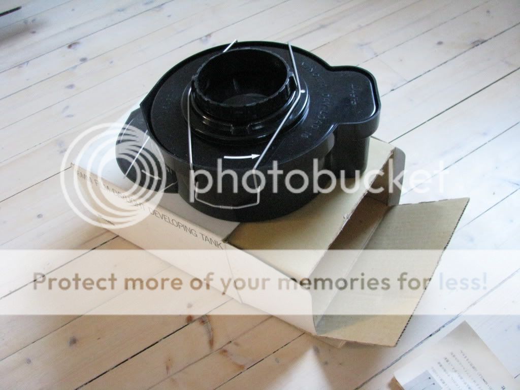

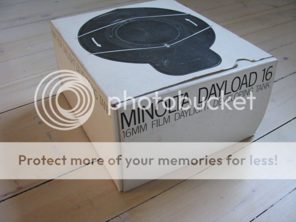

Daylight loading tank, specially made for Minolta 16 casettes.
Look at the pictures, this is like new in the box, never been used, even the recipt note is still there!

Eric - never seen one. Looks good to me. Presumably it is like the Minox and you clip the free end to something and wind and drag the film out? The cassette stays inside all the while.
How much developer does it require?

Since it used MORE dveloper than my bog standard old Paterson with a 16mm wheel, I prefer that, I don't mind sitting in the dark!
