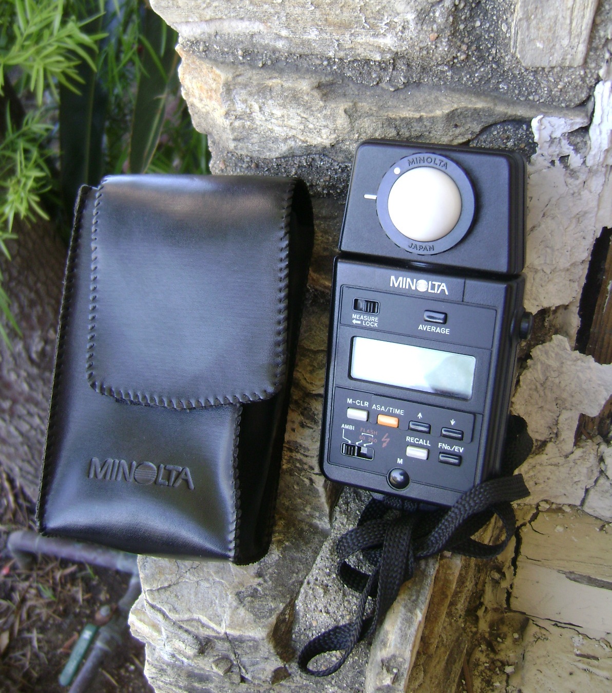

I am selling Minolta Autometer IIIF with case and strap in superb condition. This is dead-to-rights accurate incident light handheld meter that measures ambient and flash illumination. A wide range of optional accessories are available on the used camera market for this meter, including adapters to convert it to a reflected meter and more. A free manual is available at http://www.butkus.org/chinon/minolta/minolta_autometer_iiif/minolta_autometer_iiif.htm
Sold as shown with case, strap, and working fresh battery.
Price: $89 plus shipping
