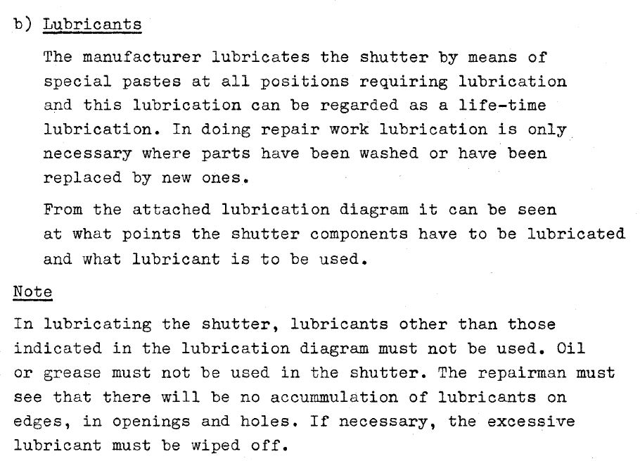

From https://learncamerarepair.com/product.php?product=86&category=2&secondary=21 Prontor S, Sv, SVX Repair manual.
Well, many Prontor shutters are in the scrap pile as they wore out due to lack of lubrication. Ilex shutters were also designed to run dry.
This was fine straight from the factory but 50+ years later a trace of oil and grease on pivots and sliding metal to metal parts and some springs makes for a smoother and quieter running shutter.

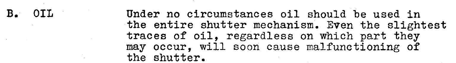

From another Prontor service manual, their philosophy is explained in a bit more detail. Could this be to address "repair hacks" who might be tempted to just add oil rather than doing a proper repair?
