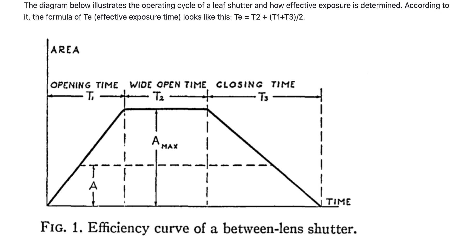

The fast speeds are too slow, in that case how are you measuring? They may be OK, depending on how you measured.

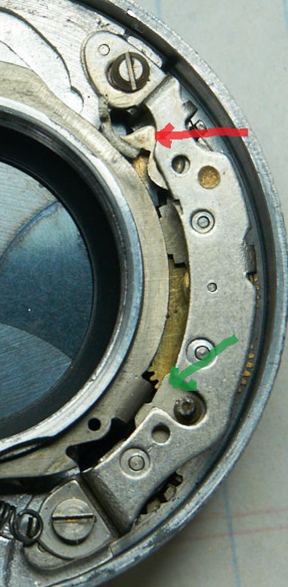

You have to take it all apart and clean everything ... especially each blade and the plates the blades are sandwiched between ... then loosen the speed escapement up again.
Move the upper pallet end closer to the centre ... if the shutter gets stuck then move it away from centre.
Check the slow speeds first.
If the slower speeds (~1/25s) are slow then move the upper pallet end closer to center.
Then check the higher speeds ... if they are slow, then move the lower retard end away from centre.
I have had to do this routine with a shutter about 4 times before I got all within 1/3stop.

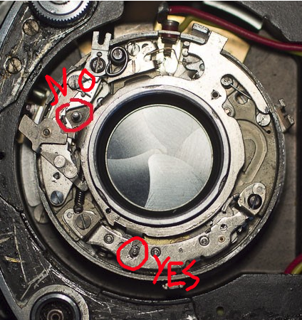

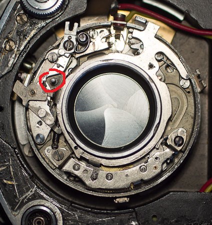

Thanks for that. Similar to the Synchro-Compur on the Rolleis. We're taking about that circled pin correct? Pic courtesy of @dxqcanada

I think that one in red is for the self timer.
The one at 6:30 connects the retard to the speed cam which operates the higher speeds.
The pallet at 4:00 operates the slow speeds.

Ok I had figured it was this one. Couldn't get it to move at all. I'll try again tomorrow.
