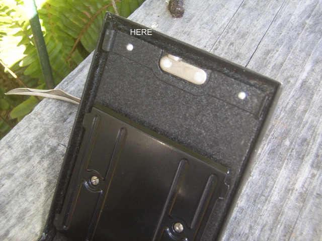

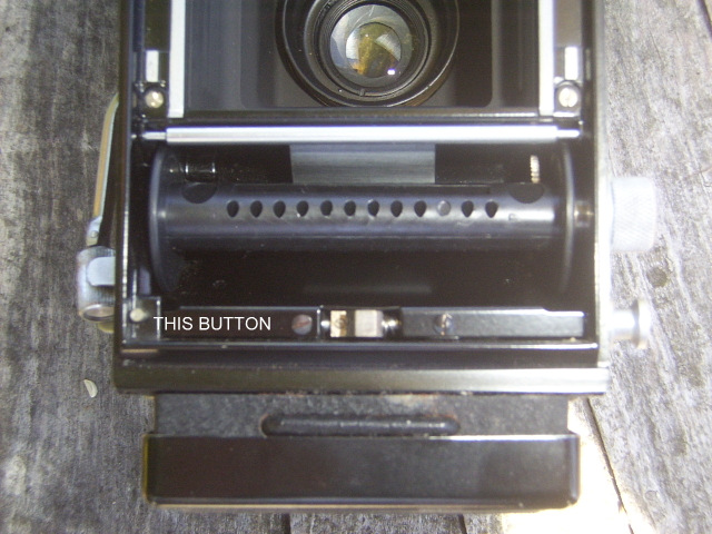

This camera has a problem with wind on.I have put up with the problem for a couple of years but now is the time to get it sorted out.
After taking a picture the wind on will operate perhaps 1/10th of the full cycle, to bring up next frame i need to wind the lever 8-9 times.I can wind on to the next frame in this fashion OR if i sweep the focus lever 3-5 times first then the wind on will operate correctly.This has me confused as i cannot see how the focus lever could effect the wind on.
The frame spacing on negatives is fine regardless.
The only possible cause i can come up with is in the attached photos of the back door and a small button which the door should push in when closed.I have a Meopta TLR that has a similar [ i believe] set up.
On the Autocord it looks to me that the door does not fully connect with this button.Could this be the problem?
Asking for advice before i play around and make matters worse:smile: DCPB UTTON.JPG DCP door.JPG

The door doesn't appear to be the problem. All looks right in both photos. If this wasn't working properly, the counter wouldn't move and winding would never stop.
There are a couple of levers that travel from the lens board into the wind side of the camera. I bet that by moving the lens board back and forth you jiggle something inside the wind mechanism into its proper position, activate a linkage, or some such change.
All in all, sounds like a dirty wind mechanism needing a good cleaning. Possibly a couple of interlocks adjusted.

Thanks for the info Dan.Yes what you say does of course make sense.I will do as you suggested and thank you for the links.I will e-mail Karl before i send of to the local repair guy here.
Yes i had thought that maybe the focus mechanism might jiggle something around and let it fall into the correct position.
