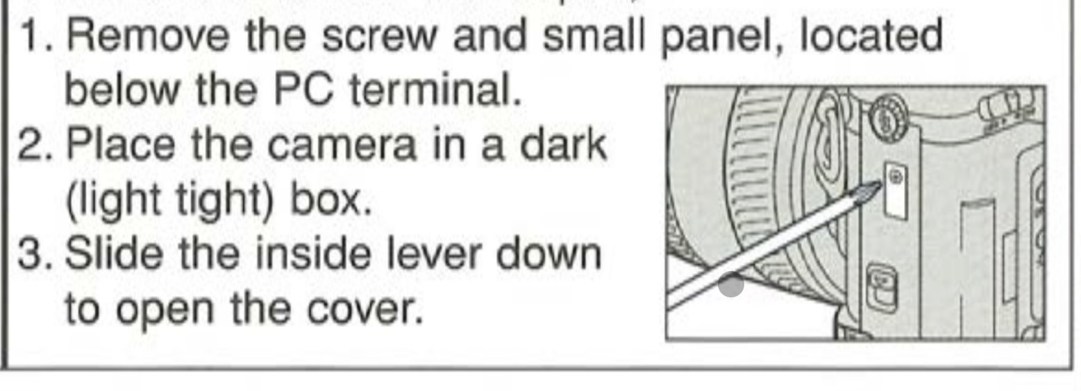

Found it in the manual.
My bad for not looking.
