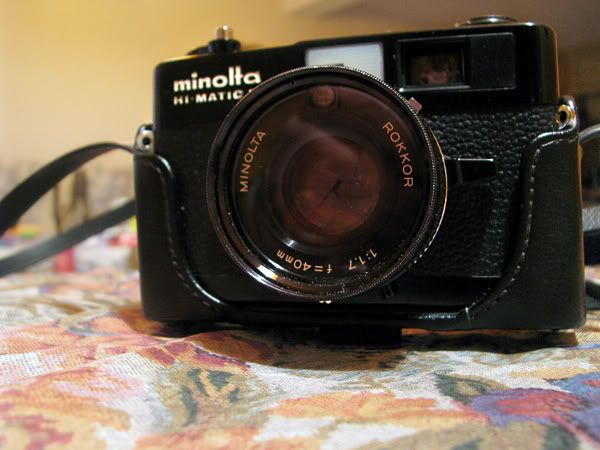

After quite searching for the right model and a camera in good condition, I recently bought a very nice, black, very well cared beauty, also my first RF camera ass well, so i wanted to share my first expericence, love and critics to the forum.
Here's my camera:

Also i have some problems with my camera:
The aperture rings opens only at f/16, f/11 and f/8 (on other apertures the ring doesn't change but it opens when i shoot.
I will need light seals replacement, (that it's the reason for the light seals?), and how can i fix the light seals?
Will using a lens hood will help about reducing the incoming lihgt and backlight, also the overal contrast?

Seals are easy to change, Interslice on ebay is an excellent source.
If you have a small piece of yellow or orange transparent plastic you can put it over the rangefinder window & improve the contrast for focusing. Maybe from a report folder or the like.
