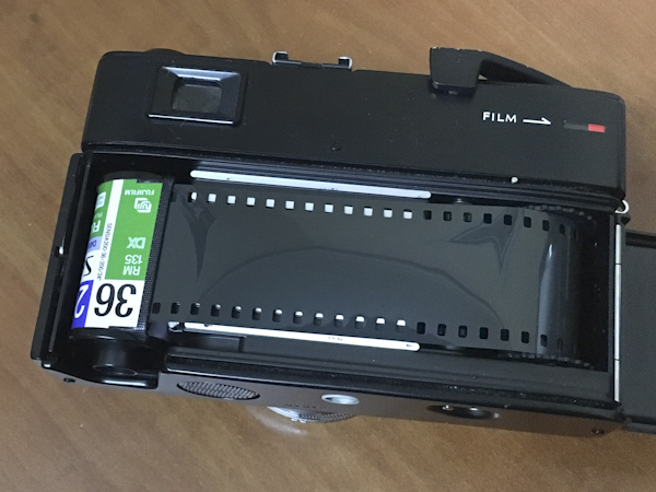

I am having a problem with my Minolta 7s Hi Matic, this is the first time I am using it.
It seems to work fine, shutter ok, lightmter ok.
After a few shots (8) I cant press the shutter anymore, I can't advance the film or wind it back (and i didnt forget to depress the little button under it ).
So I had to open it to take this film back and see what's wrong.
And I noticed that the film is halfly around the " film take-up spool" and halfy around the other one on the left , the "sprocket".
I guess it is not supposed to do that right? This has happened to me twice , maybe I am not placing the film properly on the film take-up spool for it to roll around the right spool ONLY?
Here is a picture of the crime scene;
https://flic.kr/p/RVgHb9

Was the orientation of the cartridge like that when you put it in? (if so, the opening needs to be facing to the right, with the flat surface being flush with the film plane).
It shouldn't be woven into anything, should just go straight across.
Sort of like shown here, since it has a slit in the spool at the end which you can use one of the sprocket holes in the leader to 'catch' onto it, giving it a rotation. (not the same camera here, but didn't see any pics online showing actual film loading into a Himatic 7, so I just found the closest style of take-up).
Dead Link Removed
But yea the flat side of the cartridge needs to be flush with the film plane.
Dead Link Removed

Hey,
thank you very much for these details. I found out what the probleme was:
i wasnt inserting the film THROUGH the take up spool, it was inserted in between the take up spool itself and the other cylinder inside of it, in this little space of 2mm....
Thank again for you help!
best regards
LAG
If I have to be guided by the image that you've attached, you are not placing the cassette and film properly of course ...

Hello everyone,
well I found out what the problem was/is , the thing is that the film loading spool (further right one) is not SYNCHING with the middle one , the so called "sprocket" according to the manual.
So i guess you can imagine the mess it becomes when one spool is pulling the film from the canister and the other one not receiving the film properly on the sprockets at the same time... I am really disappointed , i wanted to start using rangefinder cameras with approx 35mm lens , just to compose differently than with a 50mm lens (which I do all the time)
