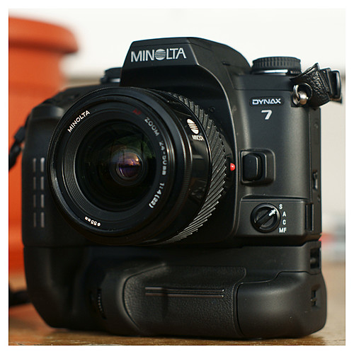

Wade, this is a Dynax (Maxxum) 7 (with vertical grip).
A lot more sophisticated than the Maxxum 7000 indeed. I tend to upgrade in increments. SRT 101, SRT 201, X-700 and now the 7000. Looks like I may need to upgrade again.
