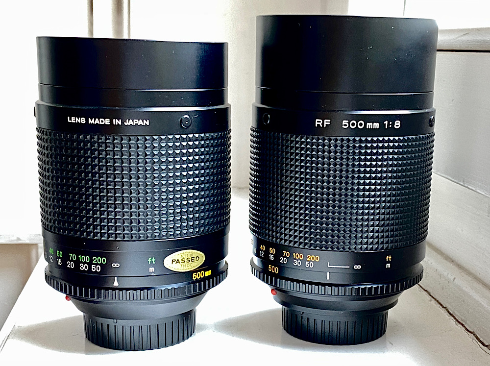

A Minolta 500/8 RF had already seen clearer times.
The front primary mirror is evenly clouded. I assume that there is fog that should be cleared up.

I have versions II (left) and III of the 500/8 RF:

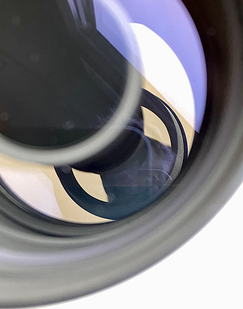

Version II has even fogging.
Here for comparison - not optimally presented, but should work - Version II:

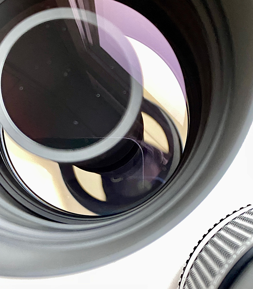

and version III, where the mirror is perfect:
