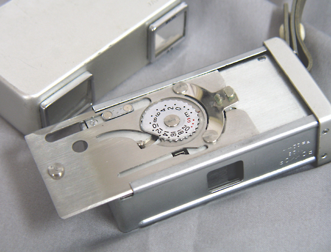

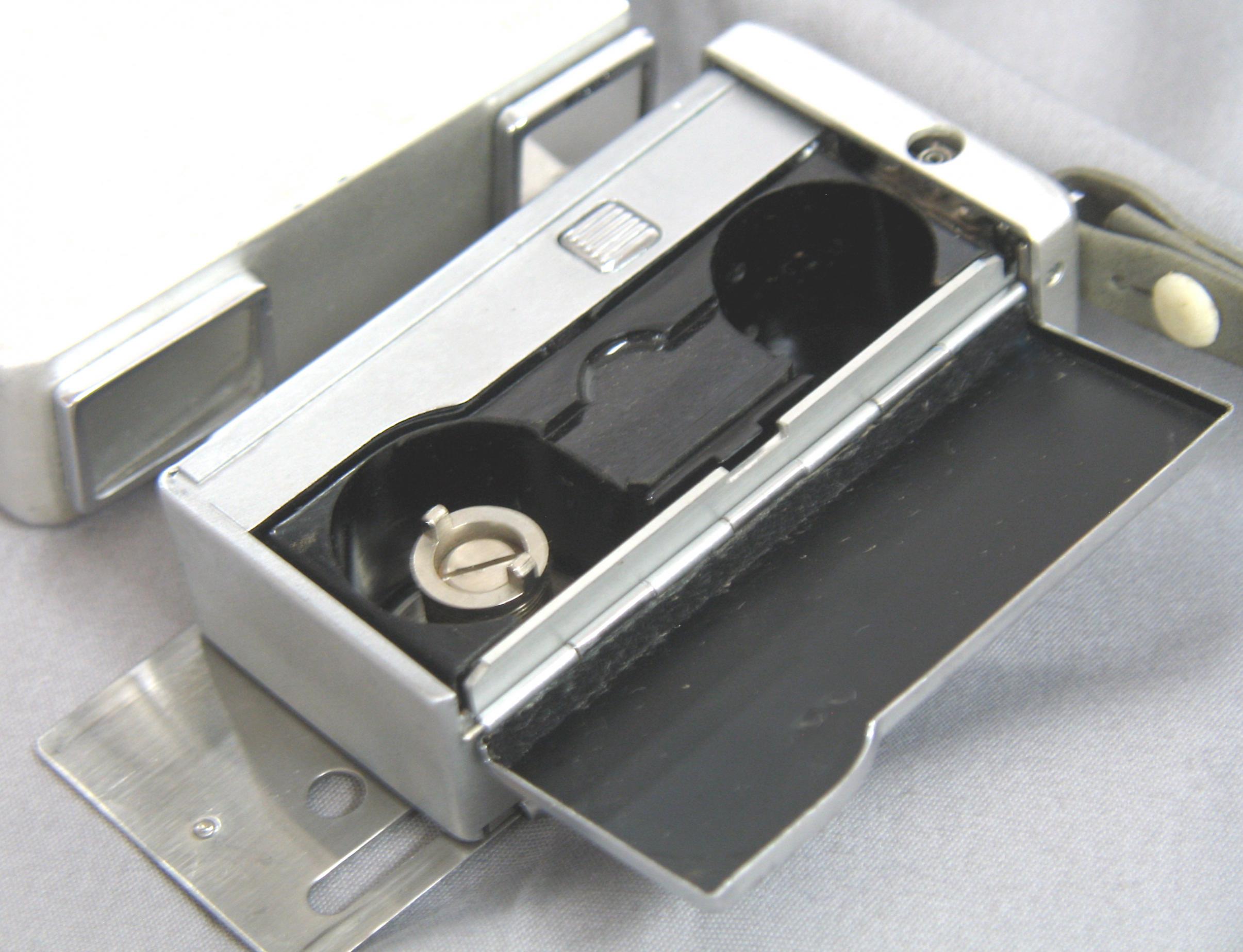

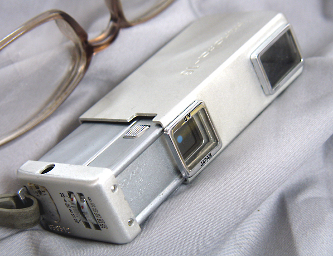

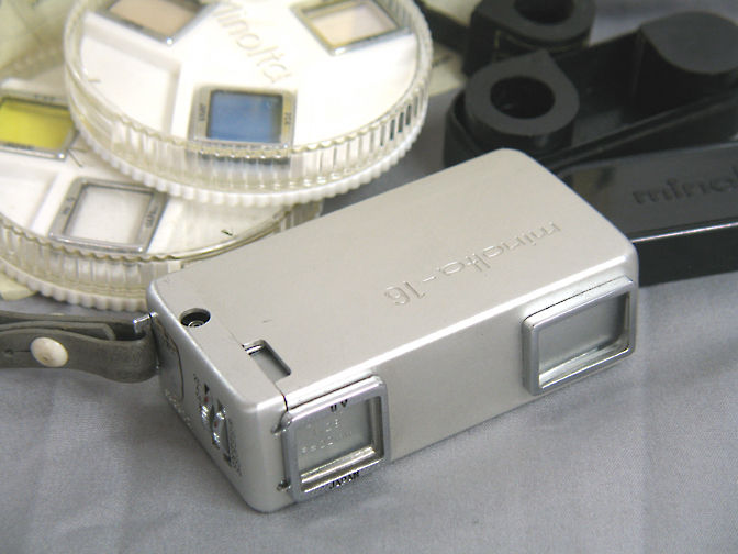

Minolta 16. Subminiature 16mm "Minox" clone.
Everything works.
Clean.
Nice, except for a tiny scratch on the case (see photo).
Eight extra dedicated filters: #80a, 81b, 1A sky, Y46 yellow, #0, 1, &2.
Three empty film cassettes for those who like to "roll their own".
Also... an original Minolta film cassette box.
$60 plus shipping. I'm not set up for PayPal, but Visa/MC is ok

Let me add: the filters included in this offer are often difficult to find, especially the 0, 1, and 2 auxiliary lenses that permit proper focus at infinity and closeups. And the included empty cassettes are normally hard to find as well, so this is a very complete kit for someone who wants to get into submini photography.
And I will add: Minolta cassettes are easy to load. Film is same width as 110, so 110 reels and negative holders can be used, 16mm negative movie film can be used, slit film in a few emulsions can be ordered from Goathill Photo.

I now know that this is a Model II, with the full range of shutter speeds and extended aperture range.
What's especially useful is the information on the close-up lenses.
I was really puzzled, since they appeared to be nothing more that flat window glass...
The Minolta site link and close-up lens data really helps to understand this nice camera.
Thanks again.

I slipped a thin metal mirror into the film gate so light coming thru the lens from the front would illuminate the lens from behind.
No apparent fog or dusty bits front or back.
Next, I cut a little piece of 4x5 film and slipped it into the film gate and took an outdoor shot in some evening light.
Used the yellow filter, ISO 100 film, 1/30 second at f8.
Hand developed it by inspection.
Darn, the film slipped out of the gate.
Try again, but cut the film a bit wider so it wouldn't slide around.
The film curled a bit as I closed the camera, but the light is waning fast, gotta hurry.
Developed it and got a very nice, contrasty negative.
The curled film messed up the focus a bit, but the density and contrast is good.
That was kinda fun, a new experience with fingernail size negatives.
A hekkuva lot different than working with 8x20 negatives.
Reinhold
