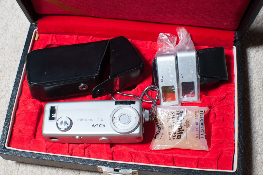

I received this nice camera in a kit with other gear and won't shoot it. I'm more of a bigger format guy.
The camera looks pretty clean and includes the nice box, case, two lens filters (Y48 and UV), and an original Minolta Silica Gel pack (but probably not useful anymore).
$40 with US Priority Tracked shipping. International shipping available, message me for price.

Anyone considering buying will want to know -- does it have a film cassette with it or inside?
Cholentpot
Oct 26, 2015
6,655
Does it focus to infinity? Any clue if the shutter fires? And yes, does it have the cassette?
