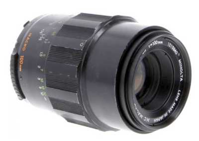

I know that the first 100/2.5 was not a Rokkor--X. I will have to find an example of the early lens and post a picture of it next to the next MC Rokkor (also not a Rokkor-X). I have a theory about the 100/2.5 with the wider focusing ring. Some might have been made with left over parts from another earlier lens in the 100 range. I have a Canon FD SSC 24mm f/2.8 with a chrome front. The breech-lock ring is not spring loaded. There are undoubtedly left over parts involved. There is one more Minolta 100 I am interested in. It is the first version of the 100/3.5 Macro with the metal focusing ring.

I now know what you are talking about. There are two versions of the first MC Rokkor-PF 100mm f2.5. They are the same lens except for a small difference in the metal focusing ring. Dennis at EAZYPIX refers to this difference as: MC I and MC II. The 100mm f2.5 was not the only Rokkor lens that saw this change -- but many (most?) don't even consider them different lenses. Here's how Dennis describes this very minor difference -- which most people don't even notice until it is pointed out to them. (Dennis does not list the 100mm f3.5 MACRO as available in the MC I version, only the MC II version.)
"This lens series (MC II) features a new focusing grip, but is else unchanged to its predecessor. The new focusing grip has the serrated sections formed concave, so that they form a "valley" between to "hills". This lead to the german name "Berg und Tal", in the anglophone region it's usually called "knurled grip". Since the grip section is considerably shorter than with the MC I series, its also called "short grip"."
