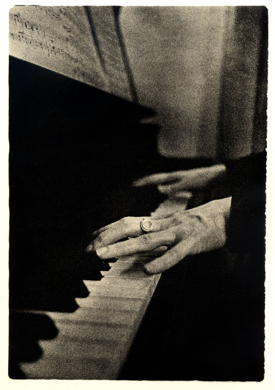

I have some negs I shot in very dark situations with 3200/35mm that were very grainy, but loved the shots. Very hard to print, even harder to tweak with bleach, since midtones aren't so much midtones as tiny clumps of black grain, so the bleach just sort of burns things out. I found that lith printing was nice for those images. The way lith works with graininess suddenly made the grain much more a part of the image.
attachment.php
