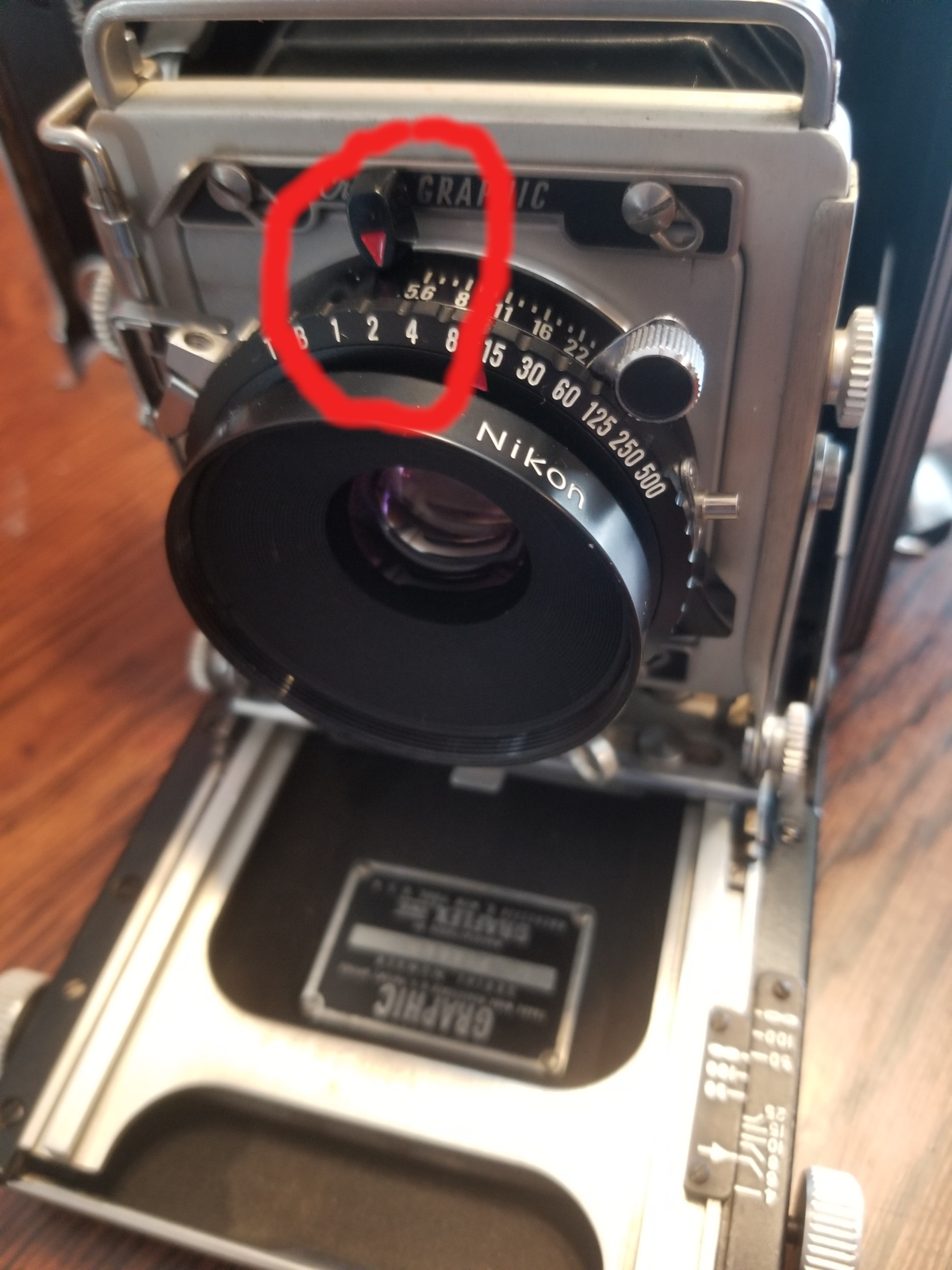

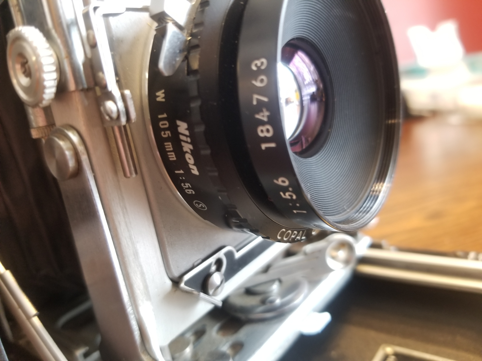

Just to follow up on this. I bought a Nikkor W 105mm f/5.6 in black copal shutter. I does fit and close, but just barely, with some adjustments. The cocking lever has to be orientated so that it is in a corner of the front standard track, and I had to make an aluminum washer .055 thick to space the lens out from the lens-board This is because the aperture control lever would hit the lens-board locking ears.
View attachment 265743 View attachment 265743
