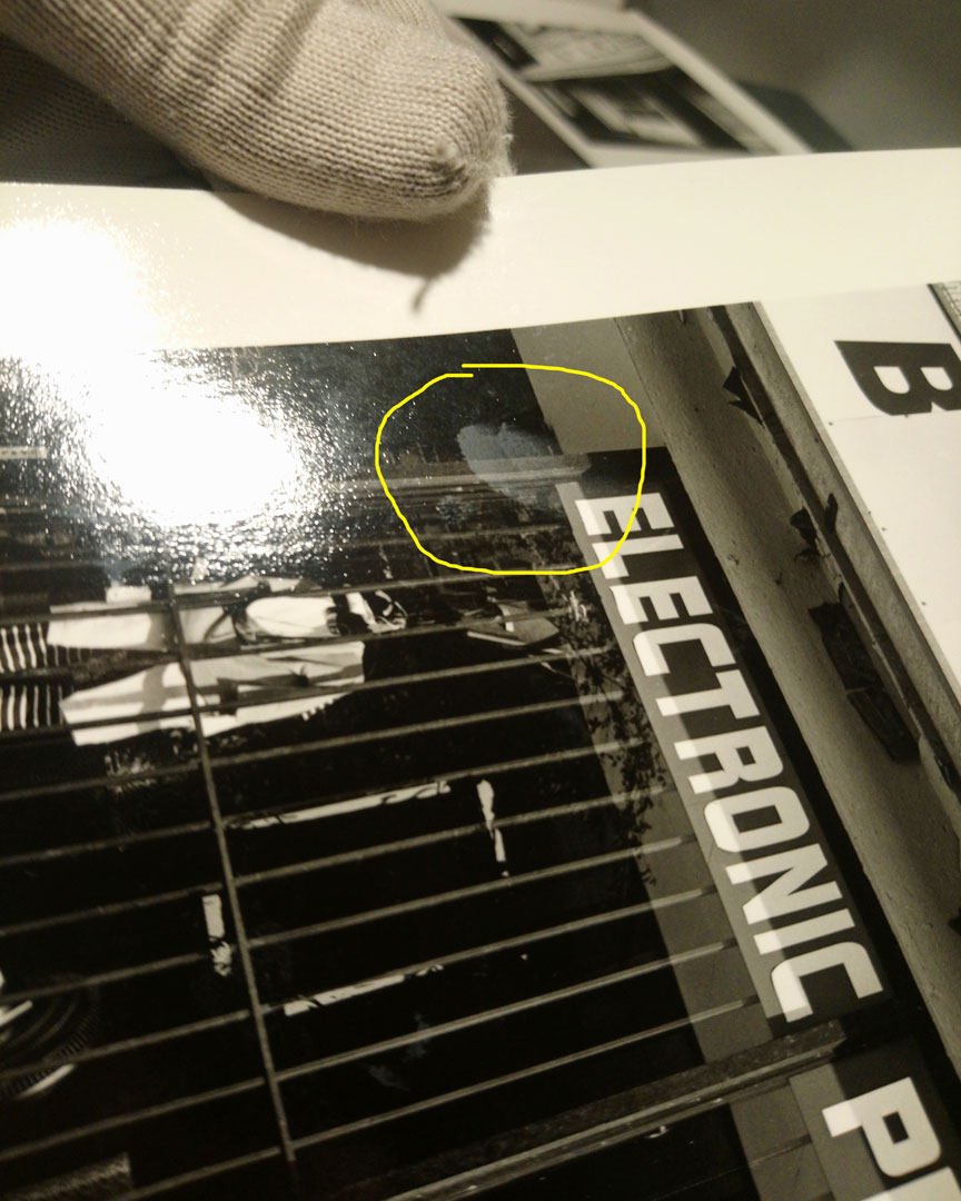

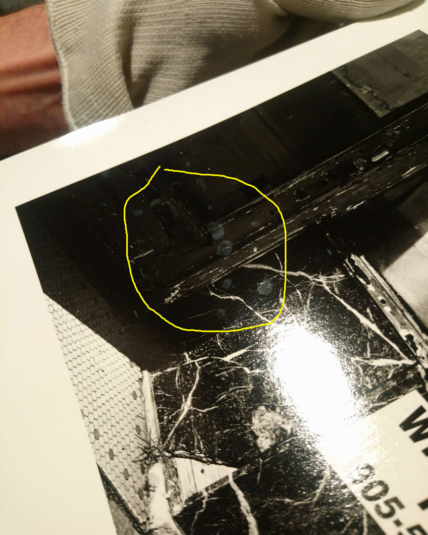

I get this "stain" on prints after selenium toning, and using a home brew hypo clear.
It looks sort of like fingerprints, but it's not. It doesn't come off with PEC-12, which makes short work of grease like fingerprints. I toned 44 prints yesterday, and 12 of them had those marks. The good news is, it does come off in a short (10 second) rinse in fresh stop bath. I could do without the extra steps though, so I'd like to get to the bottom of this issue.
I absolutely never see these stains on an untoned print. I also absolutely never see them unless I hypo clear. So it's related to one of these.
I re-use my selenium for years, keeping a gallon jug topped up and filtering it every now and again. I don't have any recollection of having this issue with a fresh batch of toner, as that's a pretty infrequent event.
My hypo clear is a 2% solution of sodium sulfite in water with a pinch of EDTA. Yesterday's mix was 40g sodium sulfite, and 0.5g EDTA in 2000ml water. I hypo clear the prints after selenium toning for 3 minutes. Prints are rinsed prior to hypo clearing.
I add the EDTA in an effort to reduce this sort of mineral staining. It's not working so hot! Maybe I'm adding too much, or too little? Yesterday, I noticed that the hypo clear was a bit "cloudy" at the end of the session.
Any problem solvers out there who can help me with this?
Thanks!

The fact that the spots come off in an acid environment (stop bath) would suggest that they are calcium carbonate or other similar "hard" water deposits that acid can dissolve.
My suggestions:
First, squeegee your prints well before drying (I use a dedicated windshield wiper blade) and dry them face-up to avoid contamination. Getting rid of the excess water and any droplets will likely solve the problem.
If that doesn't work, use a distilled-water final soak after the wash and before squeegeeing to leach out the minerals. Three to five minutes would be my starting point.
You might also try a weak stop bath mixed with distilled water before the wash (and after the hypo-clear) and see if that does the job.

If there's a deposit on your prints after drying, something, from somewhere, was in the last water the print spent time in and is left behind when the water evaporates.
So, if it's something from the selenium toner, then it's not washing out. Same with the wash aid. Maybe extending the wash time will help. If it's something insoluble from wherever, then you need to track down which solution is contributing the contaminant. You may need to replace things in your regime one-at-a-time till you find the culprit. Maybe something's too old?
If it's the wash water itself, then the distilled-water final bath would definitely help.
The weak acid bath is a possible remedy for prints with deposits on them, to dissolve them away if they can be.
