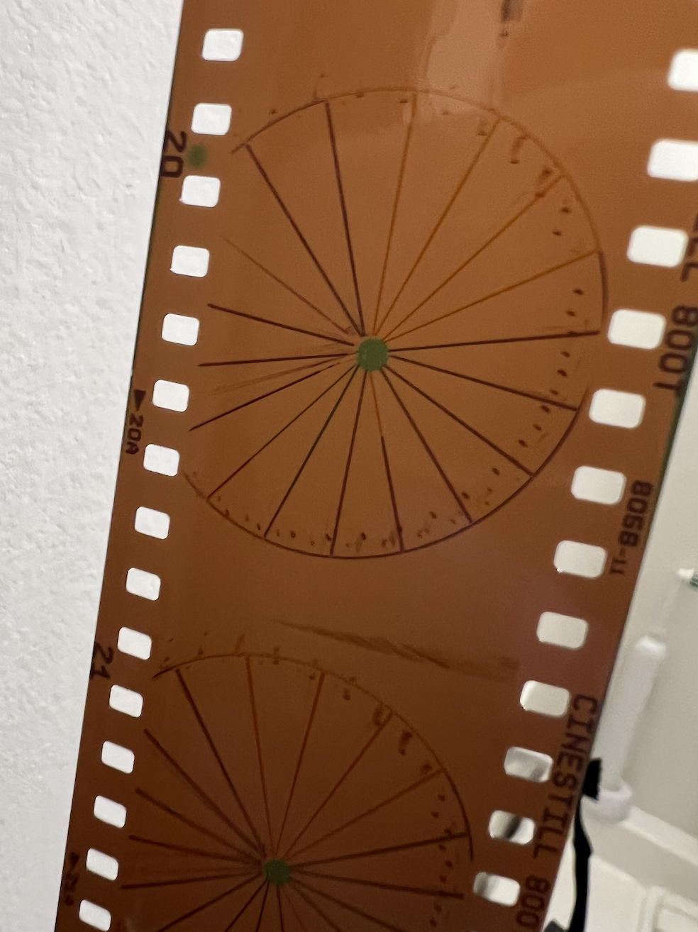

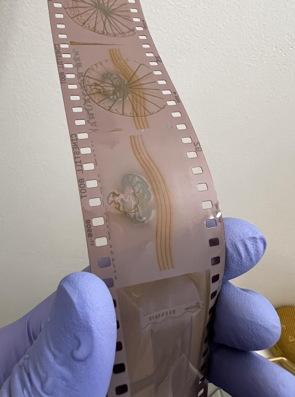

Not sure why they are this color... I have processed a lot of color film but this has never happened.
On the other side they look perfectly fine and the colors look normal.
Is it normal with CineStill?

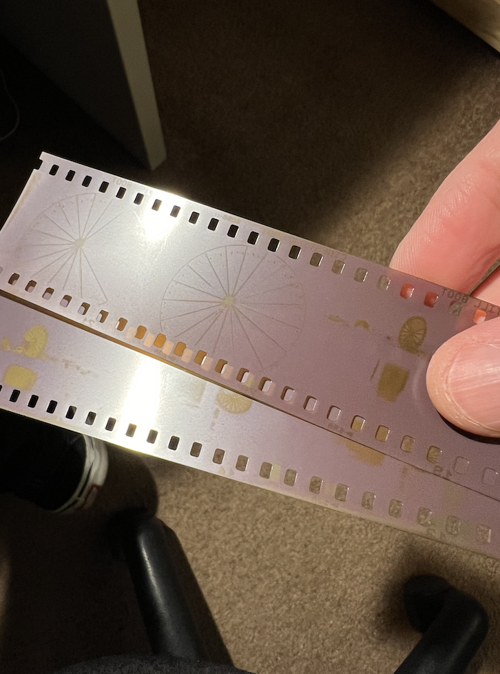

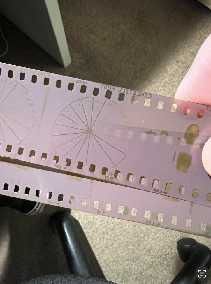

The Kodak Vision3 films do look a little milky when still wet. See how the film looks when dry.
Still pretty opaque unfortunately.
I'm guessing my chemicals are at the end of their lives and I didn't quit while I was ahead?

If they don't clear up when dry, you could try a refix and see, whether this clears up the negatives.

That looks like your fixer didn't work at all, so either it's totally dead, or maybe you forgot that processing step or made a mistake identifying the correct bottle.
As @Rudeofus says, try fixing the film again, then wash and see if the problem goes away.
Thank you! No I know for sure that I used the right bottle where I have the blix.
How long should I resoak it for? Same amount of time?
Is there a way to test a blix to see if it's still good?

If you have new/undeveloped film, cut a small piece of it and dip it in blix. It should clear up within a minute, with a nice tan on the mask.

@fabulousrice how old was the blix you used here? It's possible that it has gone bad. Blix is an unstable mixture; the fixer component is the first to die.
You can fix your negatives in B&W fixer. Fix for 10 minutes at room temperature, fixer dilution 1+4. This should be more than enough to clear the film.

Thanks! I think that did the trick
