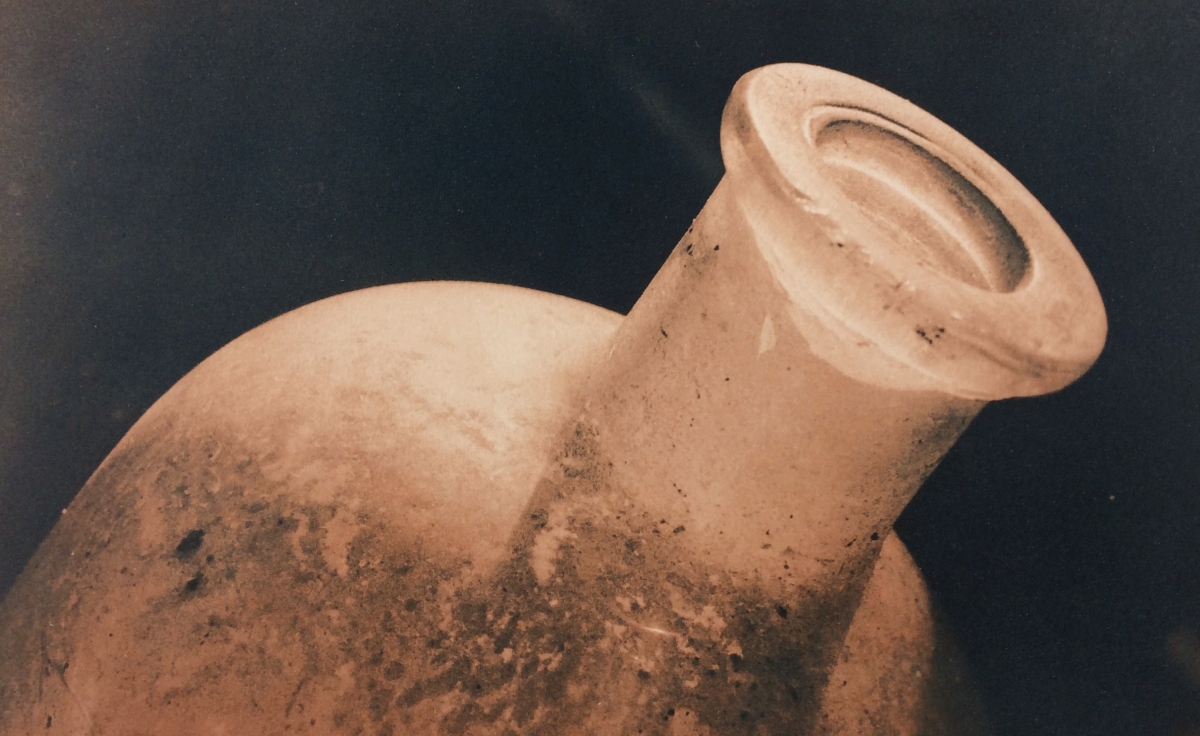

Today I tried the following synthesis process for Simple Cyanotype high contrast version:
Solution A
Water: 25 ml
Citric Acid (anhydrous) : 12 g (Equivalently, Citric Acid monohydrate 13 g)
Ferric Nitrate (nonahydrate): 12 g
Solution B
Water: 50 ml
Ammonium Carbonate: 14 g
Add solution B slowly to solution A and stir well. Will fizz.
Top it to 100 ml.
pH ~ 7.5
I could have added more Ammonium Carbonate to get pH to ~8 but stopped.
I used 2 ml of this and 0.2 g of Potassium Ferricyanide to coat a A4 sized Canson Montval 185 gsm cold pressed paper that had been coated earlier with 5 ml of 10% Ammonium Chloride solution. The resulting FerroBlend print had nice split-tone effect. I toned the print with the following toner:
Water: 200 ml
Copper Sulphate: 2.5 g
Ammonium Carbonate: 5 g
Used about 25 ml of the toner for toning the print (about two minutes). Blue shifted towards black and highlights brightened a bit. The toned FerroBlend print looks good to me. Will post the print pic tomorrow.

@Raghu Kuvempunagar what was the density range of the negative used for the bottle? Was the Canson Montval acidified first before coating it with Ammonium Chloride solution? And finally, did you tone right after development (and rinsing/washing)? Thanks!
Raghu Kuvempunagar
Jul 28, 2016
3,140
India
Andrew, should be 1.8-2.1. I got this negative printed with a bunch of others on a Laser Printer from a printing shop. I had low expectations initially but this seems to be a more capable printer than run of the mill laser printers and the negatives seem to work alright.
No, I didn't acidify this 185 gsm Canson Montval paper, only Ammonium Chloride coating. Being a low weight paper, it is not heavily buffered.
Yes, I toned right after development (rinsed and washed).
