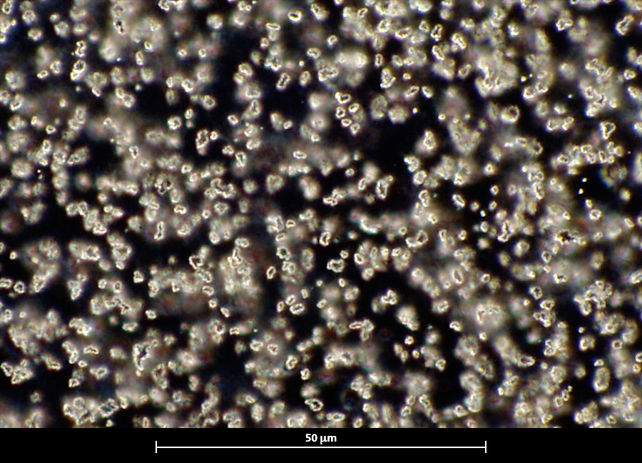

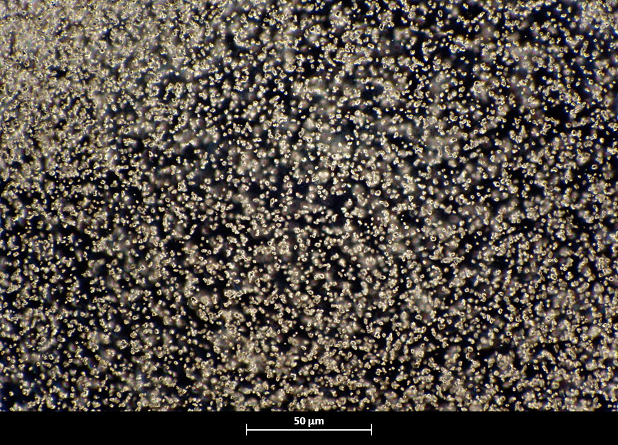

Hi,
just two photos of some silver grain, Kodak TMY-2, I made using my microscope with darkfield setup:
First the full image, second is a crop out of the first one:
I was trying to let the silver show up it's metal gloss...
I must admit here some tricks were helpful, like using a very high aperture oil immersion darkfield condenser, a good 40x oil immersion lens, a thin glas slide...
A small strip of the film was mounted on a microscope glass slide and immersed in oil (water lets the film swell too much). On top a cover glass.
The transparency of the film base is fine, so no need to coat a glass slide ourself.
For a general overview simple brightfield (and a entry range microsope) is ok, too - the grains are just black then.

As you indicated darkfield microscopy already is a step beyond the entry level.
And as indicated by Ralph, a lot of crystal and silver-grain microphotographs presentd in textbooks or by the industry are enhanced beyond plain light microscopy of the emulsion. For instance by coating or by employing scanning electron microscopy.
Your images are impressive nonetheless.
Thanks, AgX,
I remember some very impressive electron microscopy images in one of Erwin Puts' publications on film... a great tool to analyse the silver grain...
Anyway I'll make some photos using entry level optics when I find some time the next days.
Have a good day
Jens
