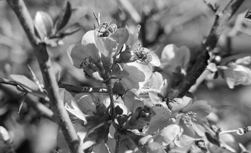

Well, A little better than I expected.
1st roll in D76 1:1. Negatives are a little dense but should be fairly easy to print. I'll probably have to work to get the contrast in the print the way I want but I should be able to duplicate the scan OK.
Minor level adjustments in LR

Not much wrong with the bees shot nor with any of your previous ones. Like you I prefer the PMK one but I find it difficult to tell if this is PMK or simply a shot that would have looked marginally better than the other two irrespective of the developer
Incidentally the bees one would be superb with a touch of hand colouring of the bees only. I only wish I had those delicate hand-colouring skills but alas
