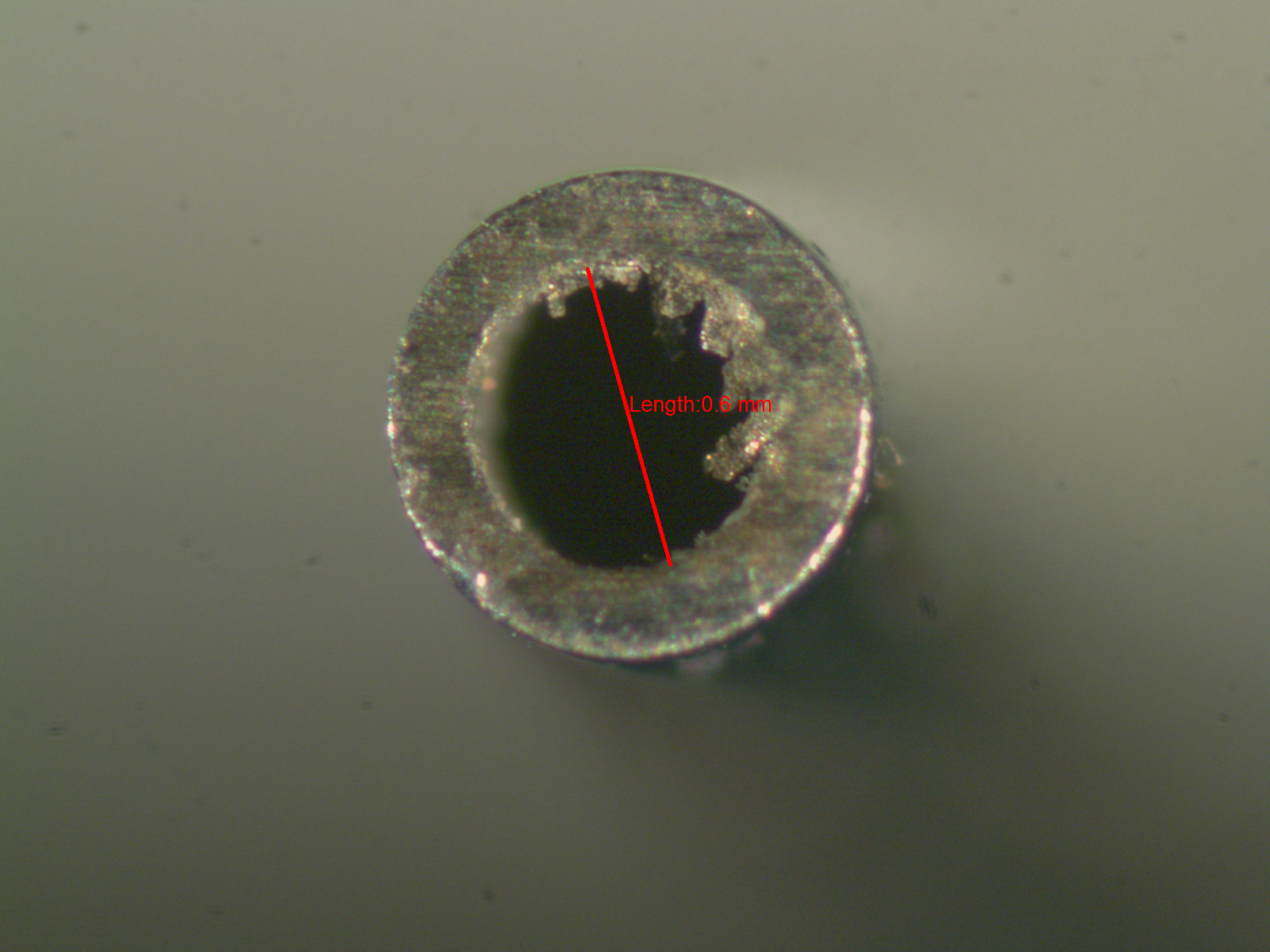

One of the perks of being at GEH is the conservation lab. Not only do they have a bunch of awesome microscopes, but they have people that know how to use them!

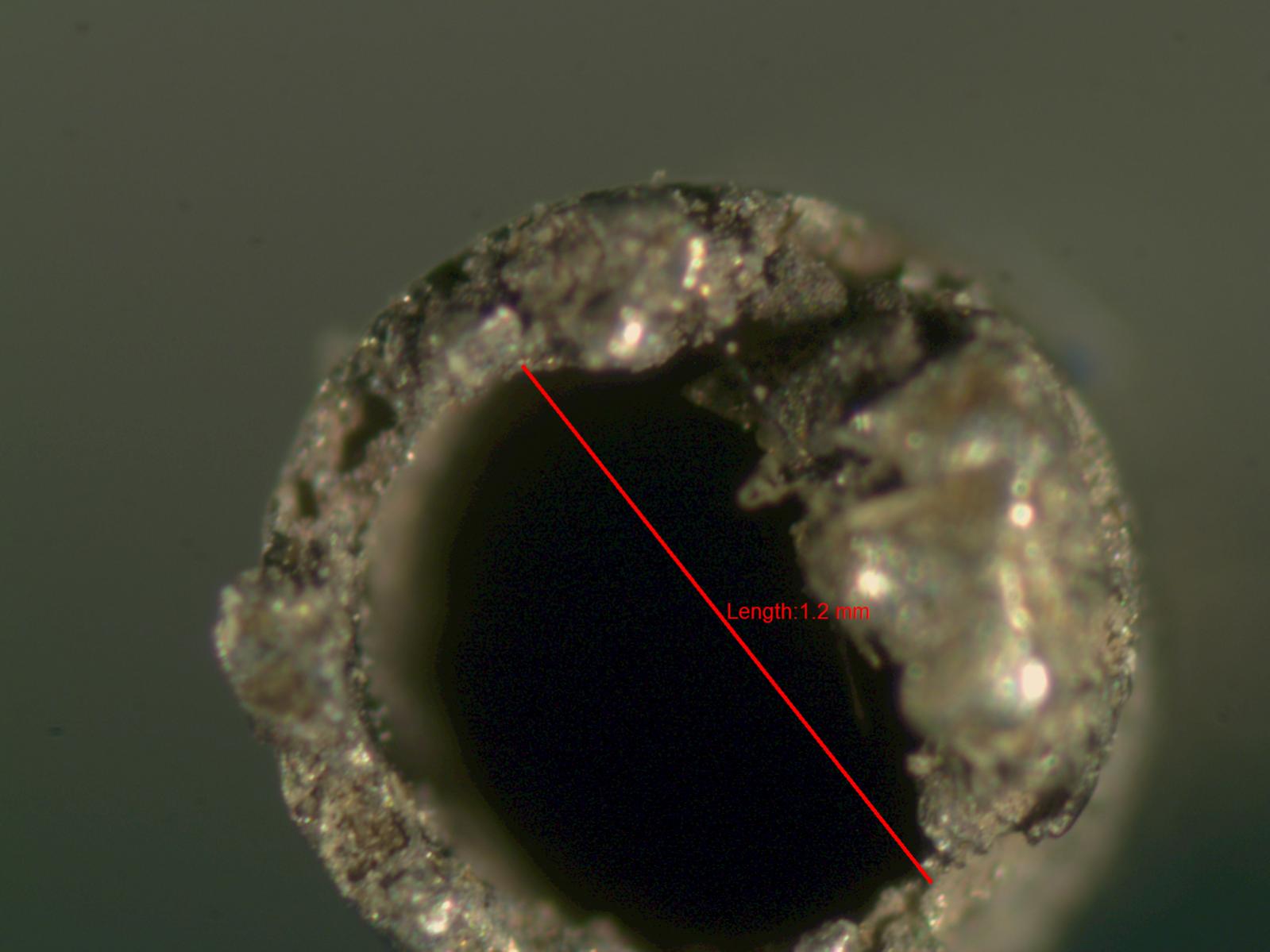

Mark Osterman brought in a couple of old Polaroid precipitation nozzles (needles for introducing silver-halide into the emulsion pot) and I wondered how big the openings were. I asked Ralph Wiegandt if he could measure them somehow and he showed me how to do it on the microscope. These are at 50x.
There are 3 images; two metal nozzles that were originally used by Polaroid and a glass nozzle, hand pulled by Mark that we use in the emulsion lab here at GEH. The metal ones measure 0.6mm and 1.2mm; the glass one is also (miraculously) 0.6mm.
In hypodermic needle gauges, this translates to 16g and 21g.
To me, this brings up an interesting quandary. The same quantity of silver-solution can be introduced into the gel/halide "pot" in a set amount of time, yet the nozzles can be bigger or smaller. The effect being, to increase the pressure at which solution enters the pot.
On one hand you can have an incredibly fine stream of high pressure going through a very small nozzle, and on the other hand you can imagine a large nozzle that just "drips" out.
So how important is the nozzle size and the pressure?, or is rate of addition the more important factor??

I use 24 gauge needles, directed as closely as possible to the stirrer. So far, I've never had any "crunchies" or pepper grain, except when I once used a larger bore needle. 24 ga. and finer does require quite a bit of pressure for quick delivery!
Very interesting Ian; that's quite a fine nozzle indeed. How large of a bore are you referring to when you mention the crunchies??

Chris, the larger bore item was one of those hardware store syringe thingy designed for glue, probably 1mm. It was very tricky to achieve a steady delivery. Basically useless.

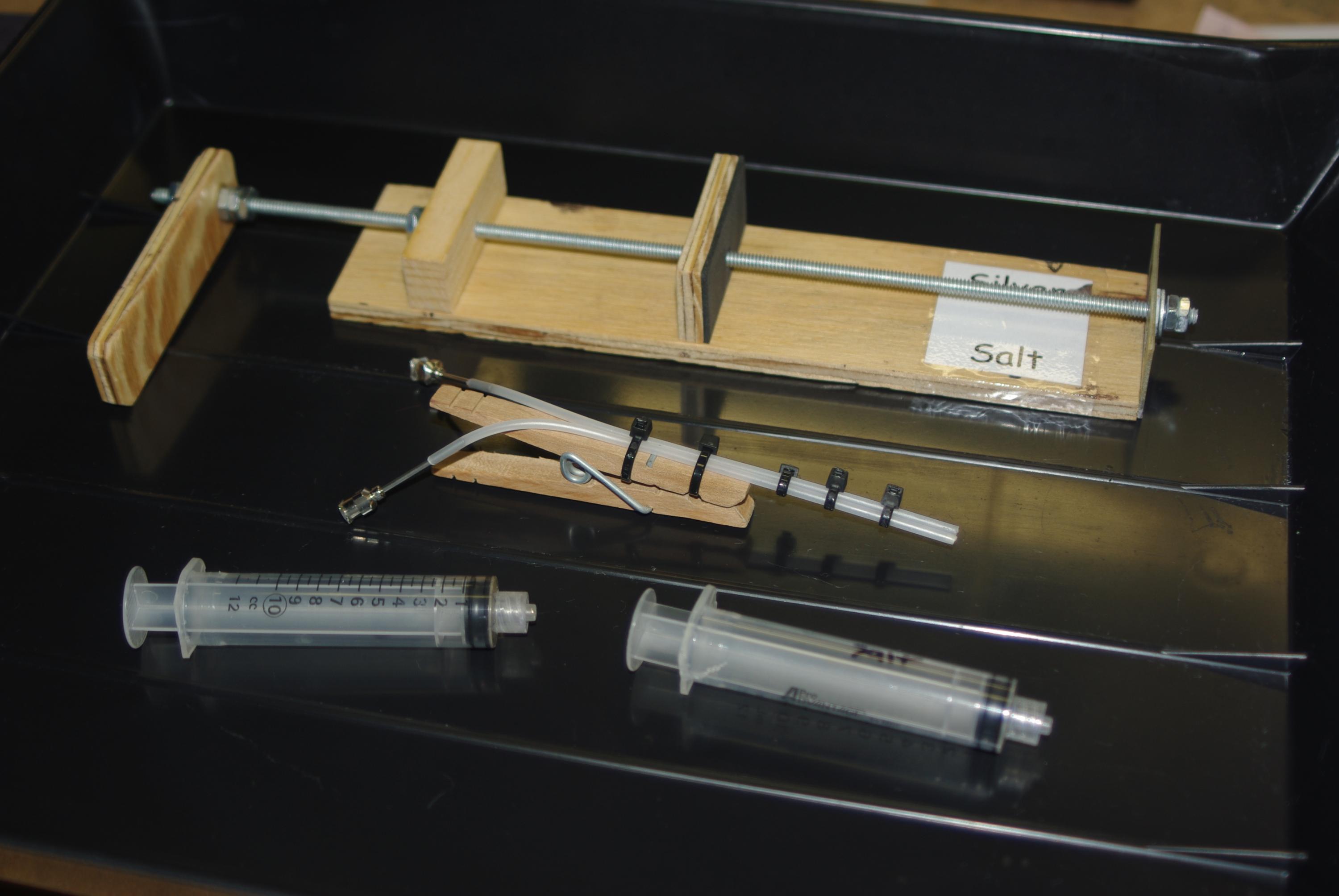

I 've made myself a hand crank syringe pump and use 18 gauge needles and nylon (I think) tubing. The tubing came from empty hair spray bottles. It's not really not that hard to control delivery rate. Below is a picture.
The tubing arrangement is likely to change a little because the clothespin tends to move around on the side of the pot and the tubes don't really point were I want them to. Also, been thinking about changing to a smaller sized needle.
I think the part about the cohesiveness Ron mentioned to you is that the high pressured streams push away the other liquids and allow the salt and silver reactants to combine at a more closely controlled ratio. So, the crystals are nucleated within the stream and then carried away into the rest of the emulsion. You want to have the reactants introduced sub-surface.

As for your idea of needles through a cork, you could do that. As you can see, mine works by attaching the needles to the syringe and the tubing leads to the kettle with the needles acting as an adapter for the tubing . The tubes are held to the kettle with a clothespin. The syringe pump sits on a stand (aka brick) next to the water bath (aka temperature controlled crock pot). So, in a sense, my pump is not really injecting with much pressure at all.
What you want to happen is that the liquid is injected subsurface and that you get all of the chemical out of the syringe and the line since AgNO3 is not cheap. If you are trying double jet, you want the reactants injected next to each other and I have seen some diagrams that even show an outer shield around the tubes or needles to allow the reactants to mix in a sheltered area.
Another thing I have found is that AgNO3 is building up in the stainless needle on the silver side. Actually it almost looks like metallic silver. I don't know if this is a conditioning effect or I should clean it out.

I think it's just Silver plating onto the stainless steel of the needle. If the Silver deposit in the needle is reducing the flow then I would suggest soaking the needle in a silver solvent such as Sodium or Ammonium Thiosulfate (Fixer).

The silver plating shouldn't be a problem, as Joe said, and as long as you flush your hypodermic needles with hot water after use and allow to dry, I can't foresee any "gunk" being a problem. The only thing that's going through it is silver-nitrate & water. I doubt that hypo will get rid of it since it's metallic silver though, which has effectively "printed out".

I noticed the buildup after my last double run. I've made three. Two worked, in that I got a working emulsion although it wasn't anything special. One was an outright failure, except I can use it for coating practice. Fortunately, they were all quite small. The needle should clean out easily enough, and if it doesn't, they are pretty inexpensive.

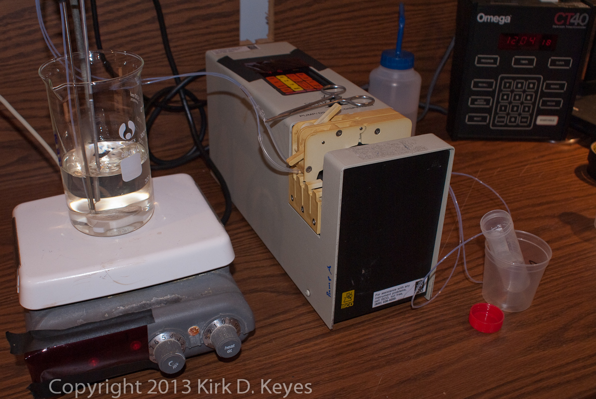

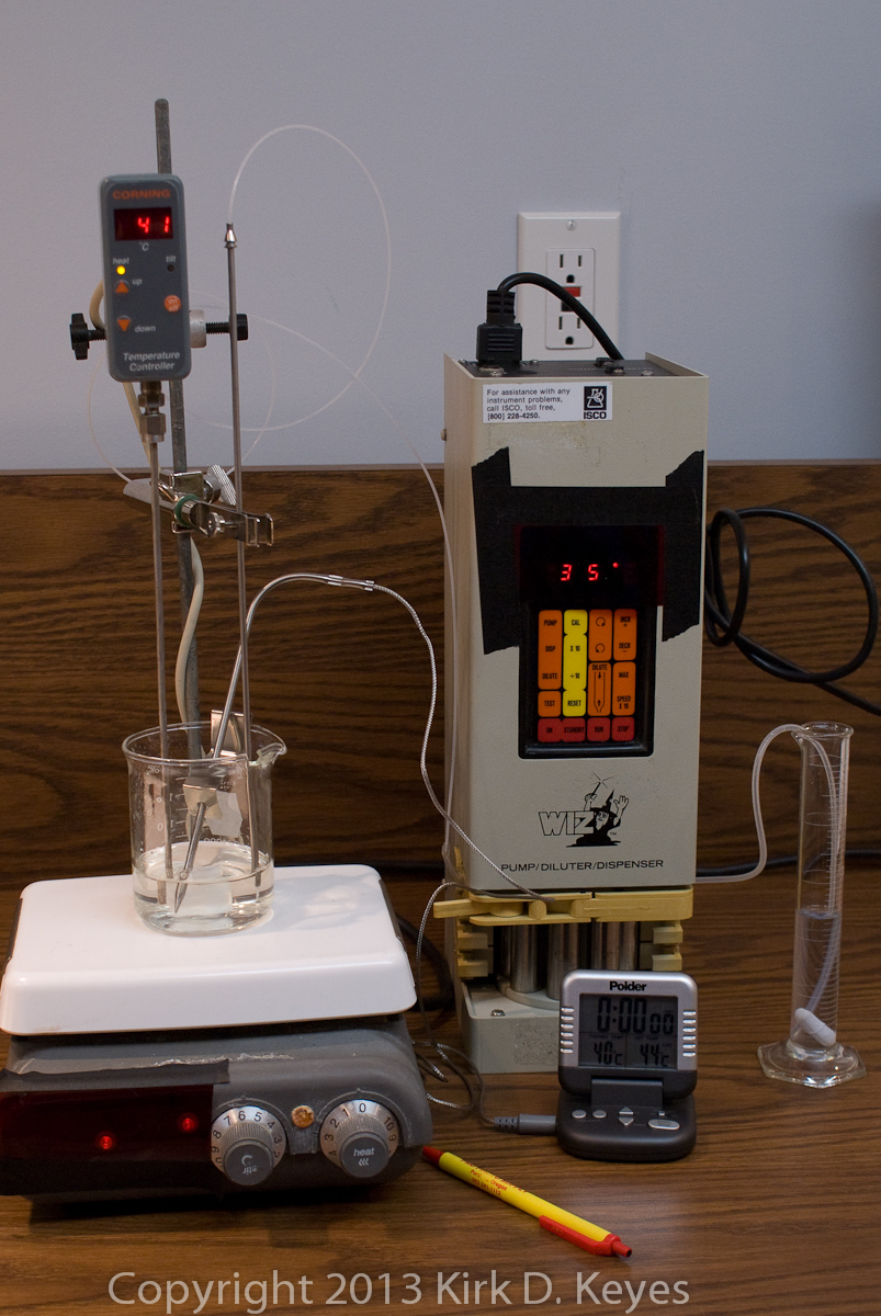

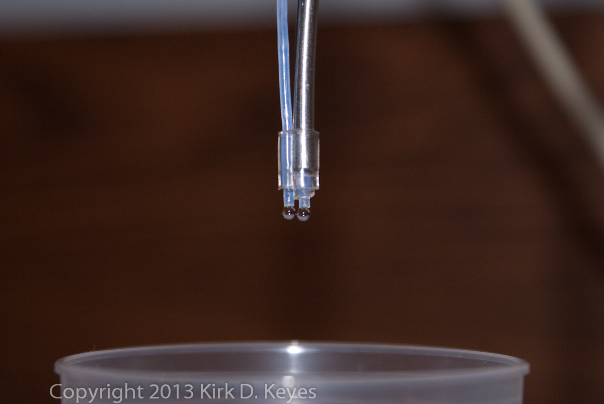

Here's some photos of the set-ups I had been working on a couple years ago:
First Photo -
This set-up for a single channel pump. The stirplate has a built-in heater, and there is a temp controller (reading 41C mounted onto a ring stand that attaches to the back of the hot plate. Also attached to the ring stand, is a clamp that hold a stainless tube that I have a thinner teflon tube inserted through and then the bottom end goes into the solution in the beaker.
That teflon tube is connected to a silicone peristaltic pump tube by merely inserting the teflon tube into the silicone pump tube. The other end of the silicone pump tube goes into the graduated cylinder which is holding the silver nitrate solution.
The 3rd thing in the beaker is a kitchen temp meter (the one with the right-angel bend at the top) and you can see it reads 40C on its display.
I use a large, X-shaped, teflon-coated stirbar to get as much turbulance and mixing as posible.

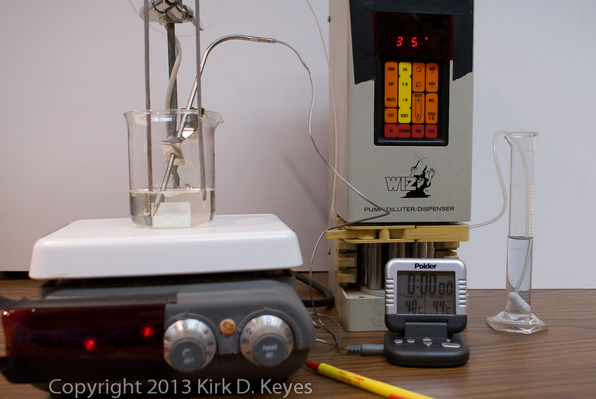

Second photo -
Here's a close-up of the beaker and pump. You can see the end of the teflon tube that goes through the stainless tube. The stainless tube is just to hold the thin trflon tube. (I think the teflon is 24 or 28 ga. I have some that goes down to 36 ga. but I never tried it.) Since the teflon tube that thin is not stiff at all, it needed something for support. I had the stainless tube sitting around, so I used that. Otherwise, I would have taken some glass tubing and used it. I preferred the stainless as I didn't have to worry about breaking it!
You can see the teflon coming down from the end of the stainless tube (off frame to the top) and into the polyvinylchloride peristaltic pump tube, which is a larger diameter. The little teflon tube is just butt-connected to the larger pump tubing merely by pressing it into the pump tube. If the difference in size between the two tubes is too great to do this, an intermediate size of pump tube can be used to go between the bigger and smaller tubes. No fittings are required using this technique.
You can see the little lever on the pump platten that is used to apply pressure to the tube to firmly bring it into contact with the pump rollers. This pump has 8 rollers, which will give a smoother flow than a pump that uses say 2 rollers.
Below - The tip of the dual solution nozzle. The tubing is 24 or 28 ga teflon tubing. One of the tubes is inserted into a long stainless tube for rigidity, the second teflon tube is strung on the outside of the stainless tube. They are held in place with short sections of PVC tubing, a smaller one to keep the teflon tube that's inside the stainless from pulling up into the stainless tube, and a larger one around the stainless tube and the second teflon tube.
Note that the teflon tubes have very small opening. I have them mounted so that they are as close to each other as I can get them. They are also open perpendicular to the flow of the liquid past them to get the liquid to shear off the tip of the nozzles so the solutions get dispirsed into the make as quickly as possible.
Below - Peristaltic pump set-up with two pump channels bring used. One for silver nitrate, the other for halide. You can see there pump nozzle in the beaker and behind it is the temp probe for the stirring hotplate. The two channels are loaded into the peristaltic pump, the close one has the platten for the pump tube tightened down so the liquid would flow, and back one has the platten loose to the pump is not flowing in that channel.
Note the hemostat is being used to pinch the back pump tube shut so it does not siphon liquid out of the beaker! To put the back pump into operation, all that needs to be done is flip the plastic lever on the platten down and to the left to tighten the platten against the pump tube and release the hemostat.

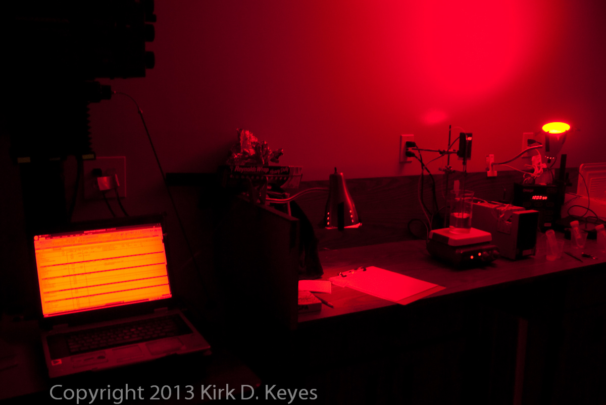

Below - The full setup in the darkroom. Red LED lights with rubylith over them just because... Laptop with rubylith of the screen - spreadsheet with all calcs and times for the make pulled up so it can bee seen and consulted during the run (and to play music - I was in there for hours...) Clipboard to make notes and record timing/addition times. Stirplate with temp controller, peristaltic pump, reagents prepped in plastic cups, darkroom timer running in 24 hr clock mode so I could easily see and record times.

PE - Well I came up with the nozzle config based on our discussions, so I'm glad it is close to what you were telling me.
I forgot to mention that with the pump running at about a 1 ml/minute, it will squirt a pretty steady stream of liquid out the tip of the nozzle and across the lab bench due to the small inside diameter of the teflon tubing! Doing that is actually a great way to see how constant the pump pressure is.
Also, I bought a lot of tubing (both teflon/ptfe and stainless) from smallparts.com. I see they are part of Amazon now...
