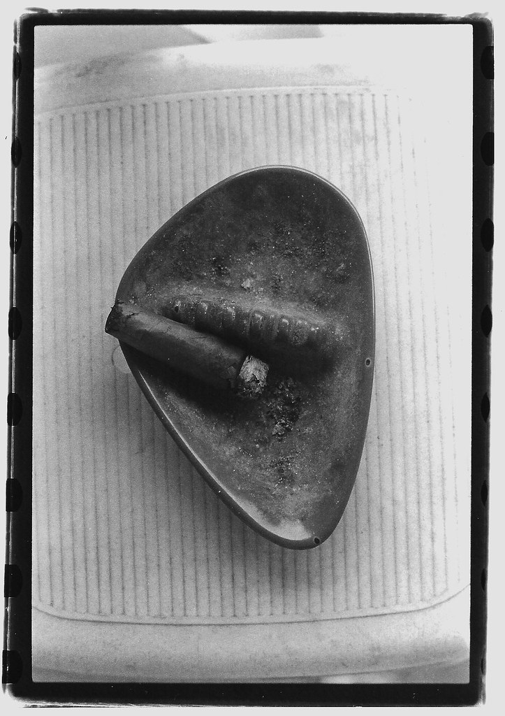

Have a Cigar by Nokton48, on Flickr
Minolta SRT101 85mm F1.7 MC Rokkor Eastman XX Legacy Mic-X
Omega DII 80mm F4 Rodagon Aristo 5x7 RC Multigrade Dev
