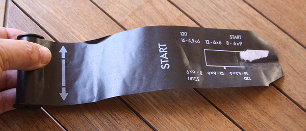

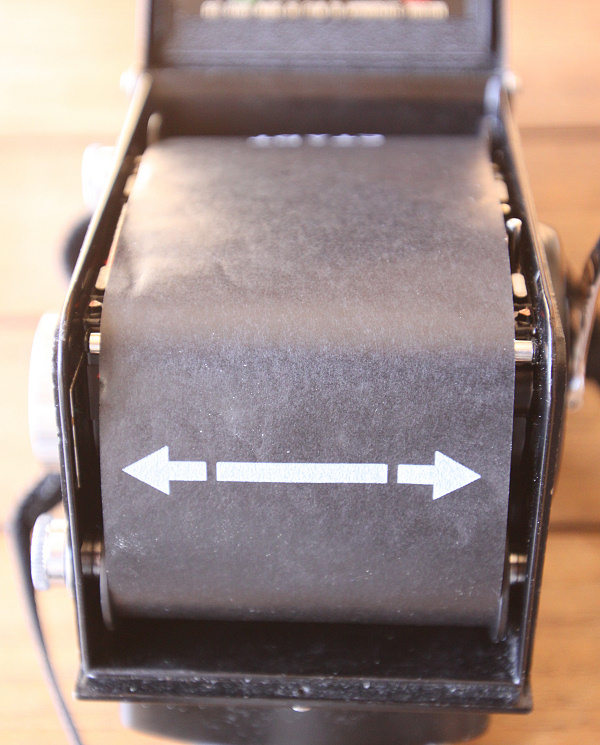

There's a line/arrow on the film that needs lining up with a a mark in the body, on my Yashicamat the camera's mark is about an inch above the film reel 1/2" before the film turns 90° across the film gate, there should be an instruction manual for your Microcord available on the MPP site.
All 120 film has the start marks, about 6" into the film, so it sounds like you've wound on too far before closing the film back/
Images to follow, their just processing :D

Here you go this is the Yashicamat, I've just loaded it, my Rolleiflex is almost the same.
Hope that helps.
Ian

Should be noted that you are using 120 film and therefore using the green arrows on the bottom of the camera, not the red arrows on the back which I assume are for 220 film.

Very true Greg, there won't be more than 1 arrow on a Microcord as MPP ceased production of them around 1960 well before 220 film was introduced (1965). The Red 220 marker on the Yashicamat 124 is actually round the bend of the film path on the back as you noted.
Ian
