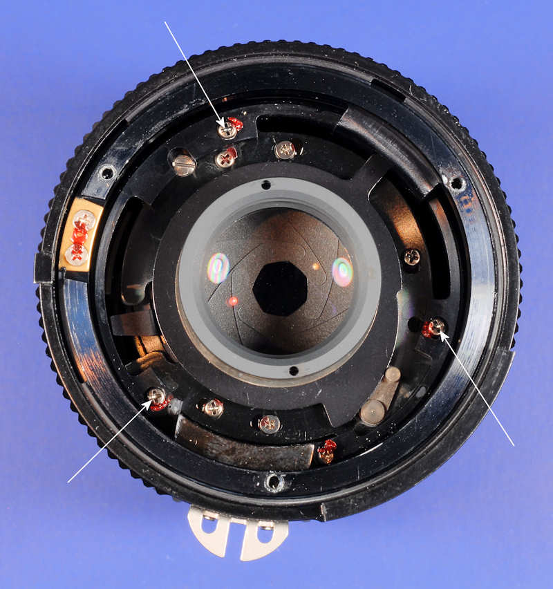

This photo is linked to the extremely helpful site at http://conradhoffman.com/MicroNikkor55.html
These three screws are in oblong holes and the slotted screw at about 11:00 is eccentric for adjusting the relationship between the inner guts and the outer barrel.
In mine, you can see where the screws were originally placed by the wear around the hole, and they were originally all the way to one side. Somebody had it apart and they came out of adjustment a little and were closer to the middle. When they are all the way to the wrong end of the hole, I can't even open the aperture all the way with the ring.
When I adjust it back so that they are in their original position, the effect I described is still apparent, but there is only a hair of aperture visible.

That's what I was expecting, but it was fine. The dark coating (bluing? anodizing?) was not worn through on anything other than some superficial wear marks.
It looks like the lens was all the way at one end of the spec since the adjustment was maxed out, and it drifted with a cleaning.
