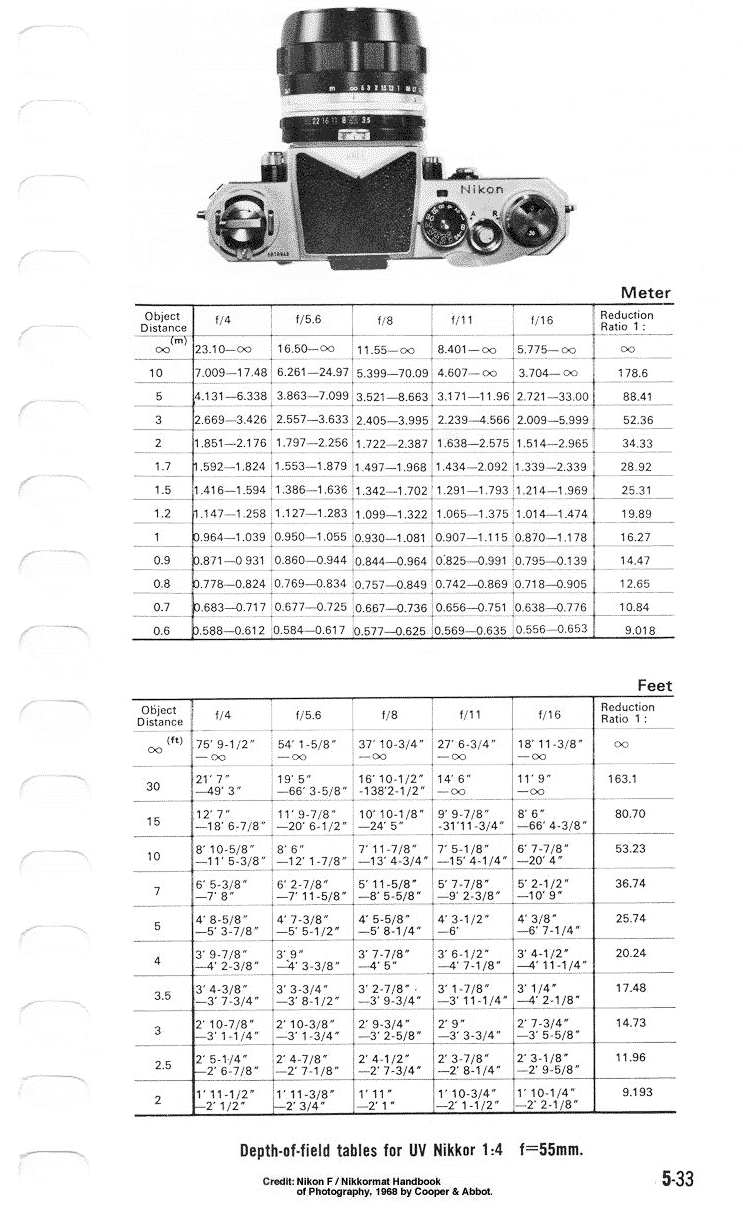

I think this DOF chart is similar to the one for your lens. The markings on the lens are a rough guide. The table has specifics for the larger apertures.

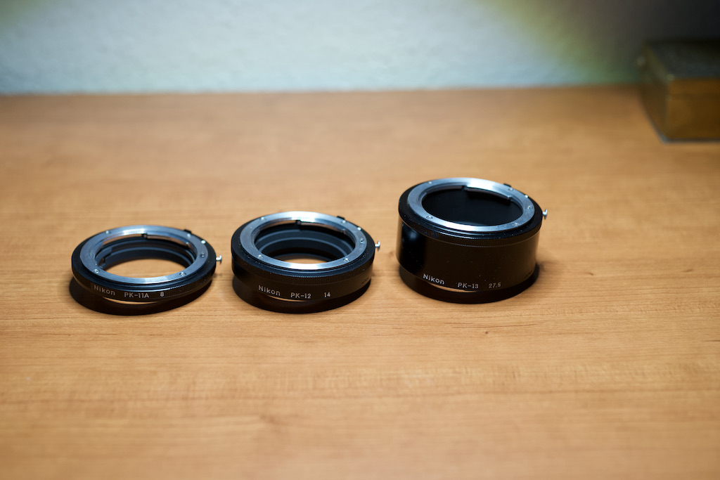

PK extension rings: PK-11A=8mm, PK-12=14mm & PK-13=27.5mm. The PK13 is used for a 1 to1 ratio with the 55 Micro-Nikkor.
OH thank you..lol, I"ll have to get my good reading glasses out for this.
So, is there no way with the markings on the lens itself to set things, so that you might not have to carry the charts and try to read them while out and about on a stroll?
Again, thanks for this, good info to have and I'll set some to memory, but I gotta think there is some way to do it on the fly with the lens markings?

That part is all like any other Nikon manual focus lens - most of them have these color-coded DOF markings. The extra orange numbers and the PK numbers are the macro reproduction ratios with and without a PK 27.5mm extension tube that allows you to focus to 1:1.
