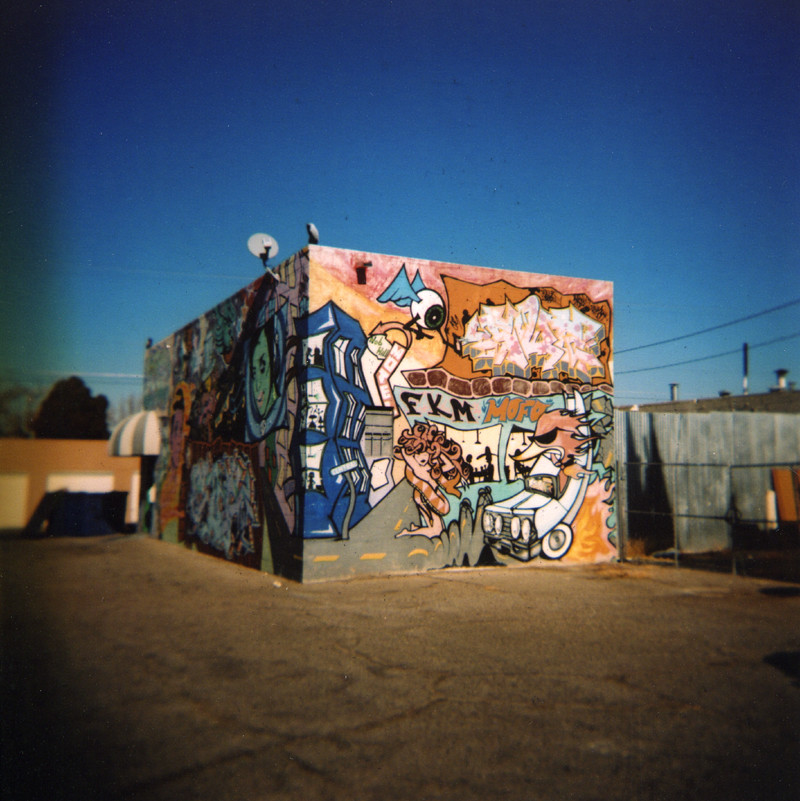

Here's an example from my recently acquired Holga 120GFN, this one using a glass lens but still exhibiting that classic off-axis vignetting. This is a scan of a mini-lab print, spots of dust are from my scanner.
~Joe
Garage001a by jvcabacus, on Flickr
