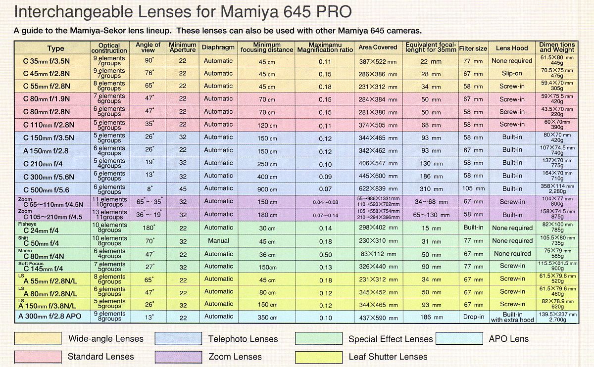

Glad I could help. Looks like you bought it. There's also the 80mm F/2.8 N/L and 150mm F/3.8 N/L lenses with leaf shutters for the Mamiya 645 cameras (in case the finances get better). See attached pics.
Enjoy the new lens!
