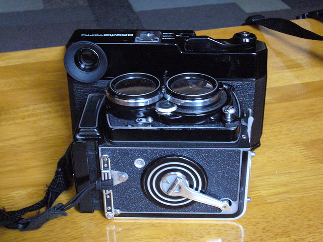

Here's a Rolleiflex 2.8C next to a Fuji GS690 (the 670 is the same body, just different mask and frame spacing). The Fuji lens can't be seen here but it projects forward a good distance-
If you've been shooting 4x5 and 8x10, I'd recommend getting the Fuji. Unless you've been cropping your large format to squares all these years. Fuji also made a 680 model.
