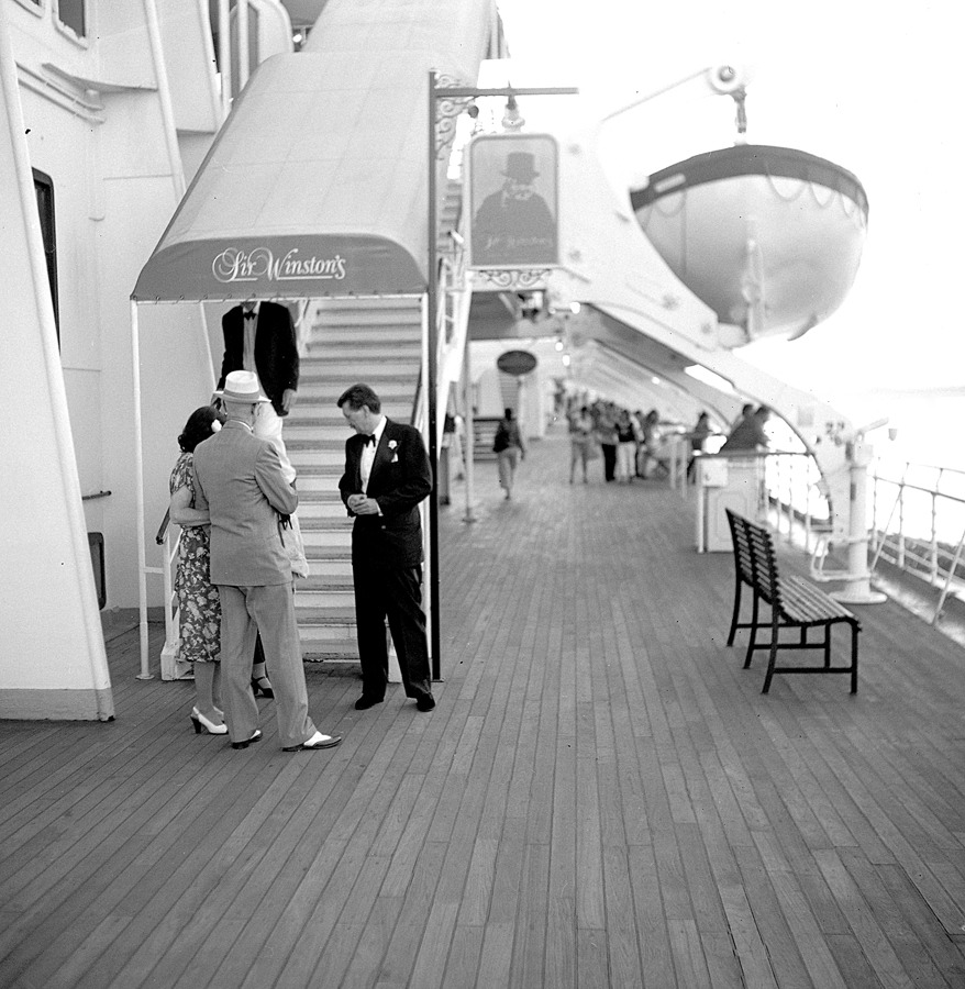

I picked up and old late 1940's/early 1950's Mamiya 6 folder a few years back for $40.00 that I just had CLAd'. I took this camera on a recent trip to California and was astonished on the quality of pictures it takes. Mine has the 75mm F3.5 Olympus Zuiko lens. The attached is a shot taken from the deck of the Queen Mary. Ilford Delta 100 in Rodinal 1+50, F4.0 at 1/50th (or so) hand held.
Jim Bielecki
