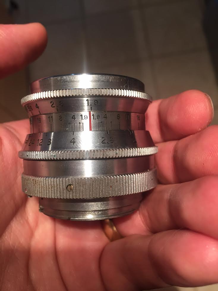

I have a pre-war Primoplan 1.9 5.8 I'd like to get CLA'd. From what I understand jenstarct from eBay, who was well recommended, has retired. Is there anyone else who is well regarded and can service Primoplan lenses?

I think a general CLA, the focus and aperture rings are stiff from disuse and from what I understand the oil in these lenses dries up over time. It's quite clean otherwise as it's been kept in a case attached to a camera.

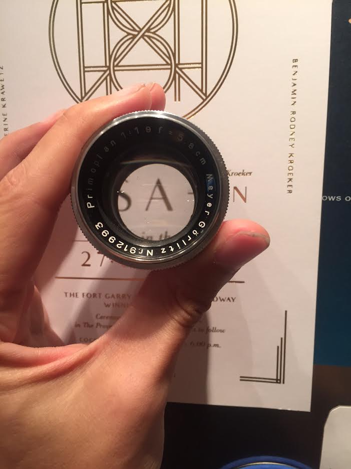

In terms of optics the lens seems to be free of haze. Also, there is no V designation on the front so possibly lacking the problematic V coating? At least that's the impression I get from reading around about this version.
I do appreciate the instructions but this version also lacks the grub screw on the focusing ring. Normally I'd be happy to take something apart but the prewar version, at least going by the serial number which is in the 912000's, seems much scarcer than the red V version and I'd rather have someone who knows what they're doing take things apart. Overall the lens seems to be in quite nice shape and I'd hate to muck it up.
