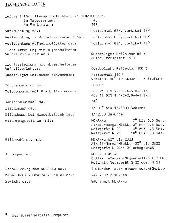

ED, I used the link you provided, created an account, got the download all in english to this point then I opened the manual and found editing locked and the assumed german language.
I used their provided trouble link only to get a transaction completed reply.
There are some PITA workarounds I'm exploring.
I told them to close my account. I will not use them again.

Here's the workaround in Windows for PDF files that have text editing blocked/disabled.
Check that you have Microsoft XPS Document Writer installed on your computer. (programs and features>turn windows features on or off>click XPS services)
Open the PDF file in a PDF program such as Adobe Reader
Print>XPS document printer
Print the resulting document on paper
Scan the printed pages with an OCR program such as Abbey Fine Reader (ships with Epson software)
Convert (read) and save the scanned file to a rich text or txt doucment.
The text document(s) can now be translated with Google translator or similar program.
correction: the file on the download page is listed as English but the technical text is still in German.
bdial
Jan 2, 2005
7,507
North East U.S.
Sounds like the PDF is built with encapsulated images from being scanned.
You could probably shortcut that process with an image conversion utility. You would have it convert the PDF to TIFF then run the tiffs through the OCR software (assuming the bundled OCR software will read from a file rather than the scanner). ImageMagick is one I've worked with that is free and works pretty well.
You can also export single pages of image PDF's with Photoshop and save them in a TIFF, but that would be pretty tedious for a whole manual. Plus, it can be a little goofy with bitonal tiff images.
