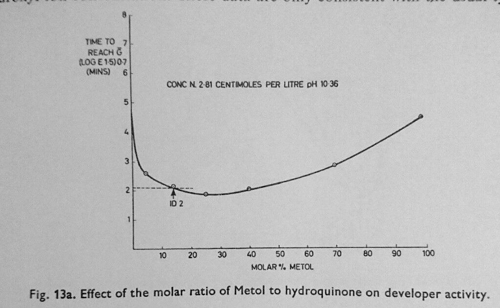

Metol and hydroquinone are a super-additive combination. Therefor the rate of development is enhanced. The is important for a low pH MQ developer like D-76 to avoid long development times. There is an optimum ratio for the two developing agents. For an MQ developer this is approximately 1 part metol to 6 parts hydroquinone. This is discussed in Mason* which contains a 'U' shaped graph of development time vs the MQ ratio. The low point occurs at 1:6 w/w.
* While not as up to date as Haist's magnum opus LFA Mason Photographic Processing Chemistry is still a very useful book. It should be on the library shelf of anyone interested in photographic chemistry.

pdeeh
Jun 8, 2012
4,770
UK
that is straight from Mason, 2nd Ed, p.119
He has a similar graph on p.120 for Metol/Phenidone.
I learned a huge amount from that book, even thought I could understand only about 20% of it.
For anyone with a chemistry degree, no problem.

The darkroom Cookbook covers super-additivity. The relevant text is at https://books.google.com/books?id=B...nepage&q=hydroquinone superadditivity&f=false (Google, if the link survives).
On its own hydroquinone is pretty aggressive, and metol is slow. Phenidone is not much better, but the discussion is MQ :cool: Thankfully we do have a range of chemicals that let us choose what happens, and how fast it happens. If we only had one developing agent, think of all the empty space on APUG...

Glad you posted the graph. The one in Mason is very small and I believe gives a simple w/w ratio.
While we have you on the line, Gerald, I recall crediting you/reading in a post you made some similar information about optimal sodium sulfite content in M-Q developers - a value of 70 g/l. I believe you indicated deviation from this value in either direction would compromise the effectiveness of the developer. I could not revive the post. True, or has my memory gone to hell?!
I fully concur here, although, to me at least, 'synergism' becomes a more meaningful description than the technically more correct 'super-additive' parlance. I guess what I was seeking with this post is permission to call HQ not a 'developer' but, instead, a facilitator of metol. That, to me at least, seems more appropriate a title for this chemical.
The darkroom Cookbook covers super-additivity. The relevant text is at https://books.google.com/books?id=Ba_OCwAAQBAJ&pg=PA22&lpg=PA22&dq=hydroquinone+superadditivity&source=bl&ots=wOaJWcilP9&sig=U6of-KWA7CseoOhBMH_VlcwZbBI&hl=en&sa=X&ved=0ahUKEwjBzJei5eDRAhUI5GMKHSmDBhYQ6AEIMDAE#v=onepage&q=hydroquinone superadditivity&f=false (Google, if the link survives).
Grahamp, I believe, is incorrect here: over and over the literature states that it is metol which is fast acting (though yielding lower contrast) and it is hydroquinone which is slower to act (albeit, yields higher contrast). - David Lyga

David - Depends a lot on the conditions, mainly alkalinity. In the developers I use, metol on its own in moderately alkaline conditions takes its time producing density, while hydroquinone in strong alkali is quick and contrasty. But fast and slow are sloppy terms (and yes, I used them!). By and large, I would not choose a pure hydroquinone developer for general purpose photography. I might use either metol or M-Q (P-Q).
I am far from an expert on photochemistry (I'll leave that to Gerald, Ian, and several others).
