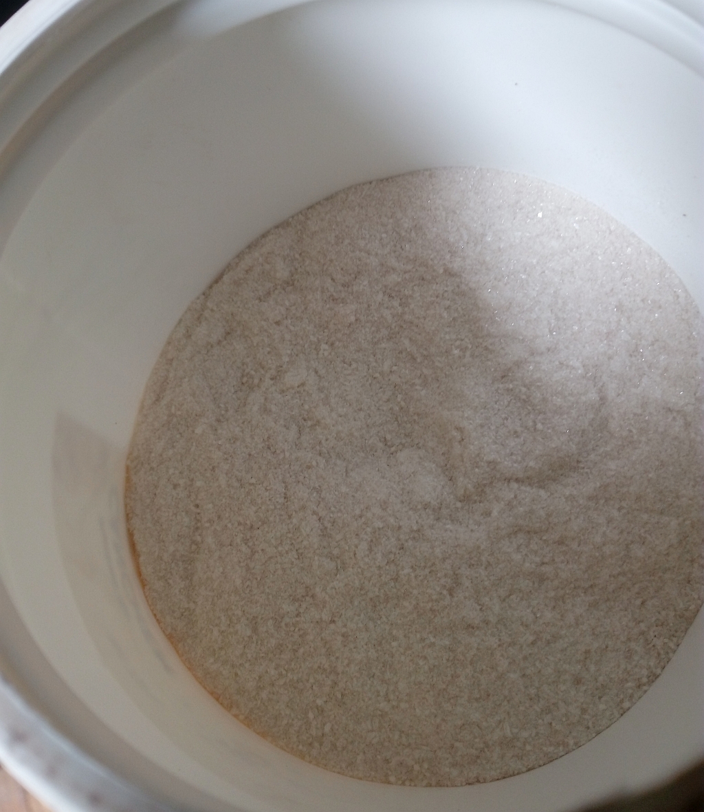

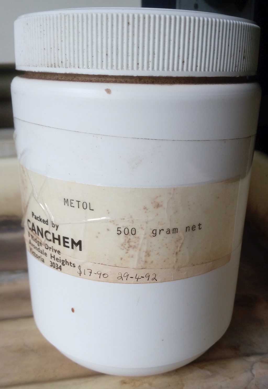

I have Metol and Phenidone in plastic containers that were all purchased in 1992, however the containers were all assembled from bulk stock in 1982, when I believe that particular business was started. As these were the biggest containers, and therefore the most expensive, they were never sold. When the owner developed some serious health issues, he started moving stock with what was effectively a fire sale. I purchased 4 x 500g containers of Metol, this is the last one I have left. The Phenidone I bought, which was 2Kg, still has a tad left.
Storage has always been in my darkroom side room, with prevailing temperatures from around 1ºC in winter through to 47ºC in summer. They all work.
Attached are pictures of the Metol container, with the second one being that of the innards, which look more tan coloured than show up on this mobile phone picture.
Mick.
