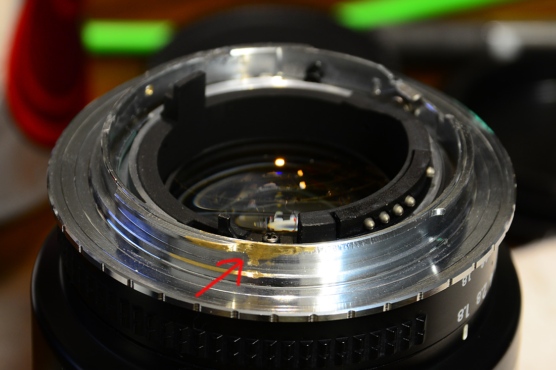

I fixed it. I grinded about 3mm of the bayonet mount at the 10 o clock position and now it doesn't push on the little switch. Now, back to the f stop. With the adapter and Nikon lens or no lens if you select a different f stop in manual mode your meter reading changes. In AV changing the f stop changes the shutter speed. But the amount of light coming in stays the same . Doing a quick test setting it to f/1.0 gives about the same reading as other cameras. Is that how it should be?

Here's an image showing what needed to be grinded with the Dremel tool.

Some adapters will push that switch in the EOS mount which then tells the camera that an EOS lens is fitted. If then the electronics can't figure out what is going on (which they won't as you don't have an EOS lens on) the camera locks up. This behaviour I think is on all film cameras up to the 1D or something like that, digital cameras newer than the 1D have no such switch.
So you either buy an adapter that does not trip the switch OR you buy an adapter that trips the switch and then you add one of those glue-on electronic contact patches.
