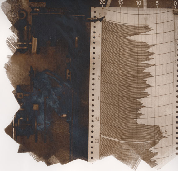

Lately, I have tried to sepia tone a number of liquid emulsion prints (Rollie Black Magic VC). The toner I used is Amaloco T-10 Sepiton, a dutch product of which I am not to sure others know about or if it's sold outside the Netherlands. Unfortunately, the exact contents of this toner is not mentioned on the package. However, it is a two bath system, and it does mention ferricyanide and sodiumhydroxide for the first and second bath respectively. Based on some research I've done on the internet, I know suspect, or almost know for sure, that it is a thiourea based sepia toner, since the other two types of sepia toner either are not odourless and single bath (sodium sulphide based sepia toners), or can not be combined with any alkaline solution like the sodium hydroxide in the second bath, since that would destroy it (metal ferricyanide toners - copper based for sepia). So it's most likely a thiourea based toner.
Anyway, the problem I've seen turning up is that metalic / silvery stains appear in the *most dense/dark parts* of the sepia toned prints, so those parts of the original photo that had the deepest blacks. Actually, although I'm pretty sure I've stayed below the stated capacity of the toner (in terms of square meters), I am suspecting I may simply have exhausted the toning bath (the second sodium hydroxide / thiourea bath). Toning times were already rising, and I may simply not have fully toned all bleached silver. Many of my prints are also very dark, so requiring a lot of the toning bath...
Is this indeed possible??? Or am I talking complete nonsense here? Does untoned, but bleached silver, turn into a visible metalic layer on sepia toned images when the toning bath is exhausted? And if not, does anyone know the real cause of these metalic / silvery stains?

Reading through all the stuff, and again having a close look at my stained pictures, I now have a crazy idea I would like your opinion about. To recap my observations (and see the screenshot I now included!):
- Staining is almost exclusively limited to the highest density / black areas of the original print
- Staining starts when the bath is almost exhausted, with long toning times in the second toning bath
- I have now also been able to confirm Bob's observation: Initially, I thought the stains appeared *after* having left the toning bath (thiourea / natriumhydroxide), but this isn't true. As Bob observed, I've now seen in a used toning bath the *temporary* formation of these stains, that disappeared with some more agitation of the bath.
- As another new observation, the stains do not only appear more reflective / metalic, but might be "bleu-ish" as well.

Attachement showing stains:

Prussian Blue is not a likely cause for this Marco and in any case, in the photographic media, it is notoriously unstable in the presence of alkali. NaOH is a strong alkali and quickly sees off the colour of iron blue in a silver print.
Similarly, Selenium is not likely to be involved in this IMO, for the good reasons you have mentioned and I think both of these are 'red herrings'.
From what you said in your 1st post you are not sure of the ingredients of this toner. From your description, it seems likely that it is a thiourea toner, but I have used thiourea toners regularly and frequently for many years and don't recall getting blue metallic shadows in any of them - unless combined with another agent such as a metal ferrocyanide, so it would definitely be worth contacting the manufacturers, explaining your problem and asking if they can help with an explanation, or at least provide you with an ingredient list or MSDS data sheet. This just might shed some light on your problem.
this may possibly not be what you want to hear, I know, but it's usually best to start with first principles and basic data ;-)

Just to confuse things further: the stains I had were only silvery rather than having any blue sheen and, if not too extensive, could sometimes be "rubbed out" with a gloved finger in the toner. It only happened a few times so I never really tried to investigate.
I suspect we had different events (though they might be chemically related) - unfortunately I lack the chemistry to be of any use in considering possible causes...
Cheers, Bob.
Bob: I agree with you that the stains are far more silvery than "bleu-ish", so I do think we witnessed the same effect. And I also confirmed your "rubbing out" effect (in my case by agitating the tray a little bit more). The stains are however, only removable, when still in aqueous environment of the initial toning...
