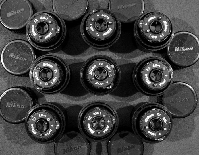

For rolling my own 35mm film cartridges, I prefer using the metal felt-less Nikon AM-1 cassettes for use in the Nikon F2 35mm SLR.
https://flic.kr/p/rQ8zBM
Is there anything about these that makes them only work with the F2? I have and enjoy an F2 but would want to be able to use the cassettes in my other cameras too.
As to the original question, I've always used metal. I have certainly noticed that the new metal cassettes are of much lower quality than the ones I used to get "back in the day". I've never had a new Kalt cassette pop open on me, but they feel cheap and make me feel like I need to be really careful with them.
There are Nikon cassettes that fit only the F and Nikon cassettes that fit only the F2, and fit no other cameras. Leica used to have them, too, a long time ago.
Correct
In addition to the F and F2 cassettes, Nikon also made a cassette for its rangefinder cameras.
