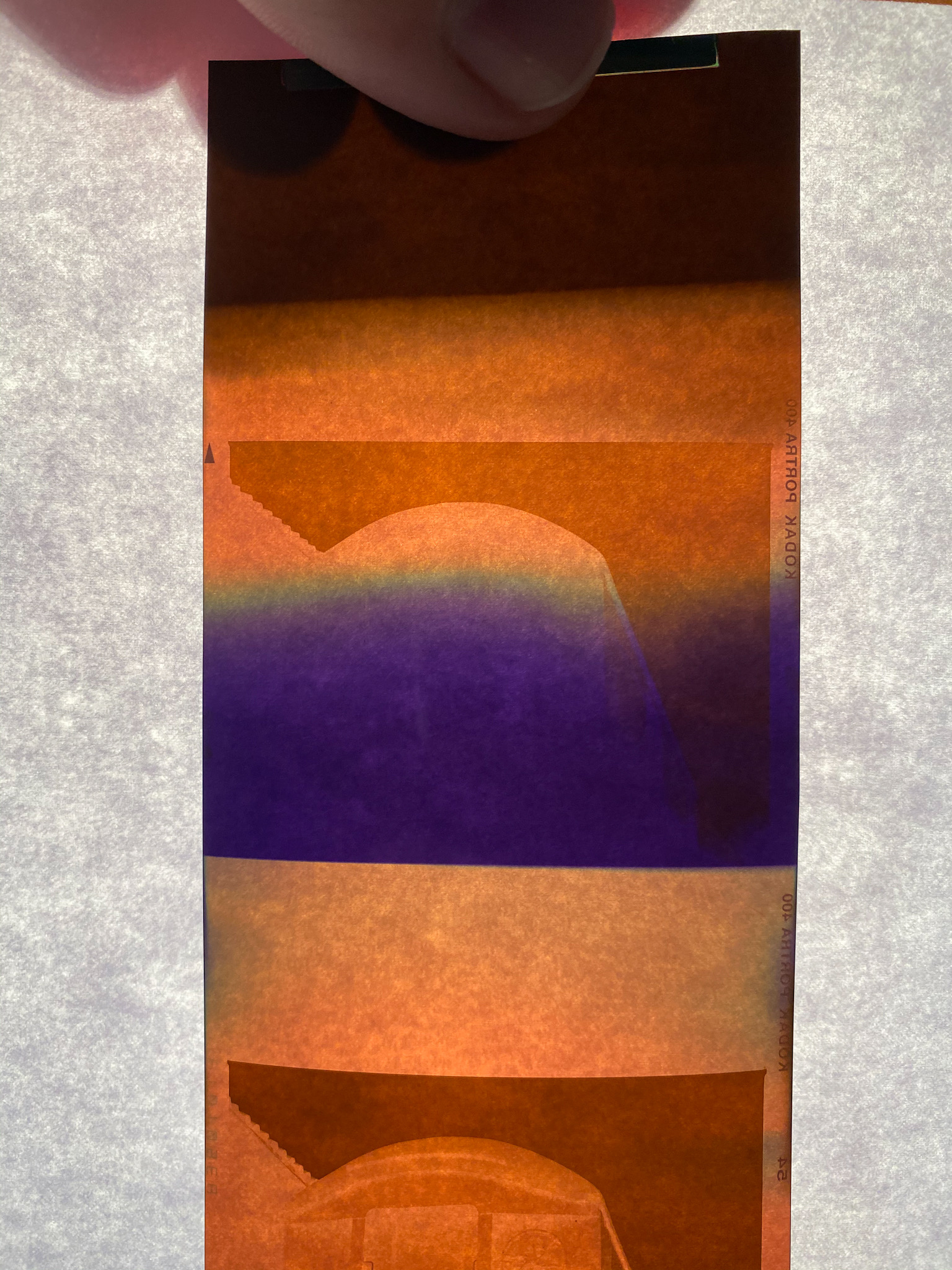

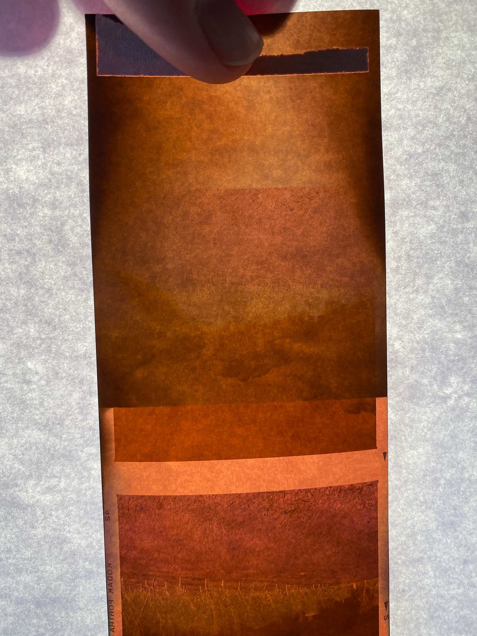

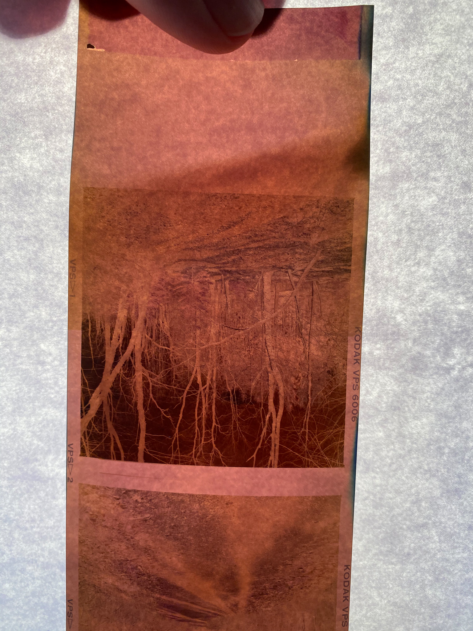

So I just got two rolls of 120 back from the lab, first ones I've shot with the camera so who knows perhaps I did something wrong. The first frame of both is partially exposed to light and the last frame has some crazy blue staining on it.
Camera is a Hassy 500c. Film was loaded and unloaded in a dim room and only spooled to just before the arrow so I don't think I would have exposed it to light in loading. The blue... I seriously have no clue what could have caused that.
I've attached images, sorry about the background but I don't have a Lightbox. Any thoughts would be greatly appreciated so I know if I need to change something about what I'm doing or to stop using my local lab and send my film out. Or bite the bullet and dev myself, it's the temps and keeping them right that keeps me away.

Hi TJ, welcome to Photrio. :smile:
It looks like an in-camera light leak so I wouldn't go blaming the lab just yet. I'd check the back and darkslide; or try using another back if you have one. Light leaks can be tricky to pin down; if this only occurs on the first frame of every roll, I'd check around the feed and take-up chambers. You might have a light leak that is blocked by the bulk of film on the spool, or the film could be moving out of the light leak as the spool gets used up.

I thought about a leak, but I've never had one that evenly distributed itself across the film like these two things. Both rolls have about the same amount of light contamination on the first frame (White light turning the film dark) that just cuts in a perfect line partway through frame 1. And about the same amount of the blue on the last frame, the blue is the one that confuses me as that should indicate that both rolls somehow were exposed to a colored light source, right? The neg is extremely vivid blue in person.
The frame one issue ends at different spots from the top of the film on each roll, but the blue is in the exact same place on both. Just held them up to each other and it overlays perfectly.
As for trying another back, I'll have to dig out my 645 back and try that as my other 6x6 needs to go in the shop. Probably try a roll of color in the Bronica as well since I know that doesn't have leaks. (Only shot B&W so my first MF color developing experience with this lab, but their 35mm color hasn't had any major issues other than their horrible scans before I got my own scanner).

I think a light leak across the entire frame indicates a shutter issue, sticky auxiliary shutter? Whereas a light trap issue would only partially expose frame and be directional.
Tested the aux as soon as I got the camera and it doesn't seem to have any issues. Should also see evidence of that on the middle frames as well. It's just the start of the film to part way in to the first frame at a different distance on each roll and then the vibrant blue on frame 12 in the exact same spot on each roll.
Like nothing I've ever run into or as far as that color goes, even heard of previously.

I thought about a leak, but I've never had one that evenly distributed itself across the film like these two things. Both rolls have about the same amount of light contamination on the first frame (White light turning the film dark). And about the same amount of the blue on the last frame, the blue is the one that confuses me as that should indicate that both rolls somehow were exposed to a colored light source, right?
Not necessarily; if only a small amount of leaked light hits the film, the fogged area appears red-ish in colour prints, the complementary colour of which is cyan (blue-green) on the negative. I've attached an example of this effect below on 35mm film. It *is* possible the lab messed up but that's quite unusual, and the regularity of the fogging across multiple frames on multiple films is more suggestive to me of an in-camera leak.

If the light leak on both rolls is pretty much identical, I'd be 99% discounting the lab and looking at a possible leak on the film-back or the camera. The lab would be pretty hard-pressed to expose a couple of rolls almost identically.
What is most confusing to me though, is that you have described fogging to only the first and final frame - which is weird, as I'd expect a drastic leak to affect the middle frames as well. Only thing I can possibly think of is that the darkslide may not have been slid all the way in at the beginning of the roll (when loading) nor slid all the way in after exposing that last frame and then the back was taken off?
ie: It was slid in just enough to not show the "curve" of the darkslide, but not enough to fully seal the back, thus letting in a sliver of light. Once on the camera (if the back wasn't removed again until finished shooting) it was "light-tight" and exposing away was fine, but once it was removed, it leaked light through an "imperfect" seal.

Kevs,
Having never shot much color before this year, that's good to know about the color of leaks, this is more sapphire blue but close enough I imagine. I'm used to B&W so was thinking in the mindset of "shouldn't it just be denser".
Thanks for the link, I'll check it out! I was actually planning on getting a CLA on the body, lenses and backs over the summer as one lens is a bit sticky at longer shutter speeds and I have no idea when it was last done for any of it.
Oz,
Yeah, beginning of the strip and the end. The start has the area of uniform darkening, could be my loading procedure but I'm pretty sure I'm not pulling too much film before loading, and the line is kind of perfect which would be impressive if I did that too. The end has the blue, now if you put the two strips lined up end to end, the blue is in the exact to the mm same location, so I would have had to have the film loaded to the exact same to the MM place in order for a light leak to do that, right? I might have, but I was thinking something in the developing process might be messed up. Only shop left in the area, and sometimes I question exactly how professional things are run there. Like the 4 rolls I got back yesterday were just kind of tossed into a box with no protection and a few other things along the way. So I just kind of suspected it was a result of something they did.
The middle frames are all perfect, no random dark or color spots. I actually don't remove the back from the camera at any point in time since my 2nd back needs repaired and I'm waiting until things settle down to do that. Just pop out the side door, load up, shoot, wind all the way, pop out the side door and remove the film. I put some better images of the film in here, the more I look at it the more I notice bits on the sides that look more like light leaks as well, but still they don't go the entire roll, just where you see them in those pictures.

Looking at those, it's possible that it's a processing issue - but obviously difficult to be 100% sure. Maybe just ask for a non-exposed roll to be run through - if there's *any* fog, you'll know right away that it's not you. :wink:
The pattern of the fog makes a cause in the chemical part of the processing extremely unlikely. It could be a proble while loading the films into the development machine, but an in-camera or user-related cause is much more likely.

Do you know what type/make of processing machine the lab used to develop your film?
I can't see how a dip & dunk machine could cause such a light leak (IMO it is not a chemical problem).
If it was a leader card fed processor, then the film would be loaded (in a dark box/bag) into a dark film cassette and spliced to a leader card. If the dark film cassette wasn't snapped shut or the light trap faulty then it would cause a light leak.
The only other thing I can think of (with a processor like above) is that someone opened the film loading door on the machine while the film was extracted from the dark cassette. Again this shouldn't happen as the machine locks the door and even if the emergency release button was used, the machine would alarm. In theory, all this could happen but I have never seen it.

Those look like somewhat worse versions of the leaks I had in the (so far) one roll I've processed from my RB67, which I'm reliably informed are due to bad light seals in the film magazine, specifically the hinge. Leak runs across the full frame and rebate, with a sharp cutoff on one end and a soft fade on the other. It's light leaking into the takeup chamber, cut off by the bend the film makes coming from the gate around the roller to the takeup spool, and faded on the other end by the shadow of the roll itself.
The frame 1 leaks you show would have actually been produced after frame 1 was wound on, with frame 2 in the gate. You can test this by taping over the hinge (with black electrical tape or gaffer's tape) on your film magazine immediately after loading (film still at the arrows, before advancing to frame 1). This should completely eliminate this leak source (though you may have another producing the edge fogging). Assuming this fixes the problem, it's a simple job to get a foam kit for your film back from John Goodman (a member here, though I don't recall his user ID), clean out/up the old deteriorated foam, and install the new -- runs around an hour the first time you do it, might get it to as little as fifteen minutes for this kind of job if you do it enough (which you won't; once per magazine and it'll last many years).

If it was an in camera leak as opposed to the in the back then it would be only in the image area since the back masks off the non-image area. I don't think its the dark slide light seal because you would see more gradation from one side to the other. I don't have an empty back to look at right now so its hard to envision. I would still think a light leak between the insert and the insert holder would show gradation from one side to the other.
I'm leaning towards in error at the lab in processing. I'll even go so far as to say they use a leader card type machine where the film is placed in a clam shell type cassette and then taped to a leader card, two, side by side, and then placed into a loading bay in the machine. If the door on the loading bay wasn't shut completely then this would expose two rolls in very similar ways. If you do an image search for Noritsu leader card cassette you'll find pictures of the cards and cassettes I'm referring to. I can't find a photo of them in use, but imagine a small leader of film sticking out of the cassette and being taped to the leader card. you place this all in the machine and close the door. The machine then engages the card and pulls that through the processing tanks, dragging the film our of the cassettes. There should be interlocks to prevent you from opening the door while the film is still in the loading area and the machine should start pulling the machine through unless the door is completely closed but at this point all these machines are old enough that those safeties could be compromised. though if they have a dip and dunk machine all that speculation is pointless.. :smile:

The thing about a Hassy back is that the insert is on the side of the back, it doesn't open up like a clamshell like a Bronica. So if it were leaking I'd expect it to be stronger on one side of the image than the other. I'll try some tape around anything that could leak on my next roll and see what happens as that's a good way to rule out the back leaking.
As for the processing machine, I have no idea what type their using or how well maintained it is. I think my plan is to take the currently loaded roll, load the next and tape everything and then send those with a few others I have off to somewhere like the darkroom as their prices are fairly comparable to my local lab when getting dev only. I'll have samples loaded normally, taped and then samples from two different labs. If the normal rolls have issues, it's my camera or loading / unloading technique. If none of them have issues, it's the lab.
