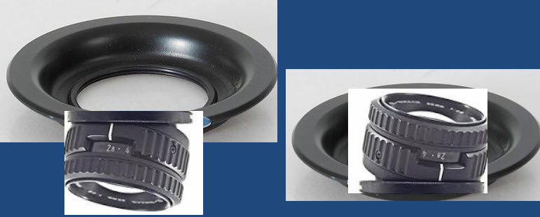

Once I had similar problem - and lens was mounted on the lens holder other way around. See picture below:

R.Gould & darkosaric, the lens mounting ring I have is flat, not domed like the one shown in darkosaric's photo.
