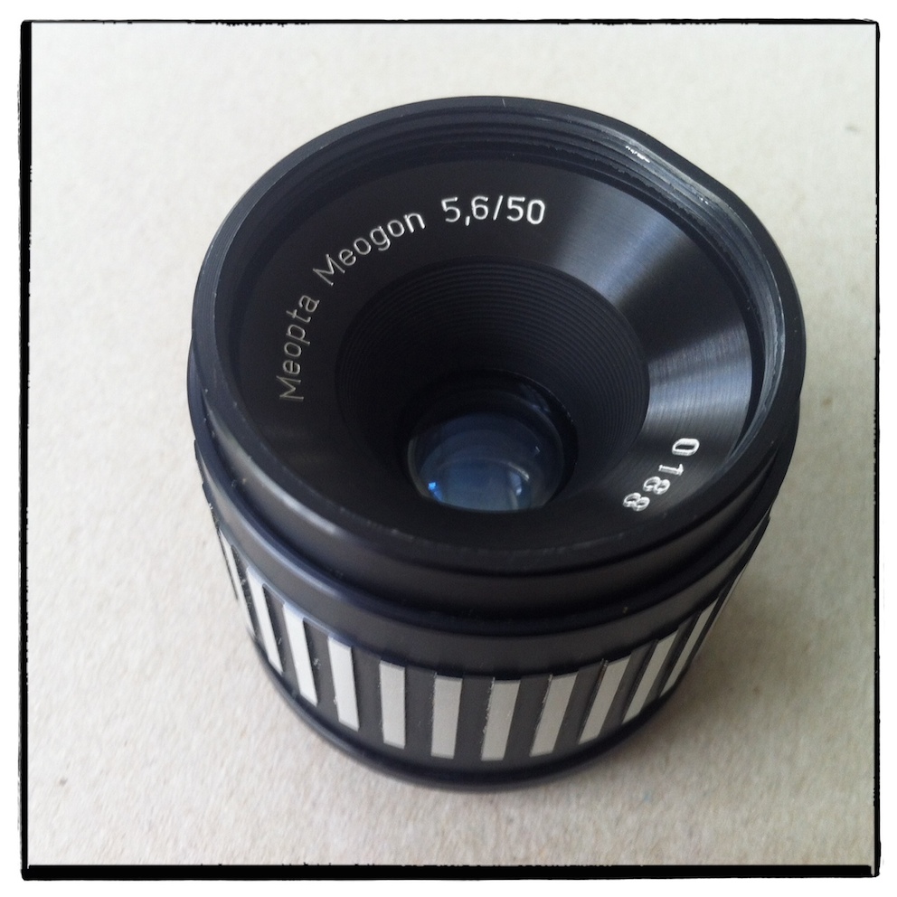

Meopta lenses are not quite satisfactory, they can be great! A Meogon is a first class lens and even a modest Anaret is fine unless to try to print posters.
I could not agree more with what you say. The Meogons 50/5.6 and 60/5.6 and 80/5.6 are in the same league as any 6 element quality enlarger lens. I have a Leitz Valoy II set up to do 16X20 and 20X24 and the Meogon 50 and 60mm are regular visitors. The zebra styled aperture rings make so much sense: easy to see and easy to turn. For sure these lenses are no less than the Focotar-2 50mm. I use a 150 watt opal lamp, hope your new enlarger can deal with that too.
