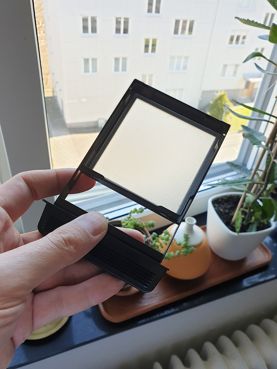

Hi! Just bought a new in box Meopta Opemus 5 purchased by the seller in DDR early 80s but never assembled and used. I set it up and have been doing some test prints, studied the manual (PDF online English version) but there's one thing I can't figure out.
In the bottom of the filter drawer is a coarse matte glass, should this always be used and filters stacked on top of it if needed? What is the function of this glass? Any Opemus owners out there who knows?
/Petter

I take it that you cannot focus the neg with this in place. If so it suggests to me that it was used to diffuse any neg into a uniform grey for the purposes of setting an exposure for the print that was designed to work well for negs that were an 18% grey when the tones were mixed
Just speculation on my part but it looks too textured to have any other use such as soft focus

It's placed just under the light source so not in the path of the projection, but I might have found the answer in the manual after reading it thoroughly again. It's apparently for diffusing the light if you want softer grain or if your negative has gradations you want to blur a bit.

Sorry I was not very precise, It is in the light path before the negative carrier, just below the lamp and before the condenser.

Heat shield? I have this in my Opemus 6. Never taken it away.

@Jojje , It's apparently for softening up grain, gonna remove it next time i print and see if I notice any difference in sharpness .
More accurately, a diffused light source will reduce contrast, including in particular the edge contrast - also known as acutance.
Acutance is the major component of what we subjectively observe as "sharpness".
By changing acutance, diffusion will change the appearance of fine details, including the appearance of grain.
Diffusion will also tend to suppress the appearance of dust and any markings on the film.

[QUOTE="MattKing, post: 2268429, member: 6437"[QUOTE a diffused light source will reduce contrast, including in particular QUOTE]
Right. The Opemus is a condensor enlarger. With the diffusion glass in place it mimics being a diffuser enlarger, so reducing overall contrast. It's a clever trick from Opemus to help you print negatives witk a tick too much contrast

Thank you @MattKing and @hadeer for the more in depth explanations, will be interesting to see how much difference it makes using the same originals.
I am certainly interested in how much difference the filter makes Some people say that all things being equal it is at least half a grade so if grade 2 is right in a condenser then it needs at least grade 2.5 in a diffuser enlarger
